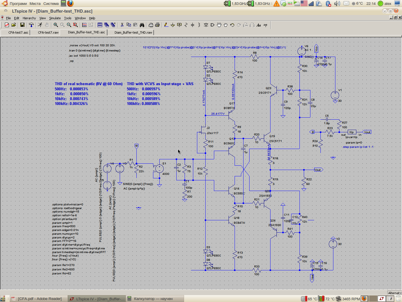

1. THD of the Diamond Buffer itself (without NFB) with 8V/1kHz input signal and 60 Ohm load is ~ 0.2%
2. If we want to evaluate how buffer's THD vary with applied NFB loop gain we have to isolate it from the rest of schematic.
I did that and the results are shown on the picture:
Input stage and VAS are substituted with ideal VCVS. Since the real schematic has OLG of aprox. 70dB, VCVS's amplification is set to 4000.
On the picture you can see calculated THDs with VCVS vs. these of the full schematic. It's obvious that they are very close (with exception of 100kHz measurements which is pretty normal). That's why I can say that it's almost all we can squeeze from schematic with 70dB OLG.
3. If we want to lower THDs, we must rise the OLG and hence the loop gain level. Do we really want this? I'm not sure. You can also ask John Curl about his opinion 🙂.
4. About slew rate - I gave some values in the pictures above: 374V/us at 38.2V/100kHz output signal.
Regards
Alex

That is looking better. No need to add more OLG as long as you are well below -100 ... which you are. SR looks very good also.

Well, real schematic's THDs can be lowered even more by lowering the values of NFB resistors R23, R24 from 2.1k/300 Ohm to 620 and 142 Ohm respectively but amplifier will become a little bit unstable. So one can trade THD for stability.
