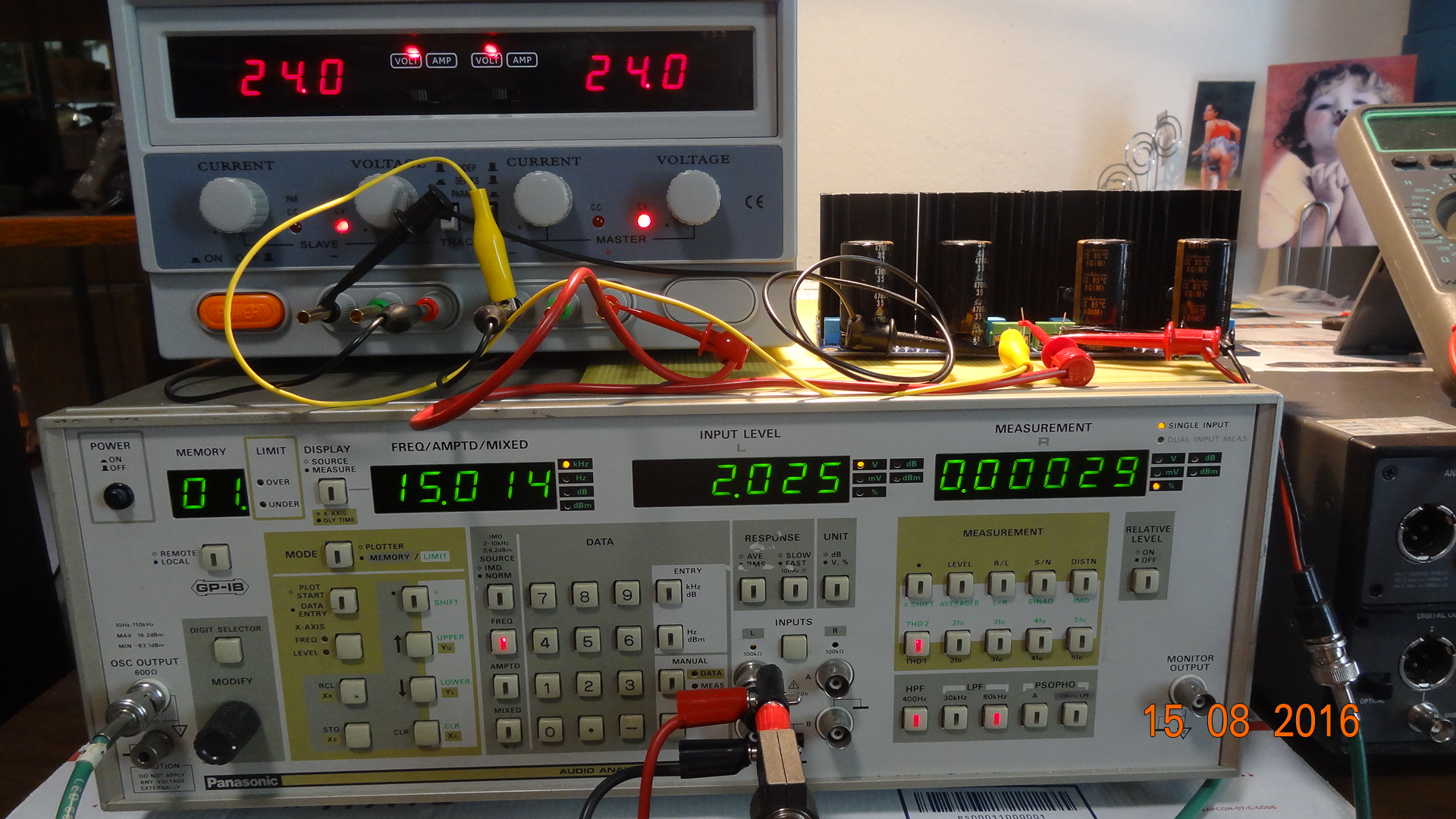

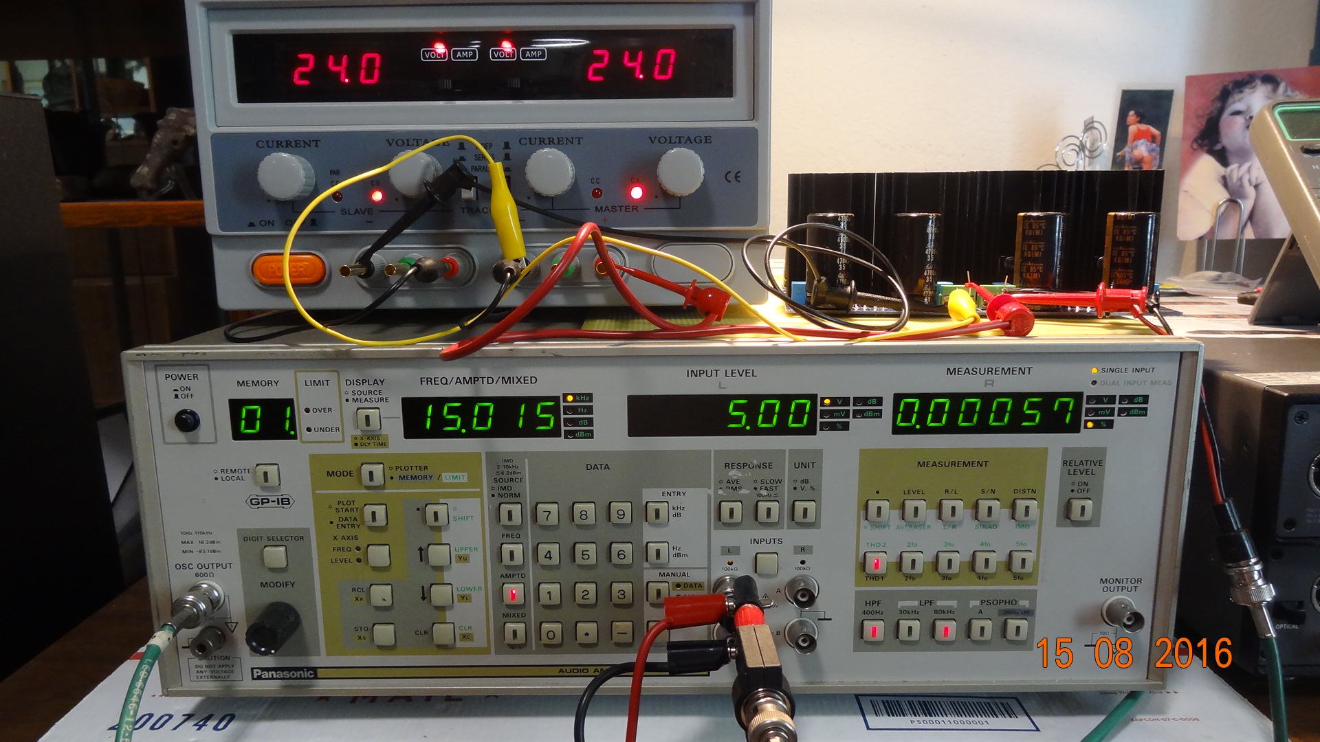

The THD did not change with PS voltage from 18 to 24vdc.
Here is the THD for 15KHz and 2v and 5v rms into 60 Ohm load:
THx-RNMarsh
Why do you test it onto 60 Ohm, low impedance headphones are 32 Ohm mostly?
Because I asked him to do these measurements with 60 Ohm load - mainly due to the fact that I did my simulations with such a load and wanted to know if there's correlation between simulated and measured results.
If you're curious about measured data with lower loads, please see the previous page - Mr. Marsh gave to us measured results even with 8 Ohm load.
