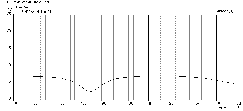

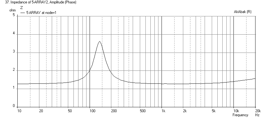

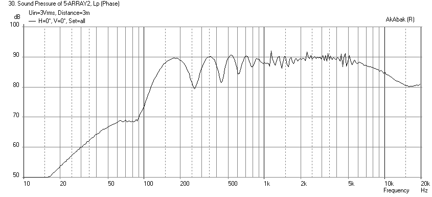

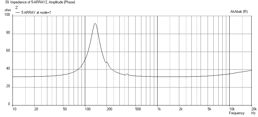

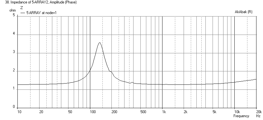

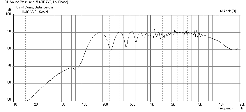

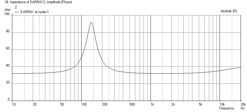

Akabak Sim of 5 driver Array with Common Chamber
I made a model of a 5 driver array with TC9FD's packed as close together as possible vertically. The rear chamber has dimensions of 4.25in W x 12in D x 21.36in H for a 17.84 liter rear chamber or 3.57 liters per driver - about right for TC9FD as a minimum. The rear chamber was modeled as 6 "Duct" segments with the driver rear cones located at the duct boundaries. I wired the arrays in series in 1 case and in parallel in the other case. In order to drive them to equivalent powers, I used 15v rms for the series case and 3v rms for the parallel case. I also have the ability to change or eliminate stuffing in the rear chamber (this basically adds resistance to the airflow in the rear chamber. At first there were only very small observable differences in the cone displacements between the two cases. However, when I added small (typical) variations in the T/S parameters of the drivers, the differences magnified themselves when in series wiring.

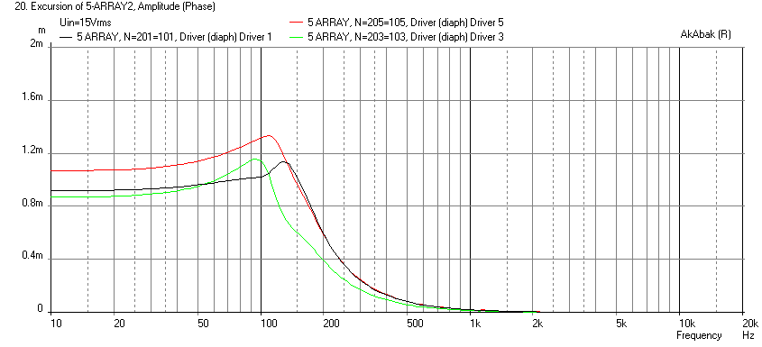

Here is the cone displacement for SERIES wired:

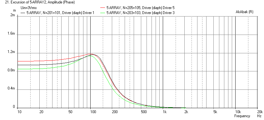

Here is cone displacement for PARALLEL wired:
Here is the SPL produced 3m away with the speaker centerline (driver 3) at 40in above the floor, and no back wall reflections, for SERIES:
Same for PARALLEL (as you can see it doesn't affect the frequency response much):
Here is Impedance for SERIES with stuffing:
Here is Impedance for PARALLEL with stuffing:
Here is Impedance for SERIES when stuffing is removed (see the little blips show up now):
Here is Impedance for PARALLEL when stuffing is removed:

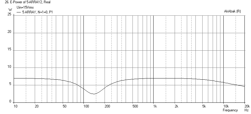

Here is electrical power for both cases to show that the drive power is the same (Series):
Electrical power for Parallel:
So, it does indeed look like series wiring produces some "chattering" between the drivers. You may not hear anything at low powers, but I think it may be more significant for higher powers and deeper cone excursions. It matters more when drivers are not matched.
An analogous situation with audio power amps using multiple output devices also happens. When parallel output transistors or MOSFETs are used, low impedance (circa 0.22ohms to 0.47ohms) power resistors are often used between each transistors' output and the common summing point output in order to allow self-load balancing because the transistors have different characteristics. Distortion is increased when they are not well matched. Without the load balancing resistors, some transistors can damage the others since they "fight". So damping or stuffing in the rear chamber really helps to alleviate this.

From my own impedance measurements it is clear that the more series drivers you have in the same volume the more unsettled the impedance plot is. It is also possible to sort the drivers into groups where the differences average out. The question still remains does this matter in practice and what is the penalty if it does. I have two almost identical towers except for the sorting of the drivers and the impedance plots they create. Measuring them separately should show some difference and it will be interesting to see where that difference comes from.

I can run a simulation of series parallel but I can predict what will happen is the impedance plot will be a blended average of the pure parallel and pure series with a nominal Re value of circa 7ohms or so. It's a lot of code to make this happen and I am not sure if you will learn anything new.

fluid, since your array uses 5 separate chambers here's a wiring idea you could try if you feel up to the task. Make the 5 series strings using one driver from each chamber. Then put those 5 strings in parallel. You would effectively be isolating the series wired drivers from each other and it would be as if each chamber has 5 drivers wired in parallel.
I think you are right my cabinet is pretty well stuffed and I have run them pretty hard with 10Hz tones. There was no runaway oscillation or driver destruction. If it presents an issue it will be more subtle than that and will probably be a rise in distortion.
The main difference will be around the array's impedance peak. 10 Hz tones won't be any different. I doubt it will be forceful enough to be able to destroy a driver as we still limit the power around that frequency area anyway.
I'm mainly interested in the even load and movement on all drivers and certainly do see an advantage in the parallel wiring.
It is the frequency area where I had to work a little harder to get it where I wanted it (phase wise).
After all the work I put into my speakers I cannot neglect this new data. I'm always looking for ways to improve and the 100-200 Hz area is fun to have right both in phase and frequency. I don't know when, but I'm pretty sure I will alter my arrays after seeing these graphs.
Not looking forward to the surgery but I just have to do it. I cannot dismiss this, as I've said before, every detail counts if you want good results.
You've seen my distortion data, nothing to be afraid of if you don't alter the wiring scheme. I will take any chance of an improvement anyway. I'm just "wired" that way I guess 😀.
That would take even more wiring!
Interesting comments from Owen and others, but there is still no theoretical reason for preferring one wiring approach over another. Owen, were you able to prove beyond doubt that the driver blowing up was caused by the wiring scheme? Or was it just a hypothesis? None of my drivers have blown up and I have 12 drivers in a single chamber (6 in series, and 4 sets in parallel) 😱 None of Wesayso's drivers have blown up and he tortures them all the way to 17 Hz.
Wesayso,
How are your drivers currently wired and how many actual sealed chambers do you have? I seem to recall all your 25 drivers share one chamber but with smaller breather holes in between groups of them right? They sound so good now, I would hate to take them apart for some surgery that may or may not yield an audible improvement.
Regarding blowing up drivers. These are too small to hurt one another. 🙂
Just realized I said the opposite of what I meant. Need more sleep. 🙂
Fluid's setup is already series. Needs to change to parallel I meant.
I am not sure if you wiring harness is now inaccessible or you don't want to rewire it. Series wiring is very simple if you use Faston crimp connectors - just daisy chain top to bottom +ve to -ve of successive drivers and take two ends as output. The parallel all the leads from each chamber.
