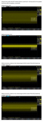

CSRA64215 + TPA3118 board
Thank you for these easy and useful mods! I have a CSRA64215 + TPA3118 board, since the modifications are the same, I post my results in this thread.
I did these modifications: Remove the preamp, antenna mod (post #111), reduce the gain (20 kΩ resistor → 5,6 kΩ), bootstrap snubber. They work great and reduce the noise drastically!
The Inductors get very hot (at very low music level: 65 °C!) so I compared 24 V and 12 V power supply: 24V: 145 mA →3,5 W, 12V: 83 mA →1,0 W! So I recommend using a 12 V power supply or upgrading the inductors.
I got rid of the start up pop by modifying the CSR-module: System → Timers: Audio Amplifier Unmute Time: 200 ms
I also did some oscilloscope measurements:

big problem for the noise on this combination is probably not regulated power supply for the NE5532. It is only filtered, but I will suggest to put some regulator like 7812, or LM317 (as 12V) on pin 8.
Avoiding NE5532 you loose some dB, cause NE5532 is low pass filter and balanced to unbalanced converter.
When you put output from bluetooth module directly to the balanced input of the amp maybe you put the noise into the amplifier.
Hello Pitbul, I did some tests:
I removed the audio line between the CSRA and the TPA and shorted the TPA inputs (INPR to INNR and INPL to INNL): Still 148 mA while playing music and (like before) 15 mA without music. This made me wonder because the CSR can not consume that much power. Next I analyzed the TPA mute pin. Tadaa: If no music is transmitted the mute pin is high (3,3V), muting the amplifier. If music is transmitted (even at zero volume) the CSRA chip pulls the mute pin to GND, unmuting the amplifier →high current draw.
Because of the shorted differential Inputs, I think that there is no problem with high frequency jammed audio input signal. Do you have any other ideas?
