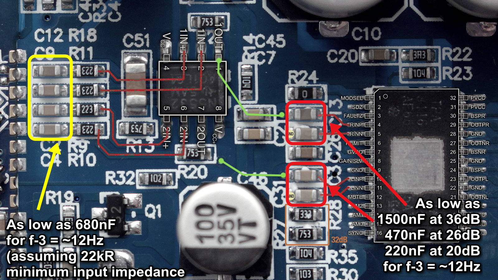

hi which caps do you mean?
Are you going to keep the 5532 Diff2SE opamp stage? If yes, then
attachment.php
If you remove the Diff2SE opamp, then the values marked in RED apply for the caps marked in YELLOW. (As the red ones get removed when bypassing the opamp stage)
Values are calculated for f(-3B)cut-off at 12Hz.
669668d1521475019-sanwu-tpa3116-csr8635-bluetooth-4-0-noise-fix-sanwu_tpa3116_csr8635_v2-2_4_orig_1600_new-jpg
ok thanks for that, i think i will leave the Diff2SE opamp as it is.
so i need to change the yellow once with 680nF and the red once with either 1500, 470 or 220nF ? but how do i know which i should take?
The standard config on these boards is 36dB for the TPA3116, so 1500nF is needed. In most cases 20dB is more than enough, which can be achieved by removing R27 "753". After gain is reduced, 220nF is okay here.
Another mod is to change those 4 "753" resistors around the 5532 for "223" (75k -> 22k) to bring down the gain to 1.
You may try this in combination with changing the yellow caps to 680n.
ok thanks for clearing that up. i will order the right caps and try it.

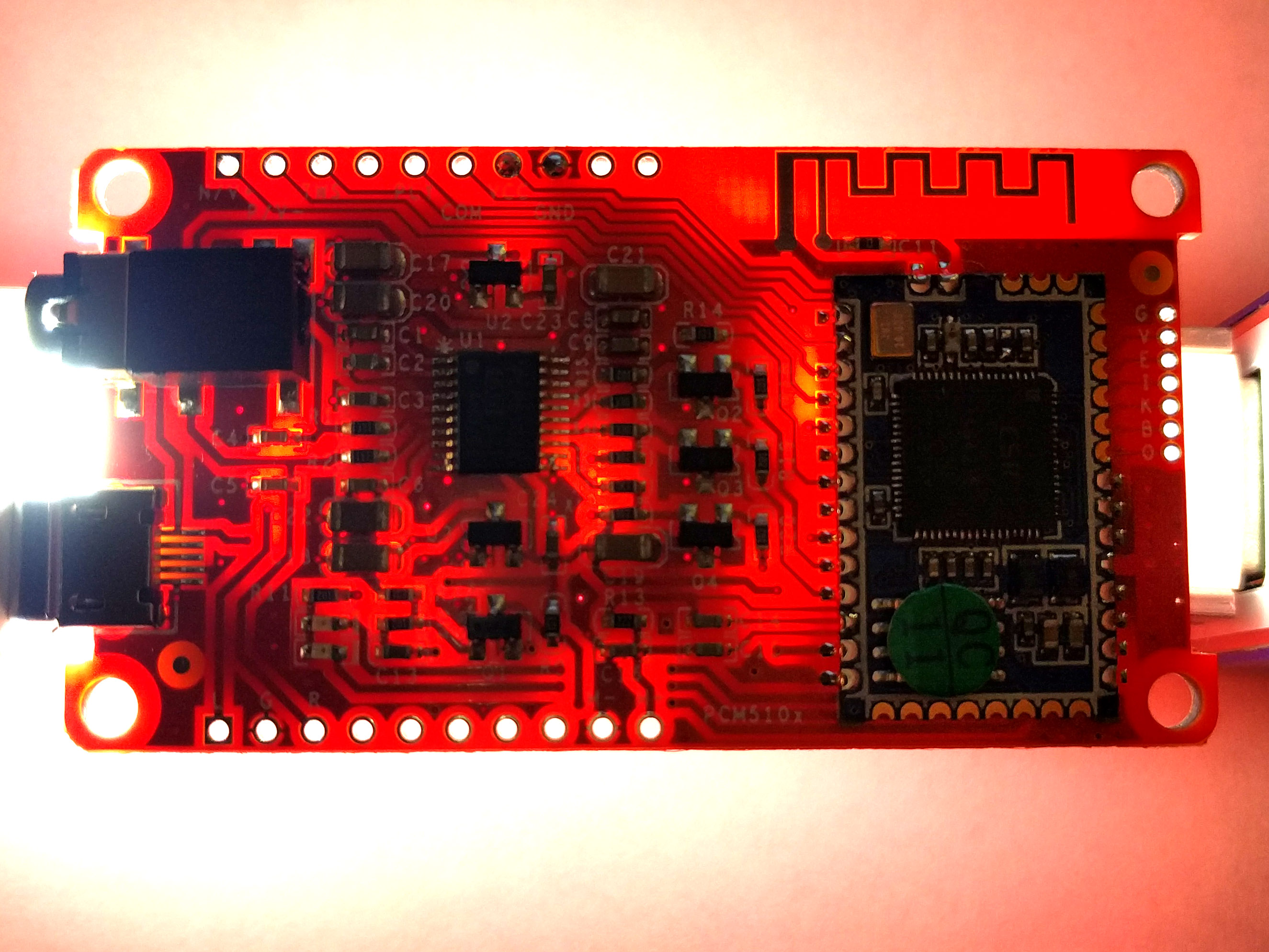

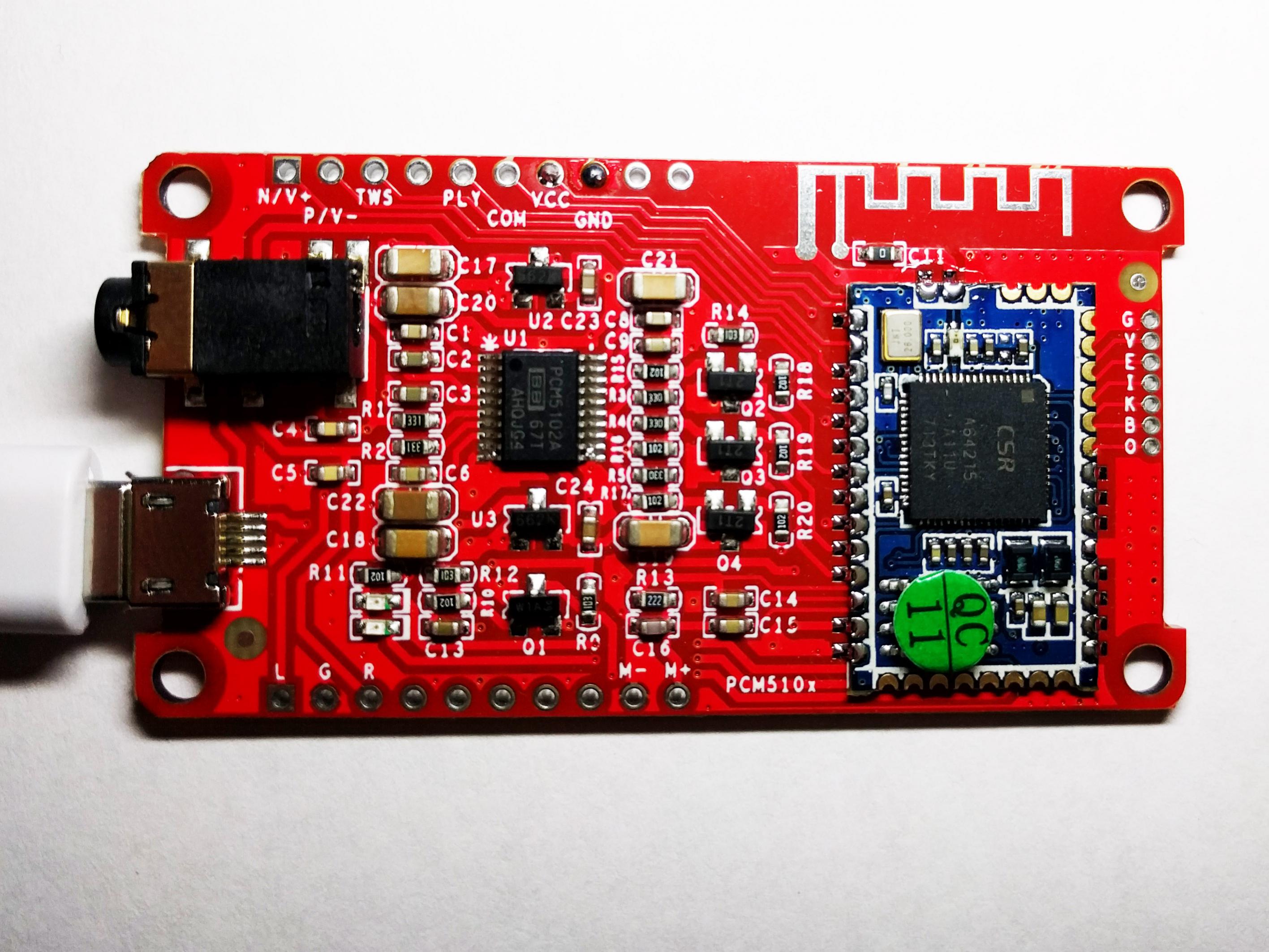

I have a similar module but it runs the CSR 64215 and PCM5102a.
I bought it hoping it would not suffer the usual problems of popping and hissing but it makes a slight hiss for a few seconds after you stop playing music - then goes quiet.
It makes a small pop when you start playing any input again.
I'm running 48 ohm headphones but I've tried feeding it to line-in on my PC and it has the same issue.
Is there any way to fix this board? I found and attached a PDF showing how they wired it.
They somehow managed to get the left and right channels swapped on the design, even though the channels appear to be correctly routed between the DAC and the headphone socket. 🙄

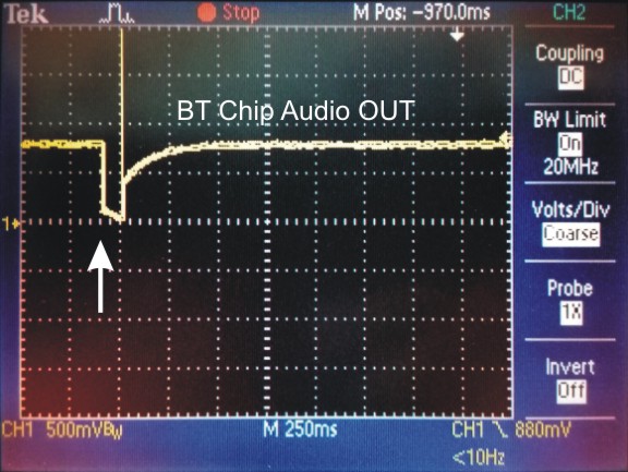

About AUX input commutation to avoid POP noise
Hi guys!
I'm new in this forum. In first place let me thank you for all your valuable work and information.
I'm working on a project with a module using the CRS8635 and have the same problem about the pop noise when audio streaming stops.
I reached this forum and found the activation of the AUX input as a very clever and smart solution.
I've tried it with, unfortunately, no success. It seems that the amplifier is powered off after about 3 seconds after the A2DP stream stops an turned ON again (for the AUX input) after about 120 ms, as you can see in this capture:
So, the "pop" noise due to the negative edge in the DC voltage is still there.
I think that the best sollution woud be to find the way to avoid the powering off of the output amplifier of the CSR chip. I suppose it should be possible with any of the hundreds of PSKEYS, but wich one??? 😕
Does anyboy have any clue about it?
Thank you very much to all of you and, please, sorry for my english!

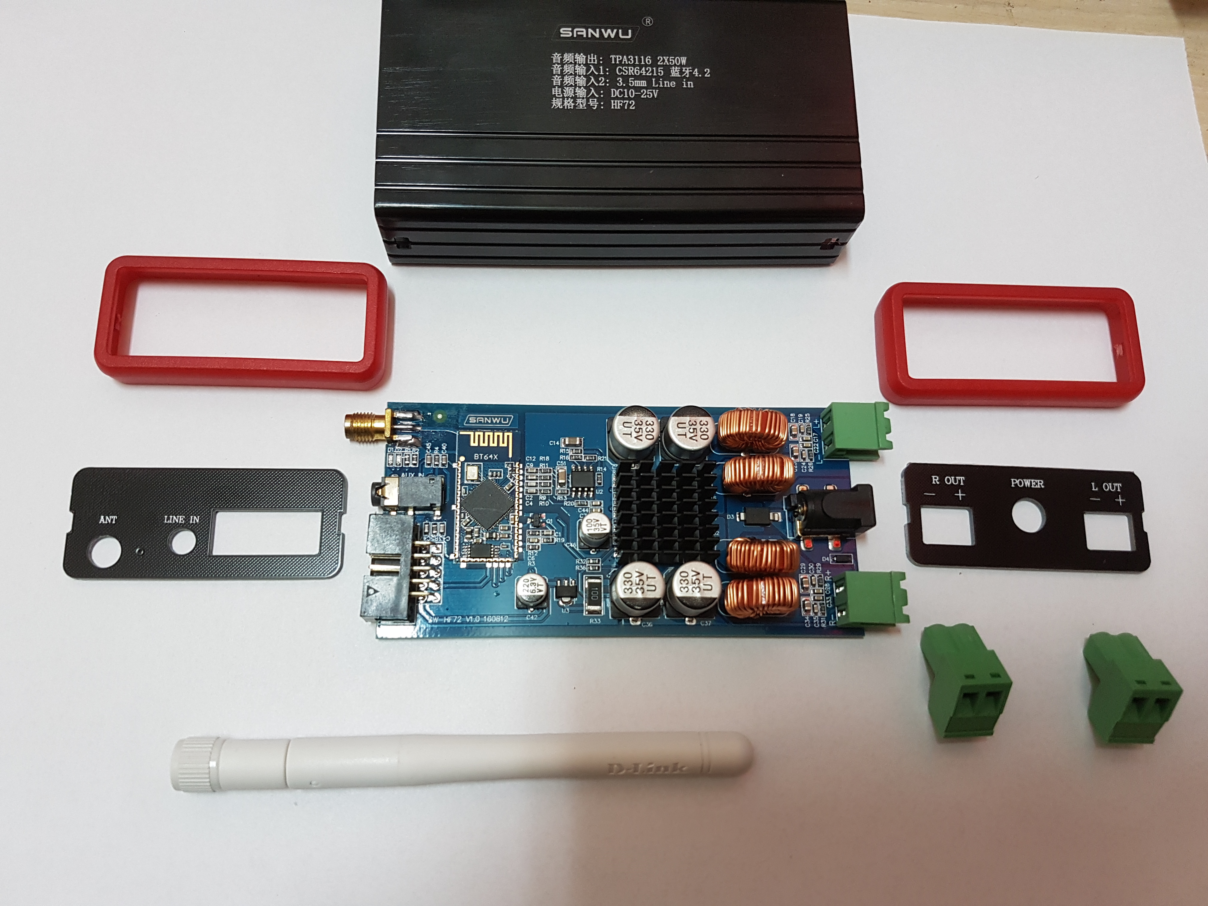

Hi Guys,
first time poster, long time lurker.
after 5 weeks of waiting I finally received this. the BT 4.2 aptx low latency version : SANWU(R) 50W+50W TPA3116 HIFI-Class Wireless Bluetooth 4.2 Amplifier Support APTX Low Delay Sale - Banggood.com
tried it, sounds really good, but also BT hiss... haven't tried the aux in jack yet.

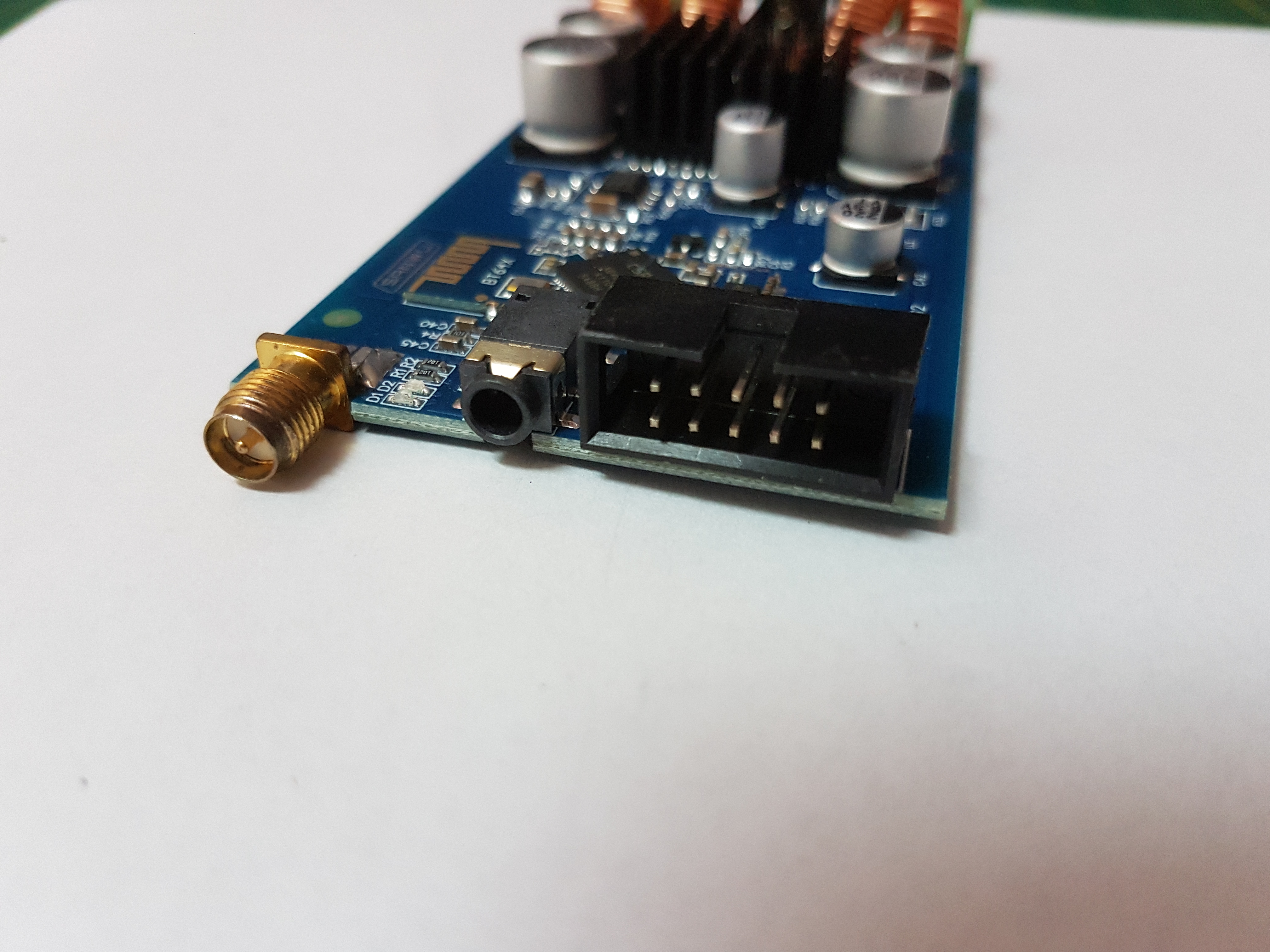

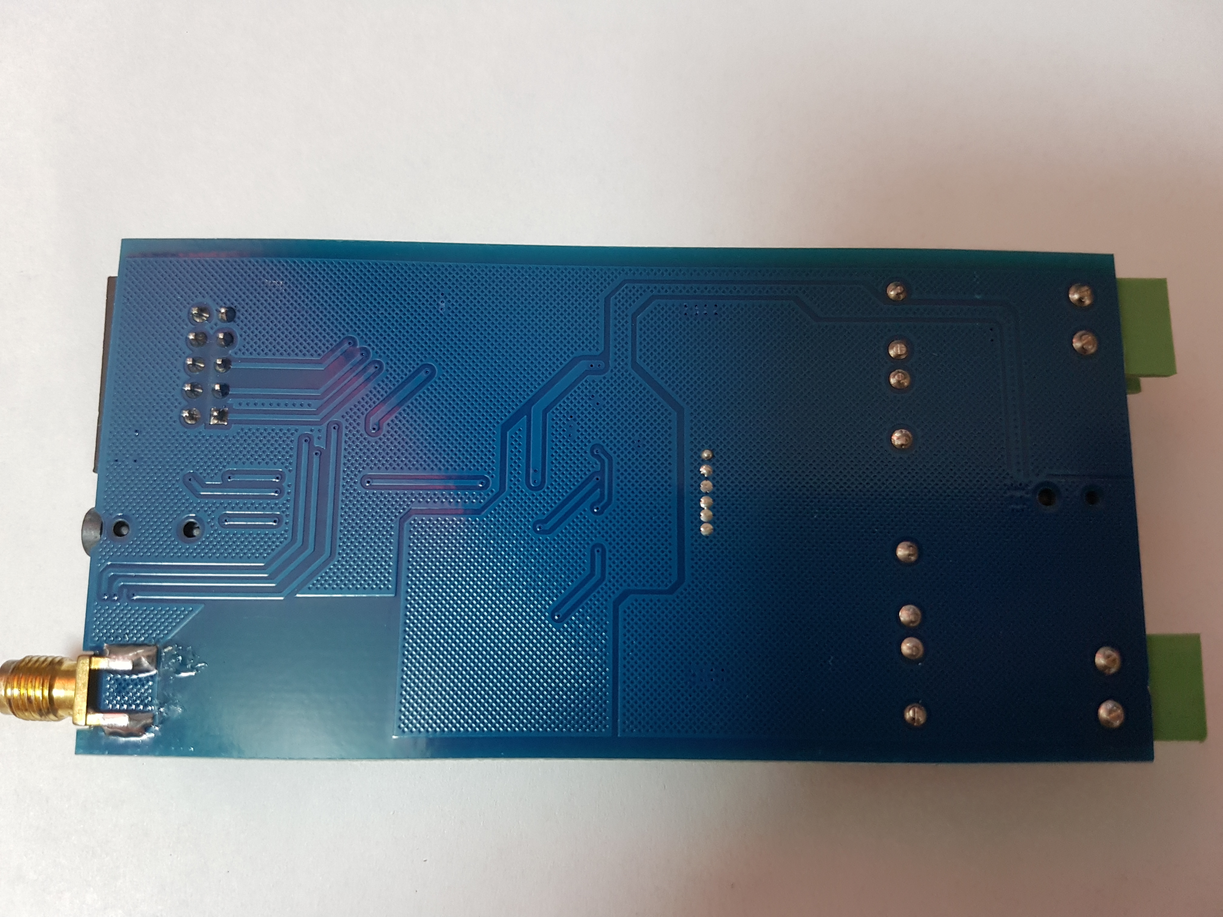

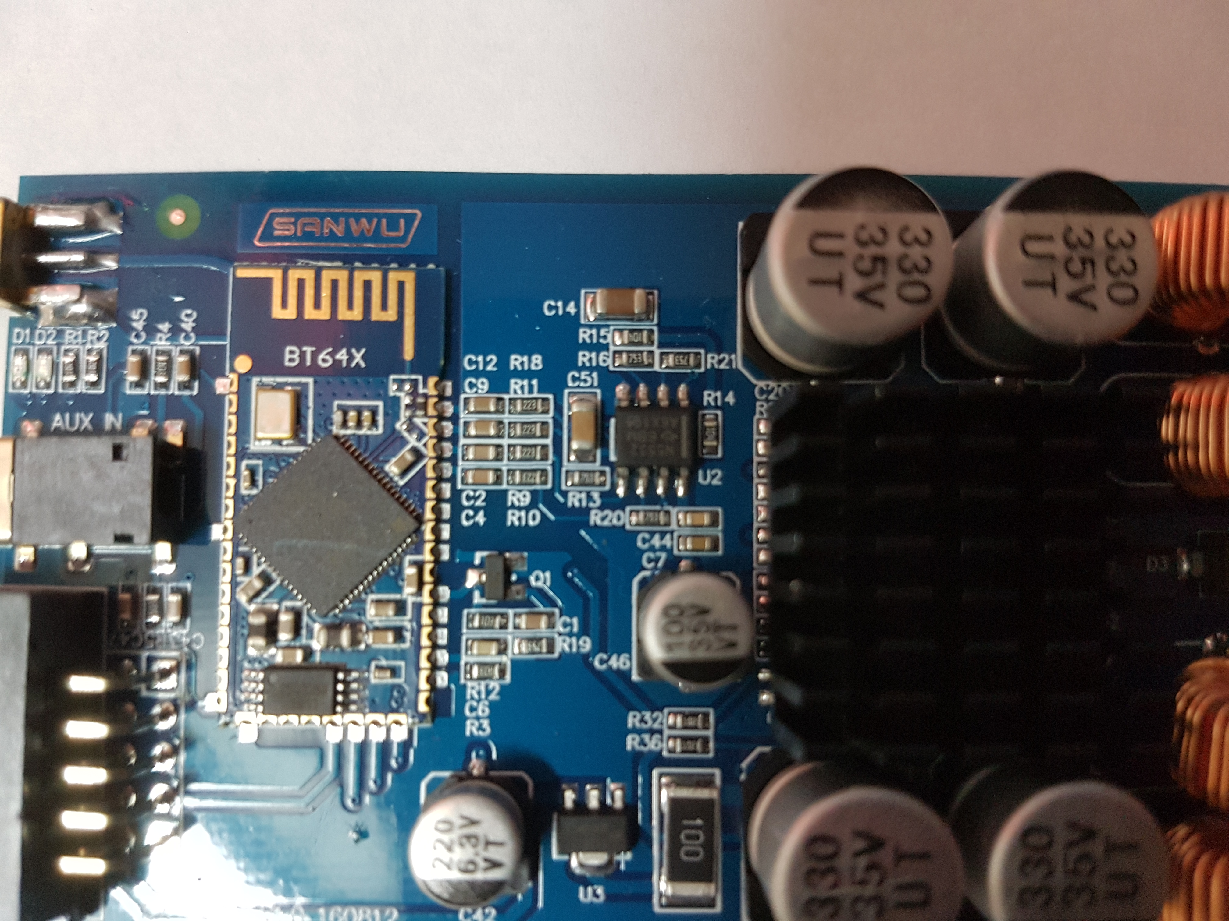

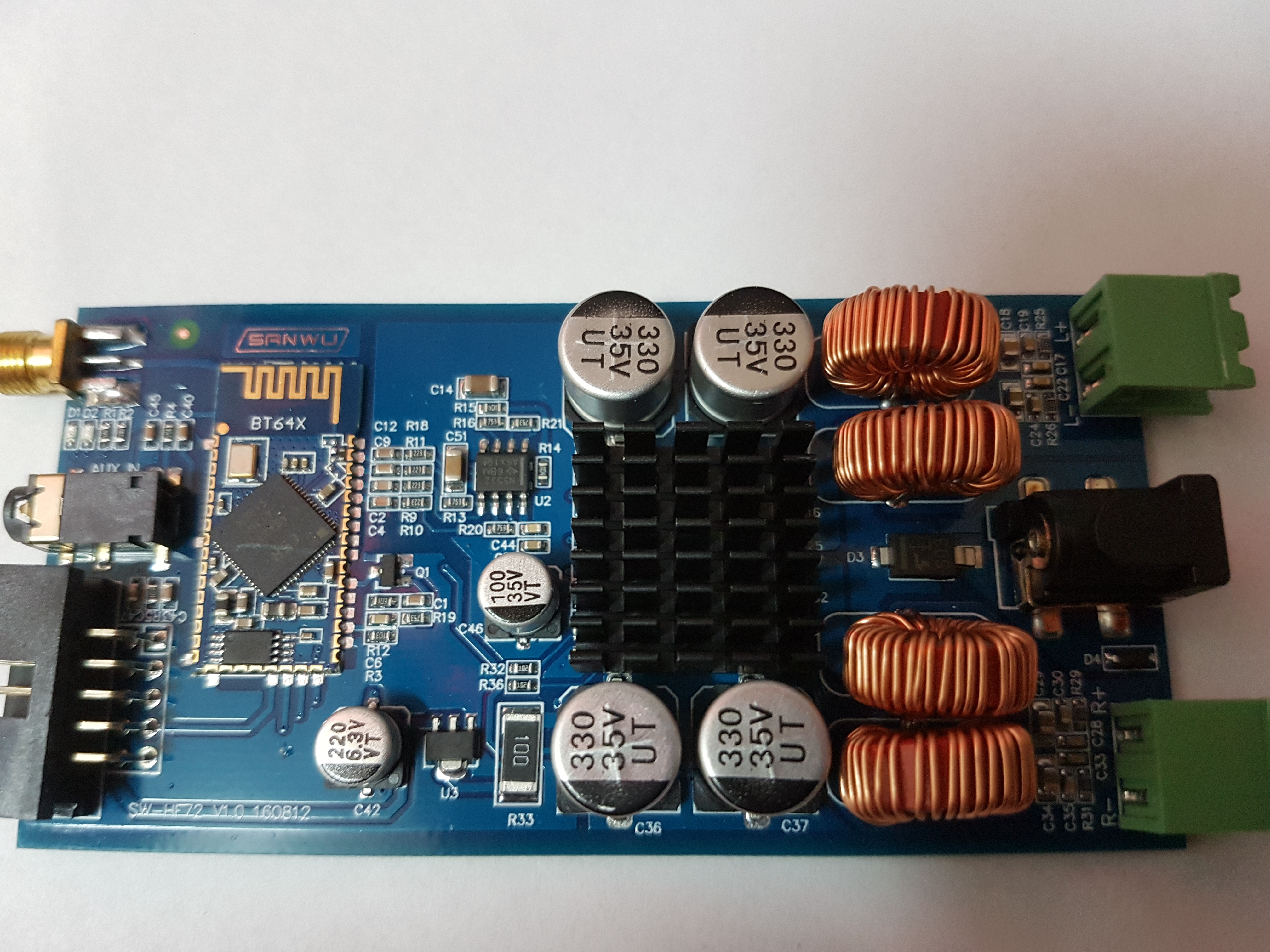

So, before examining the Diff2SE stage I'd post some pictures here:
also todo: figure out the break-out connection on the front, I know already a couple of the pins lead to the bottom of the CSR BT module.
