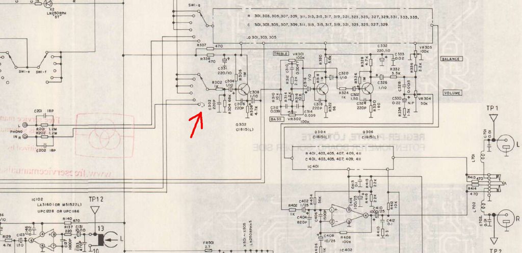

Hi everyone. My father has a very old Grundig CC250 that he loves and he's planning to fix it (belts and other stuff) and, we wanted to add a line in input as he want to connect PC, smart phone and CD Player, 1 at a time.
Luckily I have the service manual of the equipment!:
Grundig CC 250 Free service manual pdf Download
or
CC 250

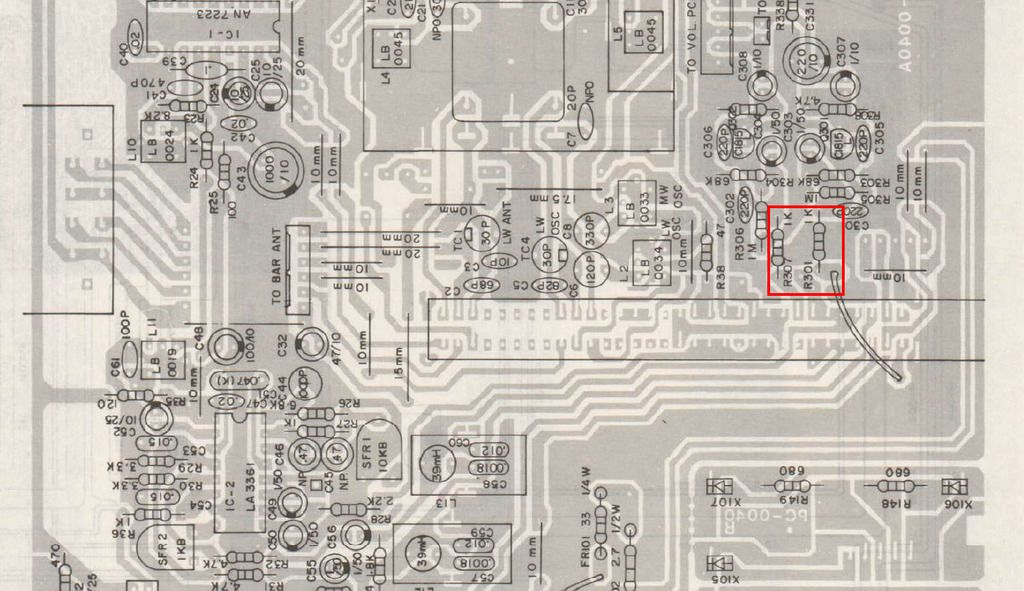

So, my first idea is to add a simple preamp or buffer or "impedance matcher" (inverting or non inverting?) with a NE5532 (or TL072 or RC4558) in front of the tone control, using maybe the power supply of the Grundig for it. It would be in the red arrow in the next picture:
Which is this point (it should read R302 instead of R307) in the board:

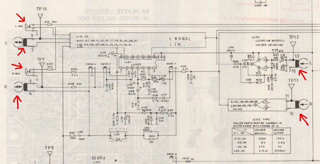

Or what about where the cassette reader heads connect? That should be more difficult right? Or adapt the mic inputs (the preamp has this ALC thing that doesn't sound good for line in, automatic level or gain control, or audio limiter control):
Also where's the RIAA eq? It doesn't seem to be the middle left circuit in the first photo (R201/2-C201/2). Should I even bother to bypass it?.
Now I do not intend to cancel one of the functions of the equipment, I could add a switch to keep the function. If I had to cancel one function would be one of the tapes, the second one. It wouldn't be necessary if adding a switch on front of the tone control...
Now I'n not sure but I noticed that this equipment amplifies all the time, there is no need for example, if you select cassette, to press play for the amp to start running. If true this would make easier to add a line in with my proposed method.
So what do you suggest?
Where do I do the connection and how?
If I have to add a buffer or preamp, what circuit do you suggest? Inverting or non inverting? With gain or not? Variable gain? Variable something else? How exactly do I feed it using the power supply of the Grundig?
Thanks!!!

Well, the vinyl player is in use (will be after the belt is replaced), but that's the first spot I was talking anyway: the input of the tone control. Do you think it will have unwanted noise or strange eq curve or something? My intention is that it sounds perfect as if it had line in by design.
So you don't see a RIAA there neither?
I don't know if it is ceramic, my father says it could be.
It is clearly ceramic- a 1.2Meg input resistor would trash a mag-needle's signal. A mag-needle input would look a lot like the Tape preamp, just different R-C values.
The clear intent is that signals arrive at the Selector switch already "leveled" and with their right EQ. The tape preamp has the expected EQ. The FM tuner has deemphasis and 19KHz notch. The Phono's 1.2Meg and 18pFd work against the 1meg at the selector switch to give about 6dB boost above 5KHz, a small refinement for a ceramic needle's usual "flat" response. So the Selector switch input expects "flat, needs no more EQ".
BUT looking forward: Q302 Q304 work unity-gain, but Q306 works at gain of 20 or so, THEN comes the Volume control. And Q306 runs on 10V supply, will overload at 3V out, so can not take more than 0.15V input! Indeed the tape preamp is not large gain and the tuner output is attenuated! (R31 R33) Also the power amp works at high gain, so levels through the selector tone boost and Volume chain must be lowish.
Many sources exceed 0.15V. iPod is several tenths of a Volt. Hi-Fi CD deck is often 2V.
Grundig knew *exactly* what sources they gave you. You want to connect "any line out", and the world has changed in 30 years. I think many sources will need to be pot-padded to taste. This could be a back-panel knob only set when a new source is introduced to Grundig. It might like to be on "6" for an iPad and on "3" for a CD/DVD deck.
DPDT switch chopped into the Phono feed, and 100K Audio taper pot from the Line In jacks.

I overlooked R304 68K. This has little effect with the low-Z tape and tuner sources, but is key in this form of Phono input.
With 1.2Meg||18pFd to 68K||220pFd plus wire strays, the PHONO input IS "flat" for our purposes. And it will take over 2V of input! Which is reasonable for late ceramic needles.
So you even keep the phono input R-C network. Slash between here and the needle, add DPDT switch, add 2 RCA jacks.

But if you "have to", snip the connection to Vol pot tap.
For what I just searched that is C328, C330 and R334 or like this http://www.eleccircuit.com/wp-content/uploads/2010/09/audio-loudness-control.jpg

I would change 1.2Meg+18p to 390K+56p or 120K+180p to find a happy level. (Or go back to the pot idea.) This will be separate from the PHONO input's 1.2Meg+18p.
> How can you tell?
It is a (modified) Baxandall. Q304 is a high-gain inverter. All that other stuff sets the gain. If you center the pots, you can see the impedance A-B is equal to the impedance B-C. The knob-center gain is unity (maybe 0.98 due to non-infinite gain). More poking suggests the extremes of bass gain are 10K:110K and 110K:10K, about +/-20dB. The treble equations are less clear, but clearly symmetric.

At this point I think you are prepared to just try it.
High level sources (CD deck) can plug right to the existing Phono jacks. Does that work OK?
Weak cell-phones may need less than 1.2Meg in series, so try less. For accuracy in the top octave, increase the C in the same ratio you reduce the R.
If you really need "any" source, the pot with a smaller R suggests itself.
