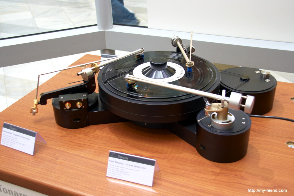

Another picture of the new Thales Simplicity arm in action in a three-arm turntable at the recent 2010 Munich Show. It certainly looks more practical than the two arms of the Original model. Simplicity is correct!
To be honest, I fail to understand why the Original model has to be done such way that's so awkward to install for most turntable. Surely, one can design a guiding arm without being position so low. I am sure there are other ways to handle that. Well, at least the Simplicity sounds like a self critique.
