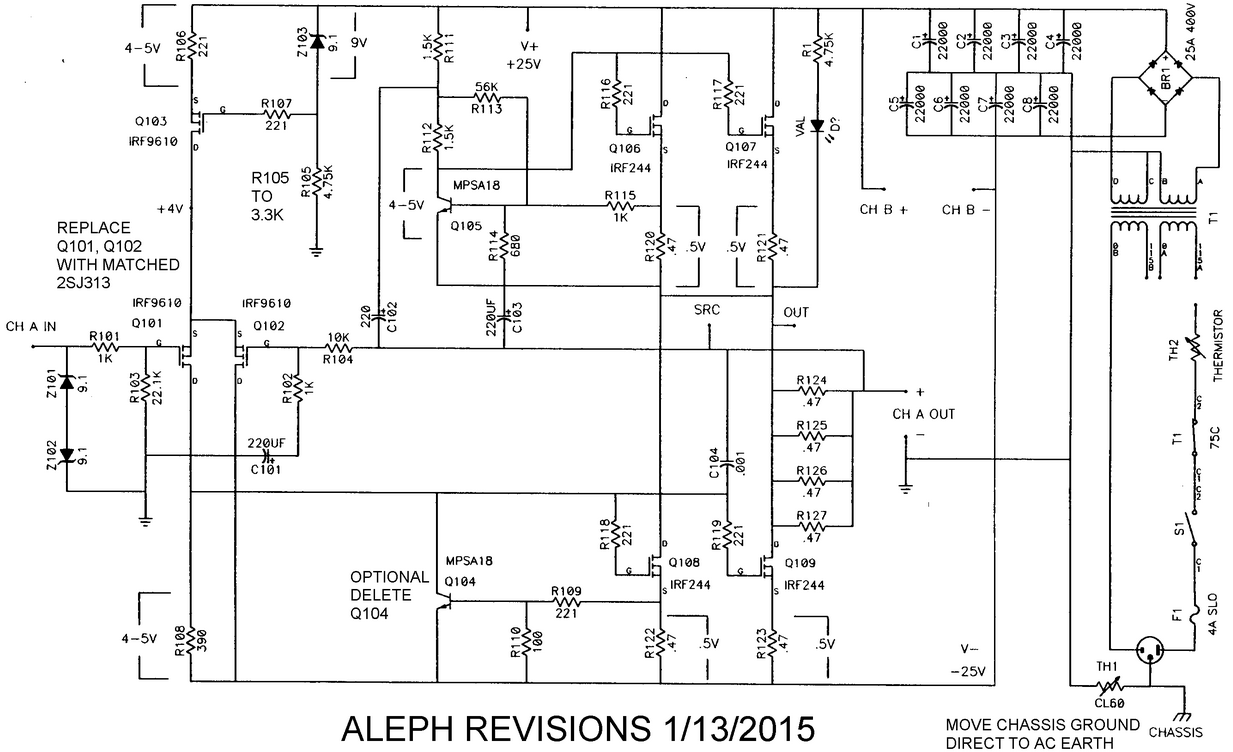

ZVP3310 - Good choice as input fet for Aleph 30
I tried it some month ago and it was a completely different sound, more highs, more presence, more details.....
But I liked also the somewhat darker sound of the 9610 and I found them to be a little more dynamic...
So I could decide what I liked more and
built another amplifier......
I know this is an older thread, but I'm trying to find out which resistors' values need to be changed in order to use a pair of ZVP3310's for Q101 and Q102, while leaving Q103 as a IRF9610?
I'm assuming R106 and R108 need to be changed, but to what values so as to not "cook" the 3310's?
Would it be a good idea to use trimmers(or trimmers with a resistor in series) in place of those resistors?
Thanks...
