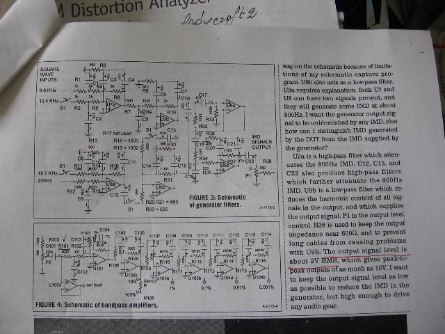

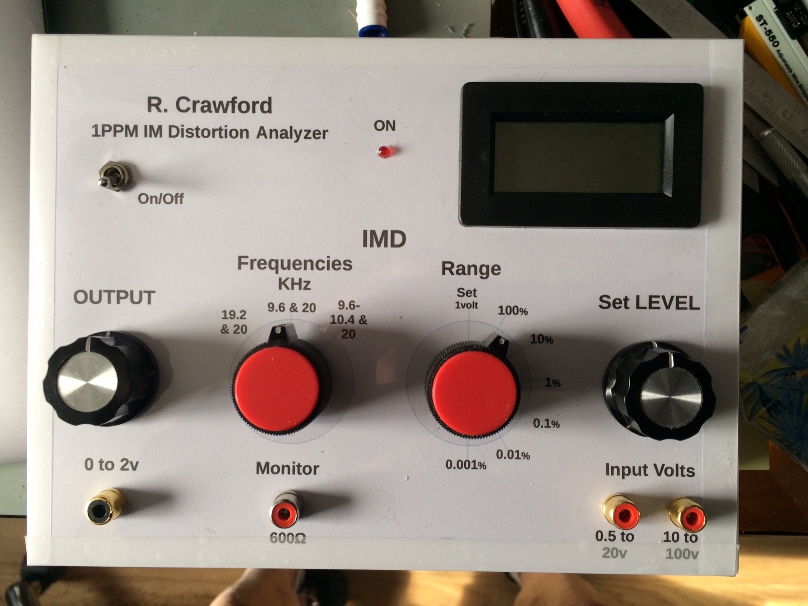

There is a Pcb at AudioXpress from Richard Crawford to make a IM Analyser
AudioXpress march 04... plus an addenda from f Glabach
I already built-it, have to finish the box....
it has 9KHz plus 19 and 20 KHz and for 40 U$PCb plus about 100U$ components
you can build a 1PPM Distortion Analyzer ; works with a analog output ...
http://www.audioxpress.com/bksprods/pcbs/testing.htm

Allthough I am subscribed to audioXpress, I seem to missed the AudioXpress march 04 number with a 1ppm Dist Analyzer.
Could somebody could post a scan of the schematic of that design? . You can leave out the values to save your karma 😉

tschrama,
Here it is, a little extract...
Alain.
