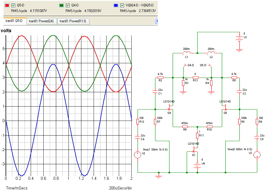

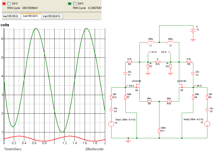

I know that this thread is old news, but I've been exploring with a simulator and have discovered what seems to be better ways of setting up this amplifier. Schematic below has balanced input at 2.5 volts. BTW, my original amp doesn't sim very well, this is much better!🙂 Admittedly, I'm still testing and there are probably things I've overlooked. Still, this sim business is a whole bunch of fun!

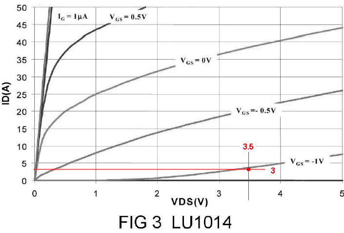

So I thought I'd play with the most simple version of the ZV7-T -- a version with the big 1000 V/Z Plitrons and a pair of Loveltech LU1014D transistors. I employed a 5 volt power supply (ha) to keep the transistor in the concave portion of it's ID/VDS curve. I'll breadboard it this weekend.
The sim says that the LU1014D transistor power consumption is 7 watts per device -- just about where the ZV8 operates.

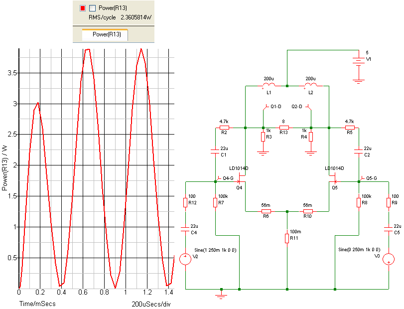

This idea came about because I have 110 db, 1W1M horns and only require a watt or two of power. This amp delivers approx. two watts, or so. Might be wonderful, who knows?
There seems to be a phase issue. All suggestions are welcome.

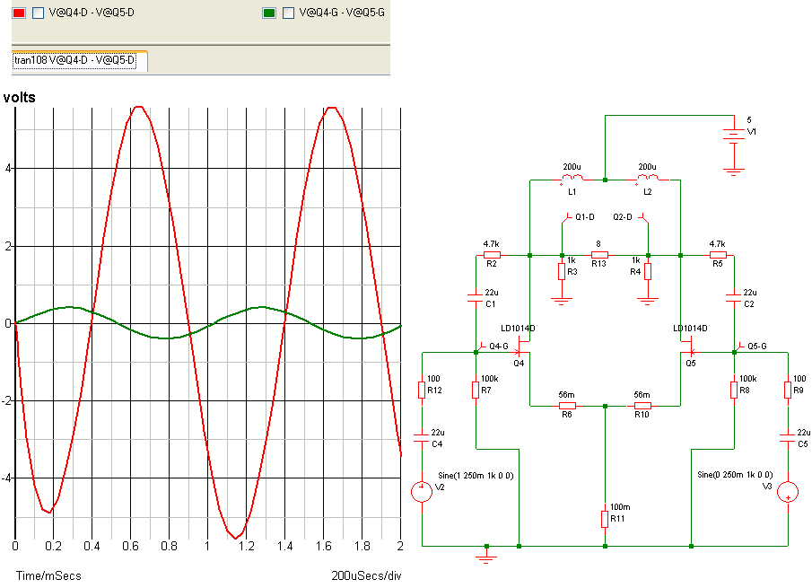

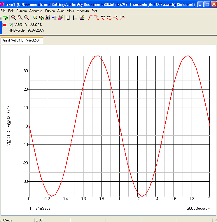

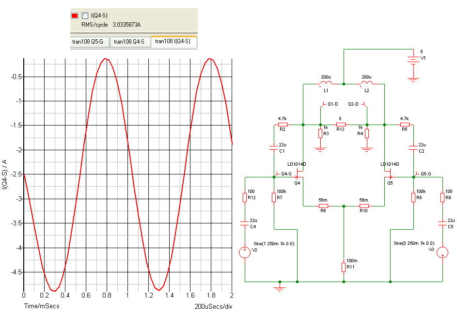

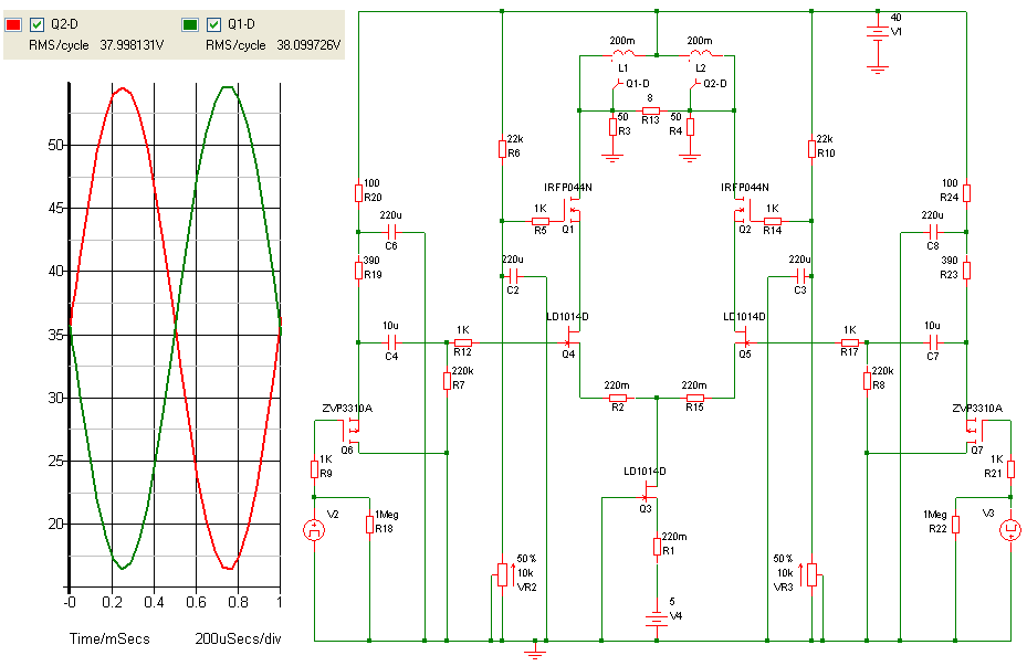

Here's a bunch of sim pics:
I made a mistake: the choke shown in the prior schematics is rated at 200 micro-henries (per leg) instead of 200 milli-henries. The larger choke changes everything. On a brighter note, the 200 micro-henry choke can be a very small air-core fellow with less distortion than that of the Plitron, iron-core transformer.
I'm still impressed with the concept. 🙂
Zen Mod said:CCS in tale?
I'm exploring that concept, Choky. It's very simple for me to add another LU1014D to the tail.
Thanks for taking the time to read and respond to my tiny, itzi-bitzi offering.😀 😉
Hi Carpenter !
You have connected the current source j fet wrong. The gate should be neutral or slightly negative compared to the source. The way you have done it, the gate is 5 volts more positive than the source, and the j fet is completely open.
Keep on.
Thorsten Larsen
Keep on.
Thorsten Larsen
as thorsten sez - connect CCS in tail to some negative voltage ;
in that case source of LU will float to where it needs to be
use there any decent mosfet instead of LU
even better - use CCS as Papa like it - mosfet + little bjt
