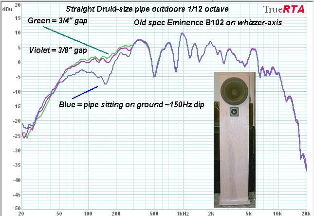

(-make an impedance measuring jig ad use Room EQ Wizard)- if a 10" thn probably based on the old spec Eminence B102which had lower qts and a more extend rang than the current B102
I made some fake Druids with the old B102 , apt50 and APT3- quit functional - mine didn't have the foam cone - just some bonded dacron lining

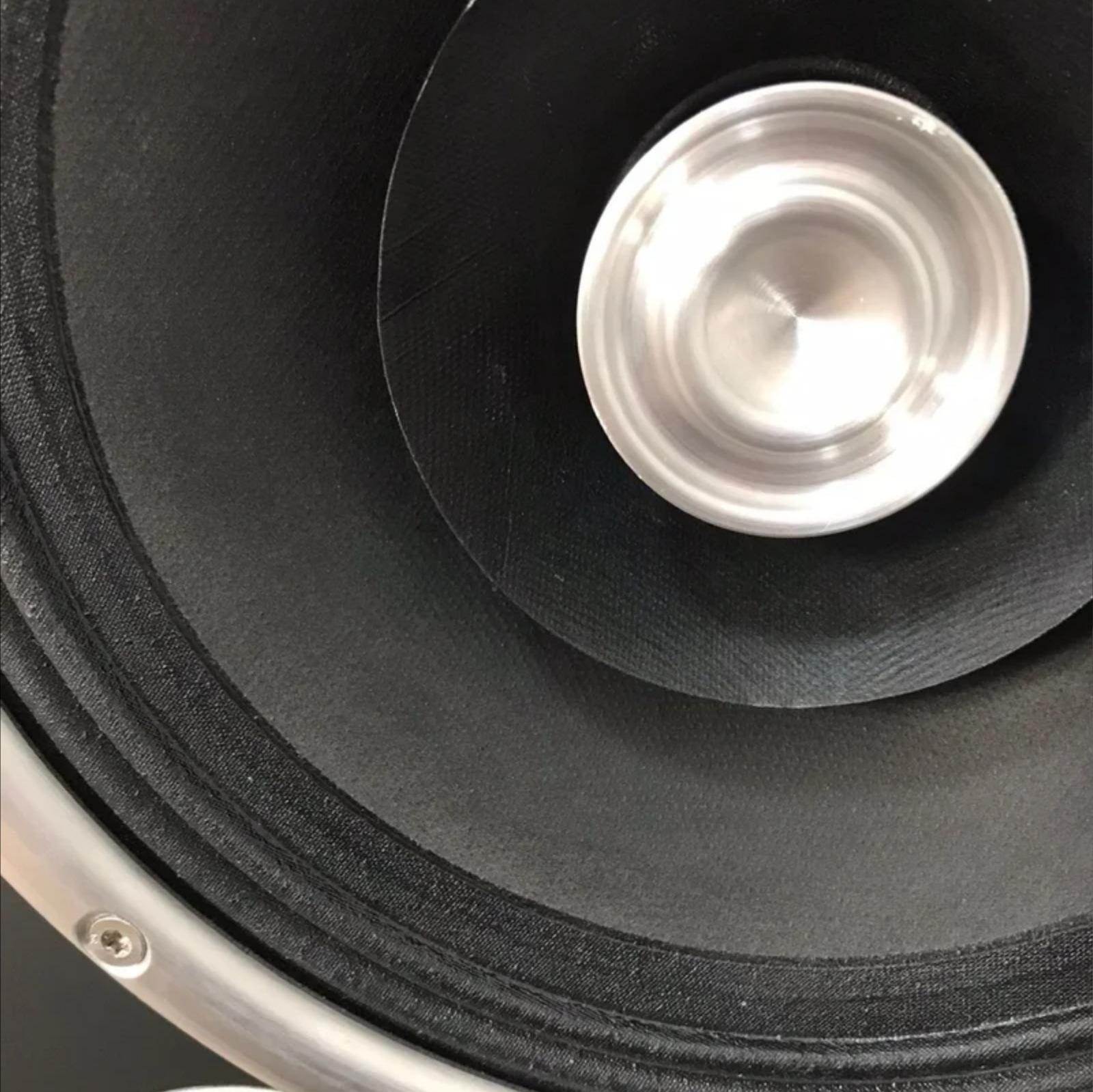

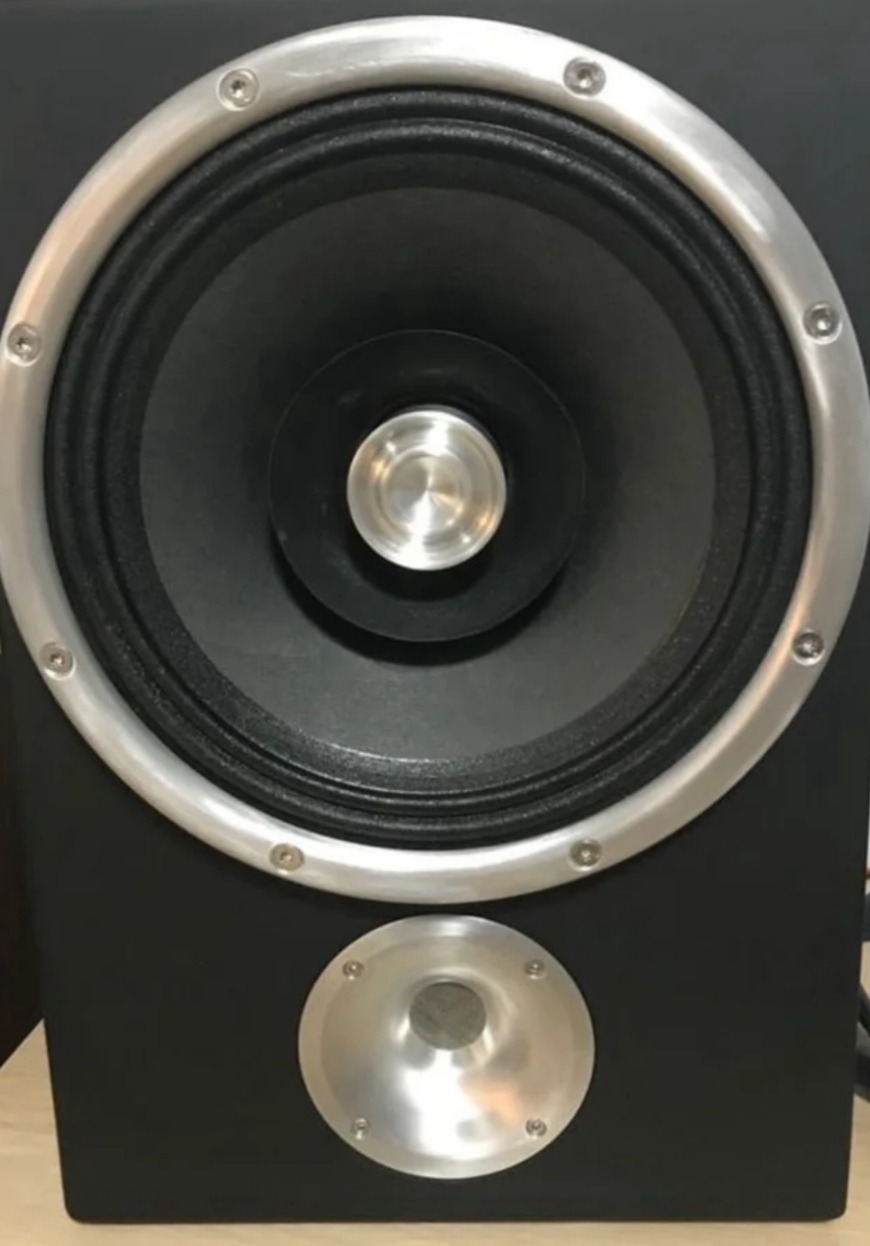

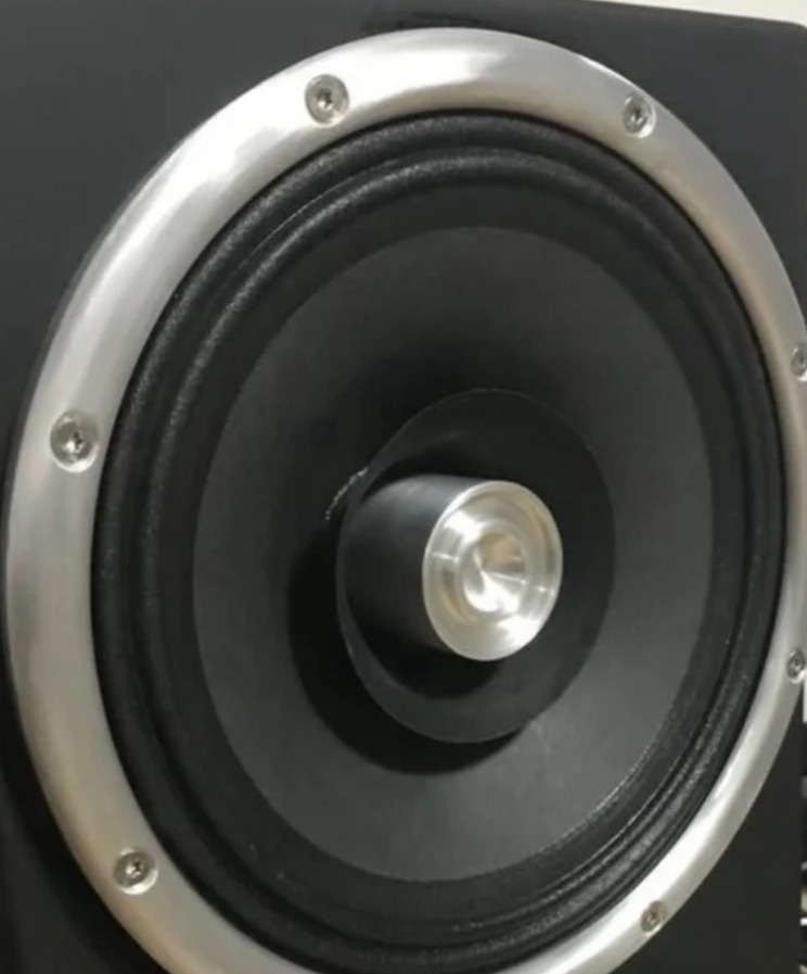

In my speaker the driver looks different than the Eminence B102
The "dust cap" looks different and there is no foam surrounding.
Kindly see the attached photos
