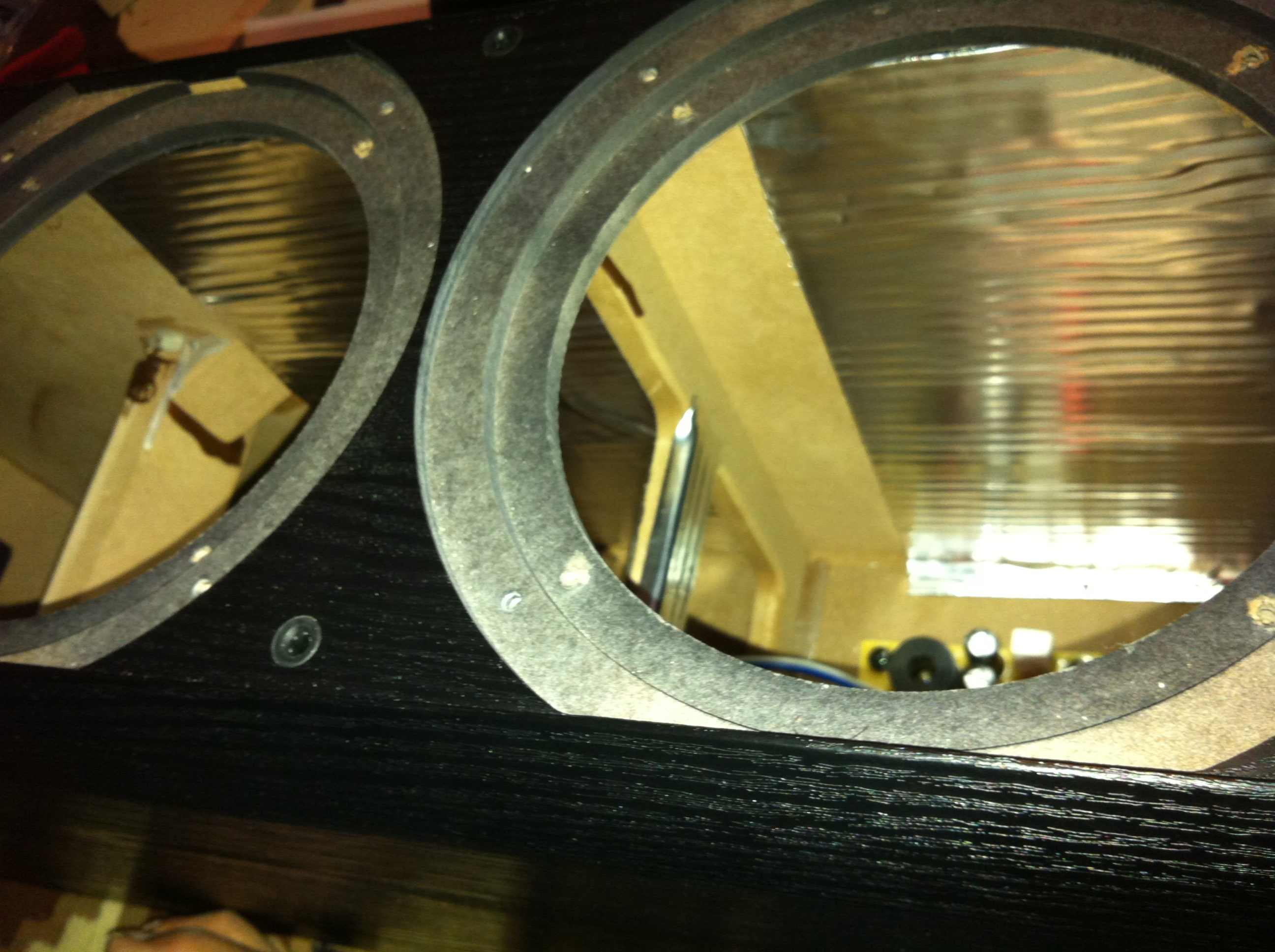

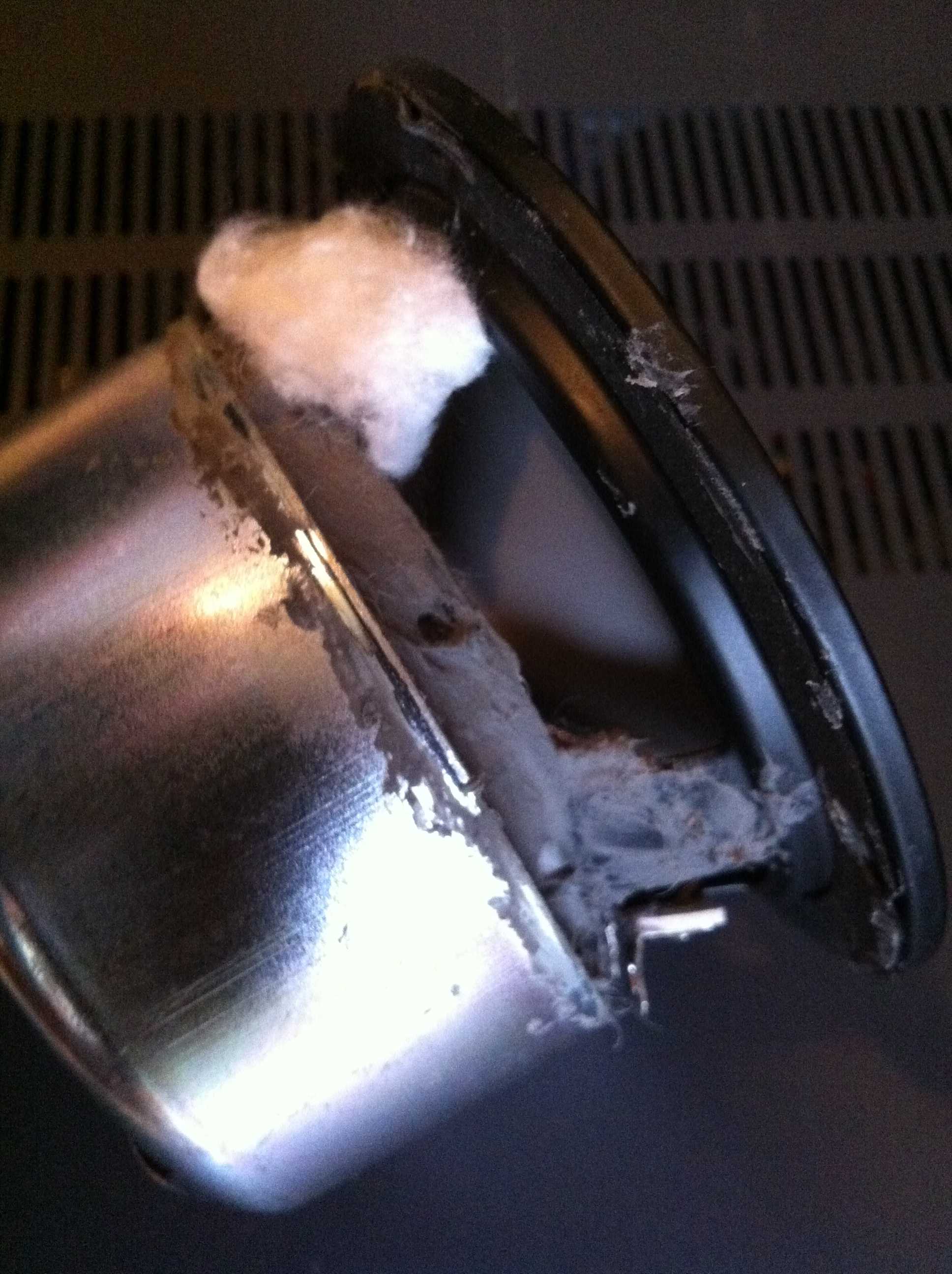

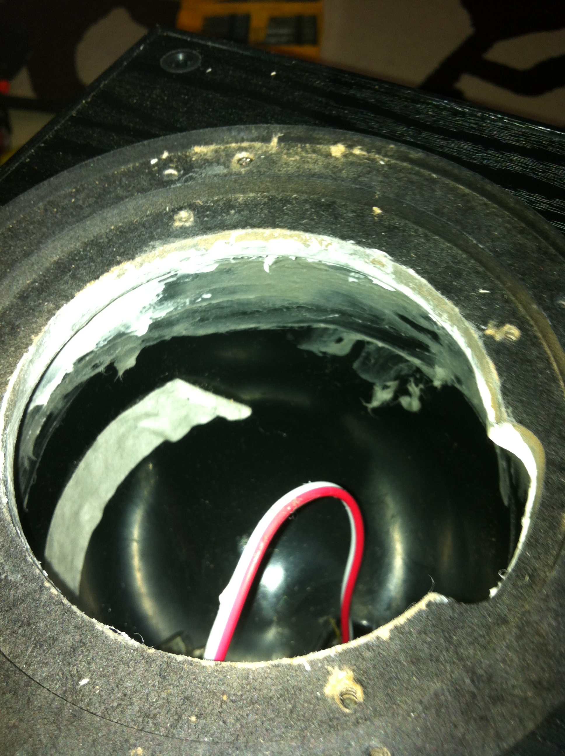

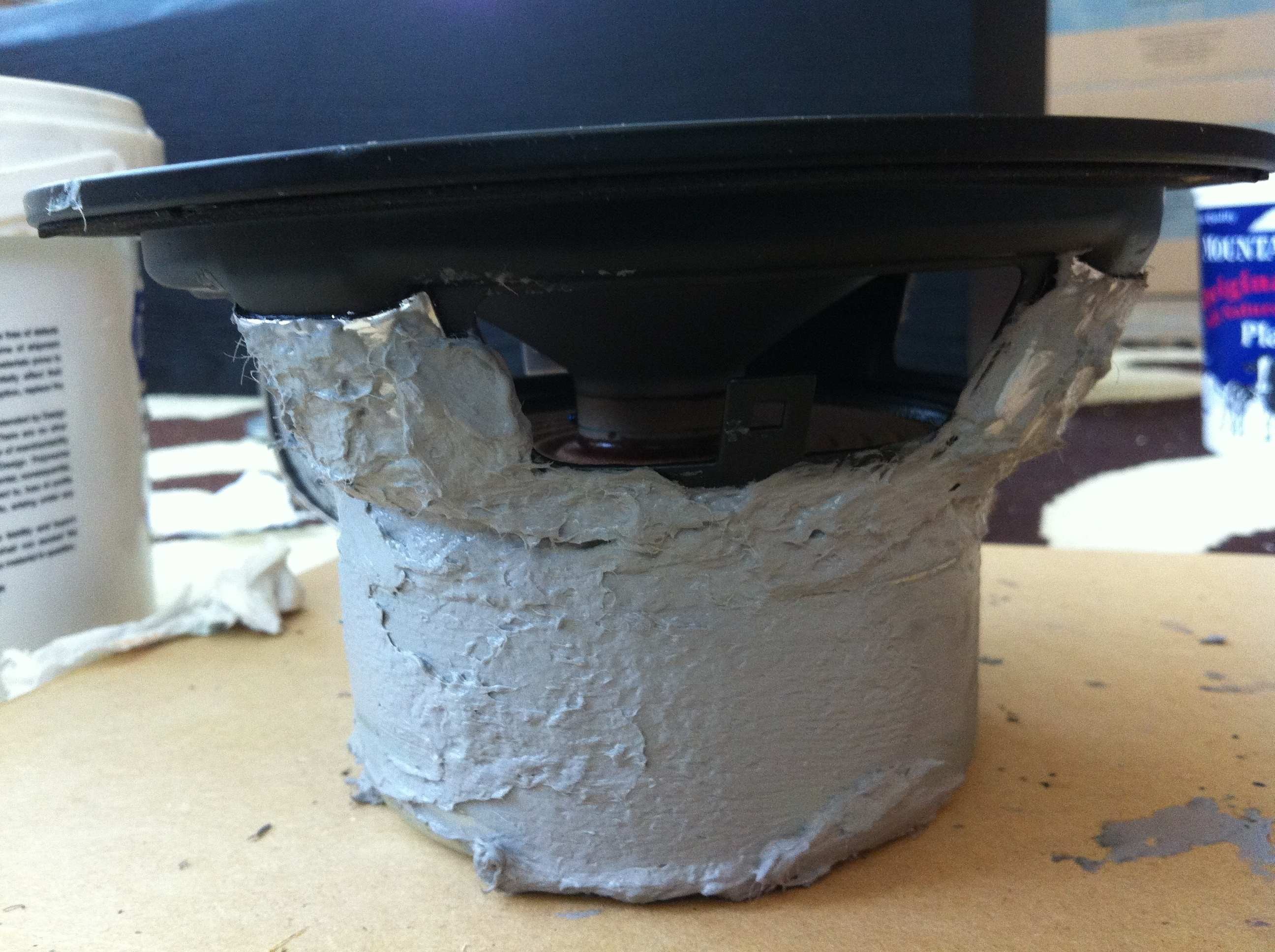

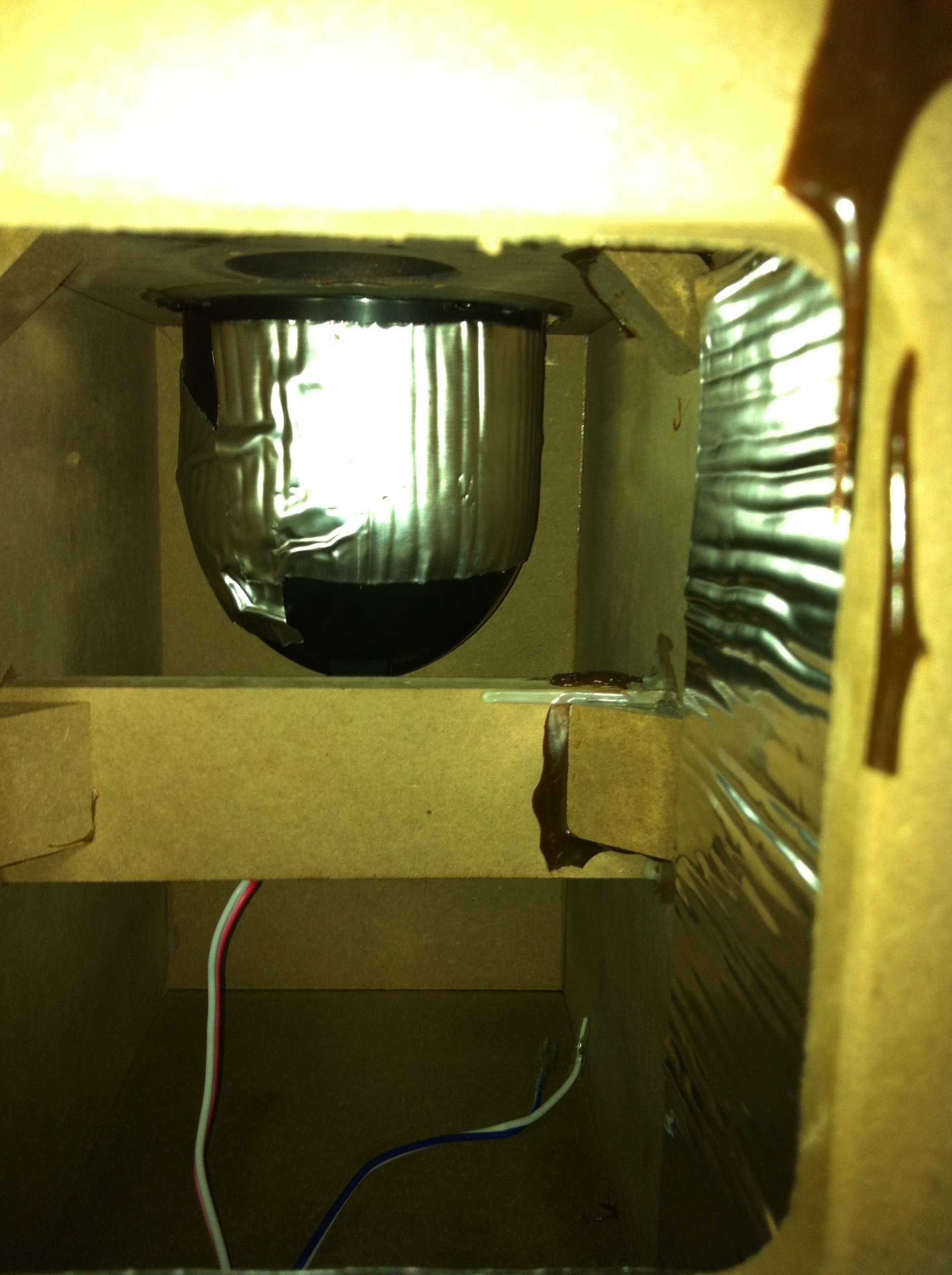

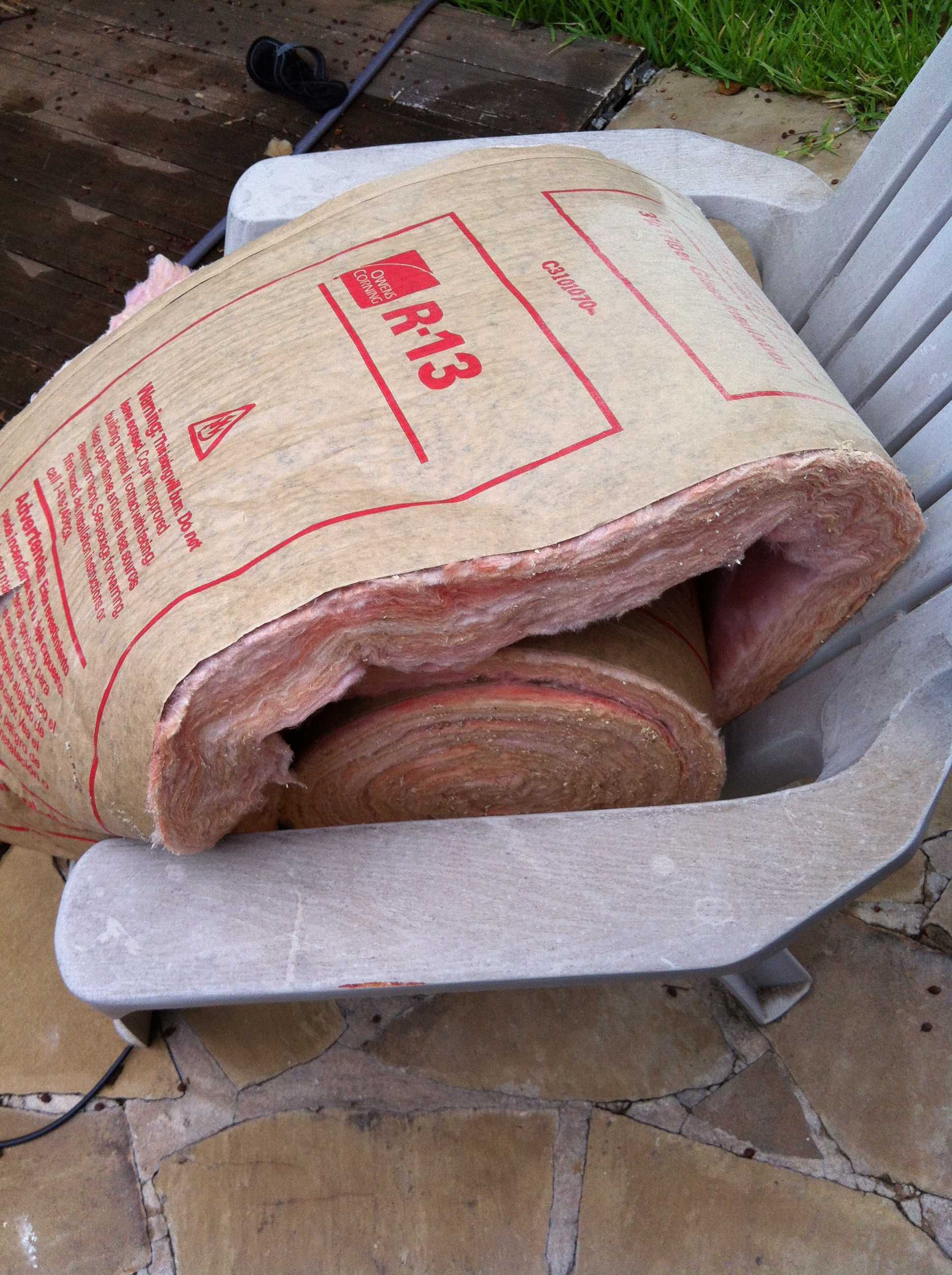

Latest update, I've stuffed the ports lightly with a bit of foam to tame a touch of placement related boominess.
A couple of weeks ago I opened up one of my P363s and discovered that the input wires to the x-over board were not solder in correctly. When I unscrewed and picked up the x-over the red wire dropped off. Only a few strands of wire were soldered through the hole. I decided to replace both input wires with 16 ga. I had to drill the eyelets to fit the larger wire and also soldered the wire to the terminals.
The wires running to the drivers were very short and did not have the room to hard wire them on. I did not have the time to look at the other speaker but plan to do that. Does anyone have a schematic for the x-over? I would like to replace some of those electronic caps with something better.

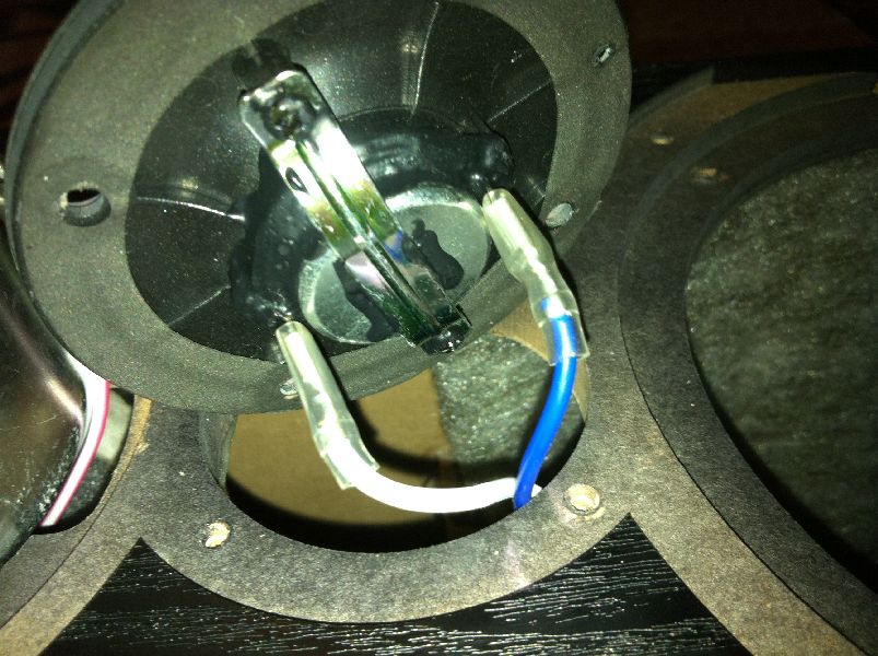

There are a pair of P363's on CL with blown tweeters. Harman shows them unavailable on the parts page and all of the posted replacements I have found are also NLA. Can anyone please measure theirs so I can find a suitable replacement? Thanks
Sorry ahead of time for resurrecting an old thread. My kid stuck her finger through both tweeters. Shaun's tweeter he used to replace his is discontinued. Anyone know what other tweeter I can use to replace mine? Thanks.
The Audax Tweeter mentioned here has a 2-3/4" outside diameter, and the poster modified the enclosure to make it fit. My best guess from looking at pictures and doing some guesstimating, that the original tweeter has an outside diameter of around 3", though it is a 3/4" tweeter. You can confirm by measuring it yourself. The Audax is 92dB, and that is important as you don't want an ear splitting tweeter or a lacking tweeter. XO point from mid to tweeter is 3k Hz.
You can also contact Parts Express or Madisound, sometimes they have already provided a replacement for your speaker and can advise the correct one.

Thanks for the reply. The tweeter including the mounting plate is 3-3/8" at the outside edge. Mounting holes are really close to 2-7/8" (center to center).
I went ahead and got this tweeter Sony 1-544-287-11 as a stop gap until I find a better choice.

Thanks for the suggestions, taking a look at them now. *Just at a first glance they are in the 4" range, so not sure if they will fit without mods.
I thought about just removing the glue from the original tweeter mounting plate and buying something like these and removing them from their mounts and gluing the nut guts in. We'll see how well the ebay tweeter performs first I guess.

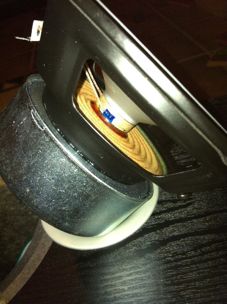

Zobsky, I would try adding a few more braces to your enclosures. If you don't mind the appearance, one good way would be to drill 3/4" holes at the same spots on opposite sides and glue in 3/4" hardwood dowels. Also, stiffening and/or damping the front baffle should yield some improvement. Have you tried using a longer port to lower the tuning frequency?
