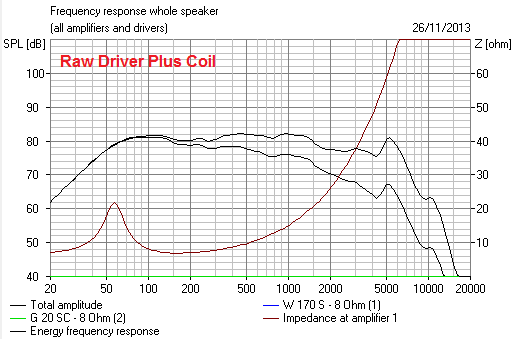

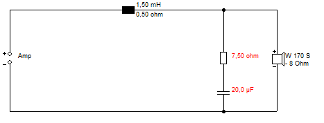

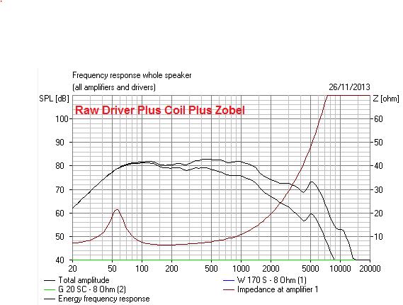

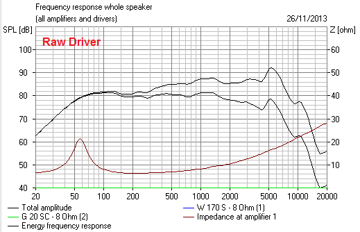

I think some pictures are worth a thousand words here. This is a Visaton W170S 170mm bass unit, 1.2mH Le voicecoil inductance and 6R DC resistance. You'd add the Conjugate circuit aka Zobel, and a bass coil as part of some modelling.

Naturally, where the frequency response changes, so does phase. 😎
In practise, nobody uses Zobels in passive crossovers these days except with tweeters. They don't do much, unless you are using a SET valve amplifier which is sensitive to load. 🙂
There is still not phase shown on your curves...And from what i understand, it seems that slow change of phase along frequency don't change too much response.

Note in the plots posted by System,
the second with single pole low pass filter, the roll-off above ~1500Hz is quite slow.
Compare the 4th plot with both the conjugate Zobel and the low pass filter, where the >1500Hz roll-off is much closer to the -6dB/octave.
Without the impedance flattening of the Zobel the filter does not work as intended.

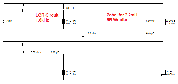

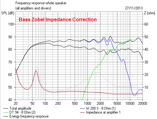

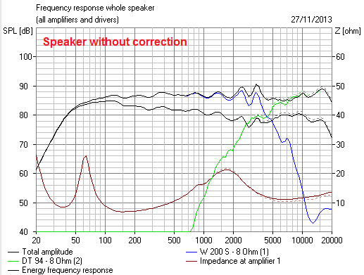

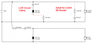

As Michael says, putting a Zobel (Here 7.5R + 40uF for 2.2mH and 6R bass) in parallel with a Woofer has no affect on phase or frequency response. A regular transistor amplifier is a "Constant Voltage Source", and the output is constant regardless of load. 😎
The only reason to use a Zobel is to correct impedance, which is needed with low feedback valve designs. These type of amplifiers will not produce a flat frequency response where impedance varies. With a transistor amplifier, Zobels merely waste power. There is a technique for correcting the approximate 50Hz Fs bass resonance of the system using an LCR but this is rarely seen because the component values are large. More common is correction of the midrange impedance peak, here with a 1.8kHz LCR.
These things are true with active as well as passive systems.
