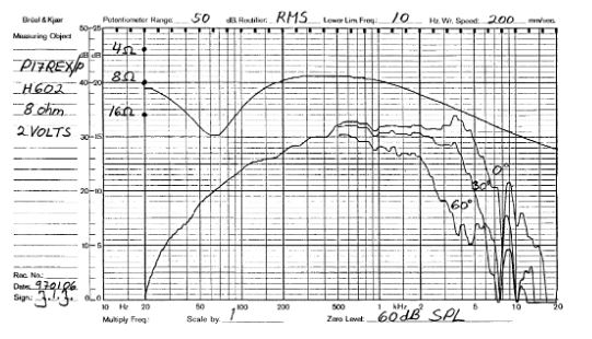

Hi guys,
I'm improving my diy speaker and there has a problem with woofer's sound, too much mid-frequency.
This is my woofer's spec, SEAS H602 P17REX/P.
note: My woofer hasn't any filter, it's directly wired. Only the tweeter has a 2nd order high-pass filter.
So, I've tried to solve the problem till someone suggested me to make a zobel network and then calculate it from the free program on the internet.
But, the programs made me confused when the first site told me to use..
R = 7.6 ohms, C = 16 uF
and the second site told me to use..
R = 7.6 ohms, C = 10 uF
I've sought the truth and found that..
The first site use Re, DC Resistance of the driver which is 6.1 ohms from the speaker's spec sheet, in calculating.
While the other use Rc, the calculated Zobel resistor which is 7.6 ohms, in calculating.
And that's the Rc = Re *1.25
Which one is true ?
I fear that the zobel would be effective only after the lowpass network, which hadn't been used. So it would be in parallel also with the tweeter XO network, which adds itself a change in impedance.

I'd look at a 6.1R DC woofer with a 0.6mH Le inductance, and go for 7.5R and 10uF. I am kinda good at this stuff. 😀

And so does the only Zobel calculator I trust:
Impedance Equalization (L-Pad) Circuit Designer / Calculator
Parts List
Capacitor
C = 10.32 uF
Resistor
Rc = 7.63 Ohms
Not bad, system. 😱
It's a horrible woofer on frequency response, IMO. Polypropylene an all that, but really...what to do with it? :scratch:
Definately needs a bass coil though. Maybe 2.2mH. Can't think about the shunt component right now.
