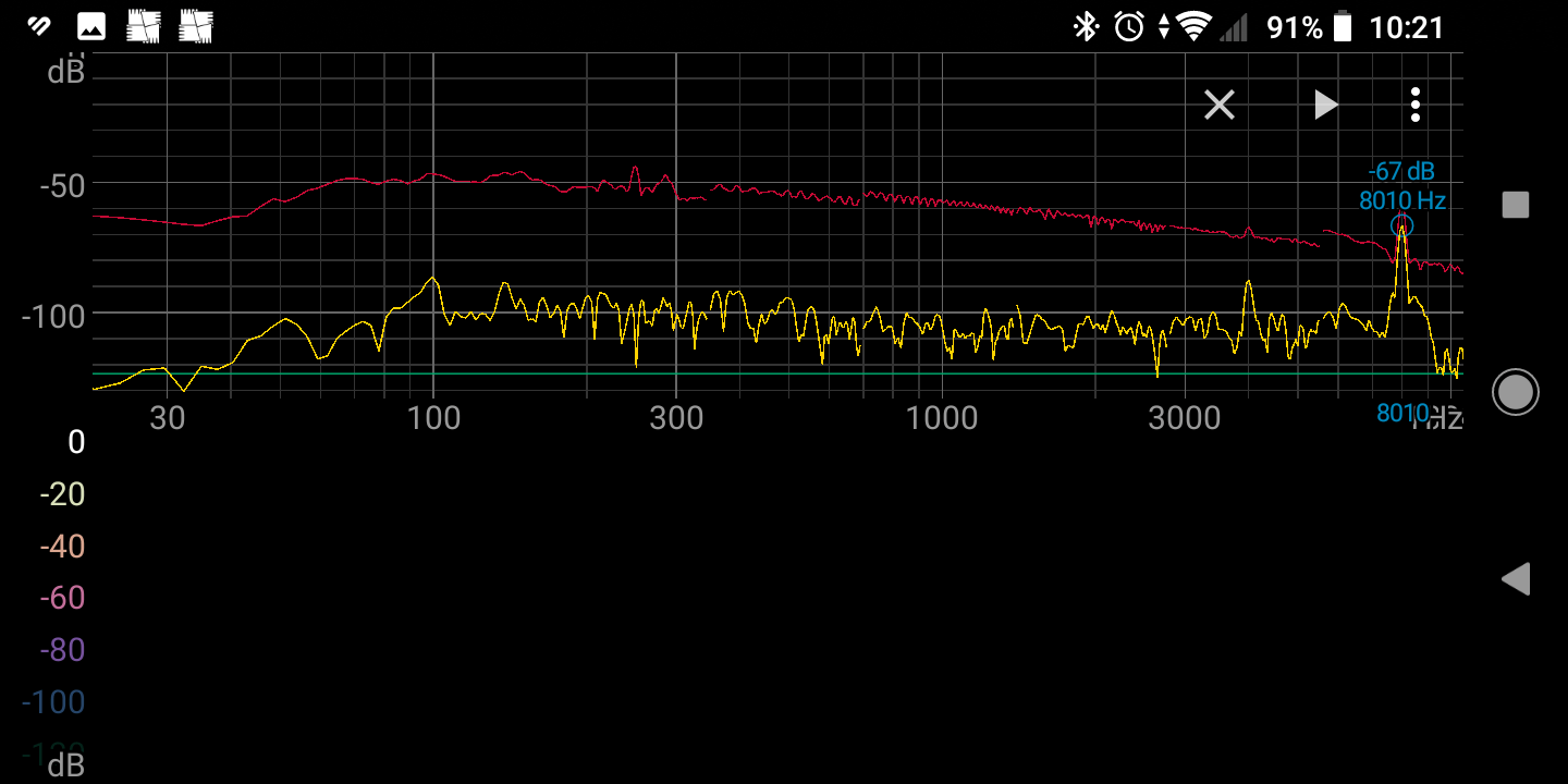

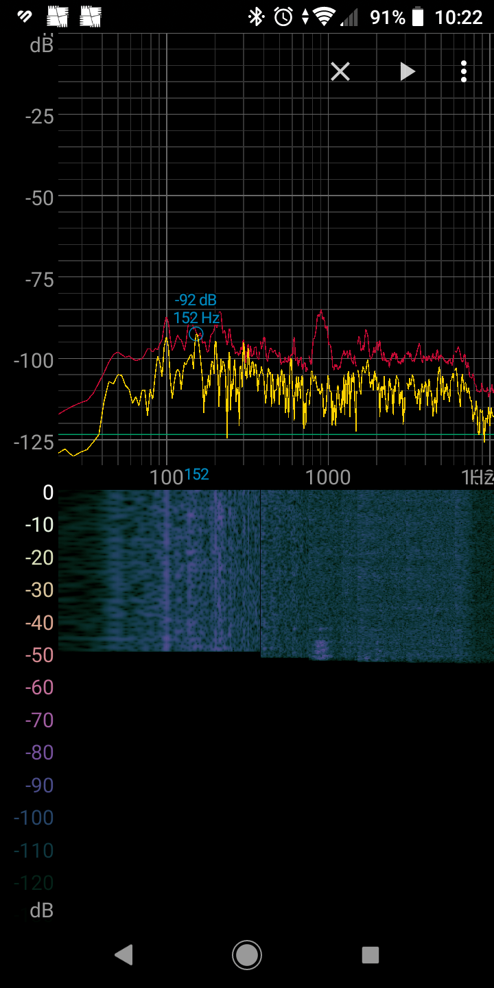

Zobel for ringing OPT 8010Hz
Pics of FR system with and without ringing OPT

Felipe, it's no measurements. It's shot to the dark.
"I see this!"
"What is it?"
Who knows .... with probability 50% it's the neighbour's LED lamp ... or something... or UFO. 😁
Measurement: define the source, define the DUT (device under test), define the load, define the measuring method (with correct measuring set, which is capable to measure specified parameters), define the expected result.
