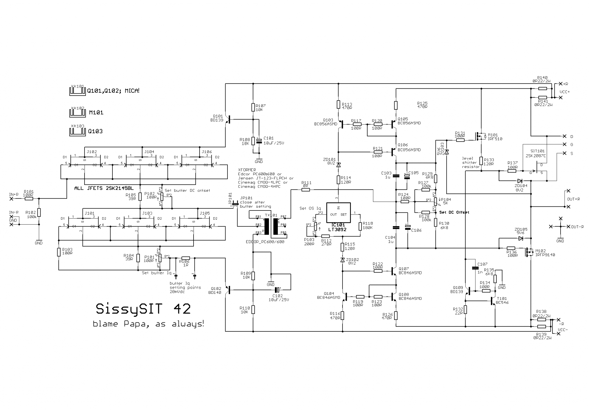

2SK2087C, very Iznogood part!
in SissySIT - comparing to ( origonal THF51S iteration) :
-same DEFiSIT-ish THD Spectra
-same benign character regarding Iq and DC Offset stability ( nothing to write home about, in time/temp/rails fluctuation domains)
- slightly smaller power
- evidently lower THD in entire power range, except on clipping
as I said in origin 2SK2087C thread, I have intention to try them in already (so-so) ready-to-do circuits
- Singing Bush ( why not, combined with IRFP150, little SE)
-Choked Singing Bush ( hopefully that one not being speaker killer during power On cycle)
-Lazy Singing Bush
now just to find some time, soon

I was cheating
DC coupled version being in my pile of files for several months already
as usual ..... it is in my nature (contrary to Pa) to post preliminary schematics, always on verge between All The Glory and Public Disgrace
so, Mighty Moi again ......
pcbs coming soon, so we'll see outcome
- ZM's 2SK2087C musings, phase one (SissySIT as cradle)
