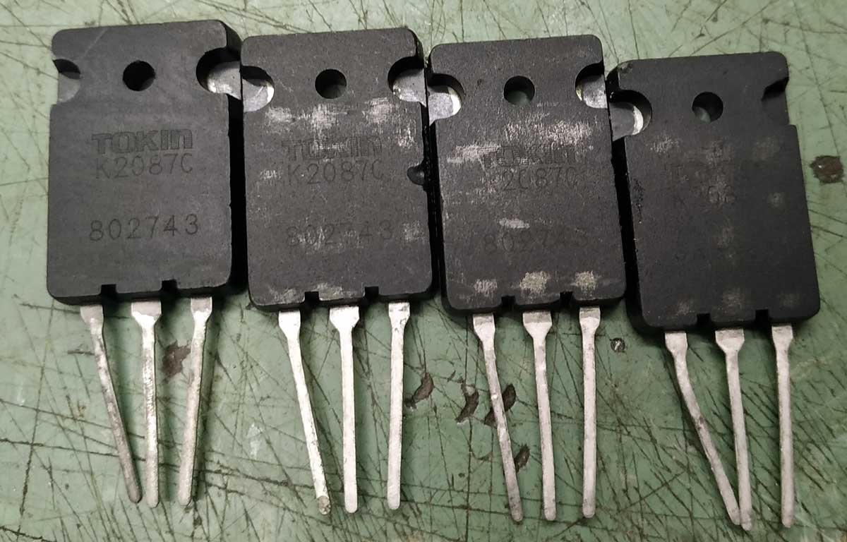

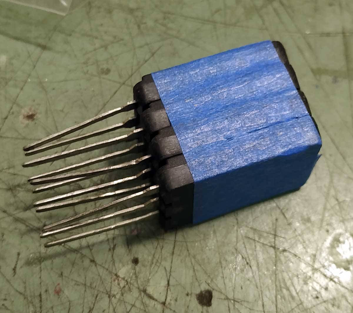

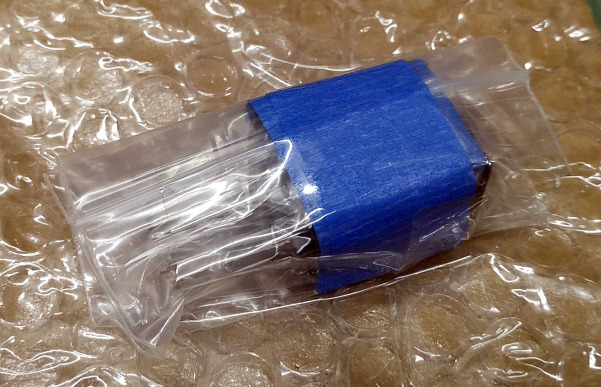

Anyway, CodyT sent me few, and they arrived pronto
Have some more arriving, sent from friendly Greedy Boy from Japan, but they are still collecting dust in my Customs , that will be covered ( along with my official gratitude) when I see them

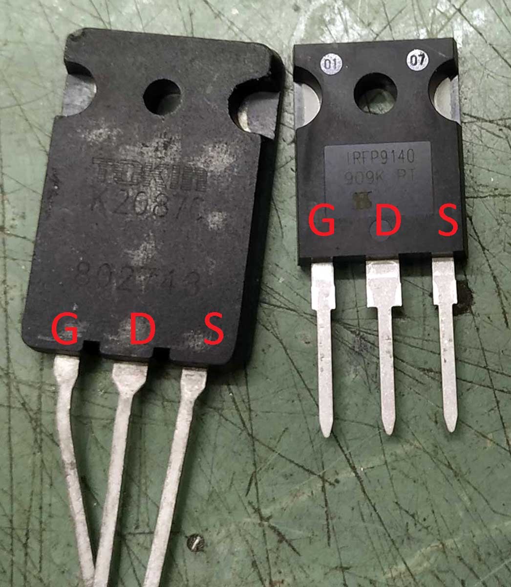

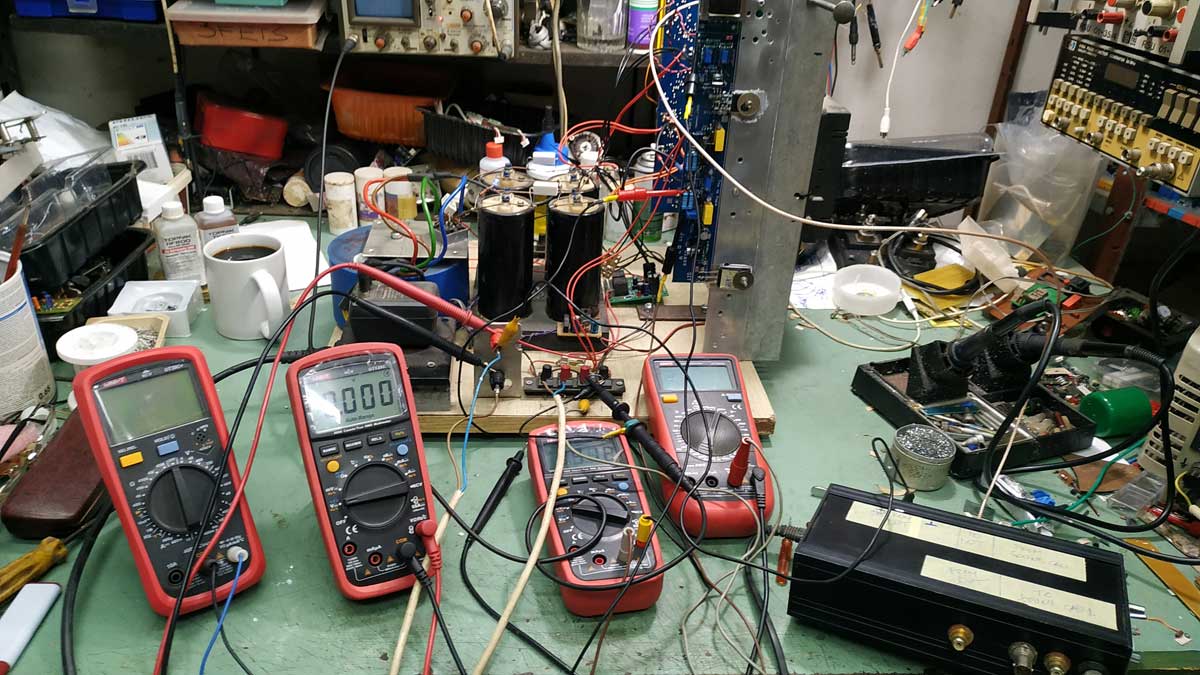

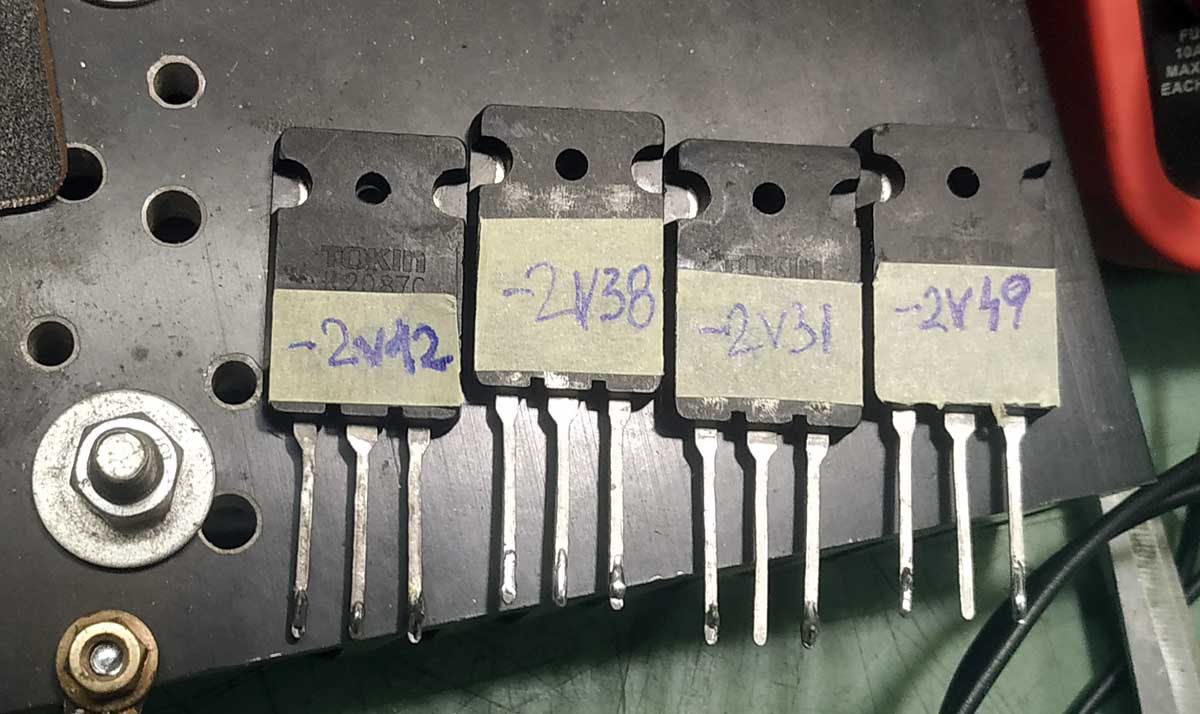

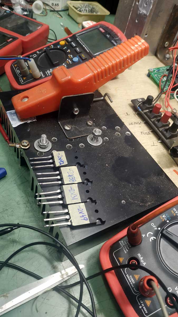

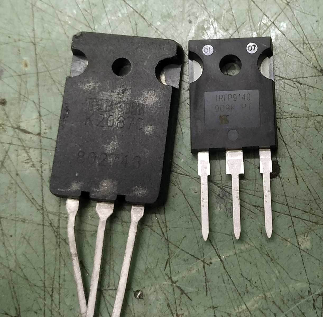

pics of package sent by CodyT, along with basic Ugs measurements (Uds 24Vdc, Iq 1A8, Igate~20uA (0mV2 across 100R gate resistor)
more specific info can be seen in thread linked above
Yeah, impossible to keep low profile, but lets just hope that price isn't going to sky and over
So, officially - parts are Iznogood, everything above 2$/pc is steal and overpriced

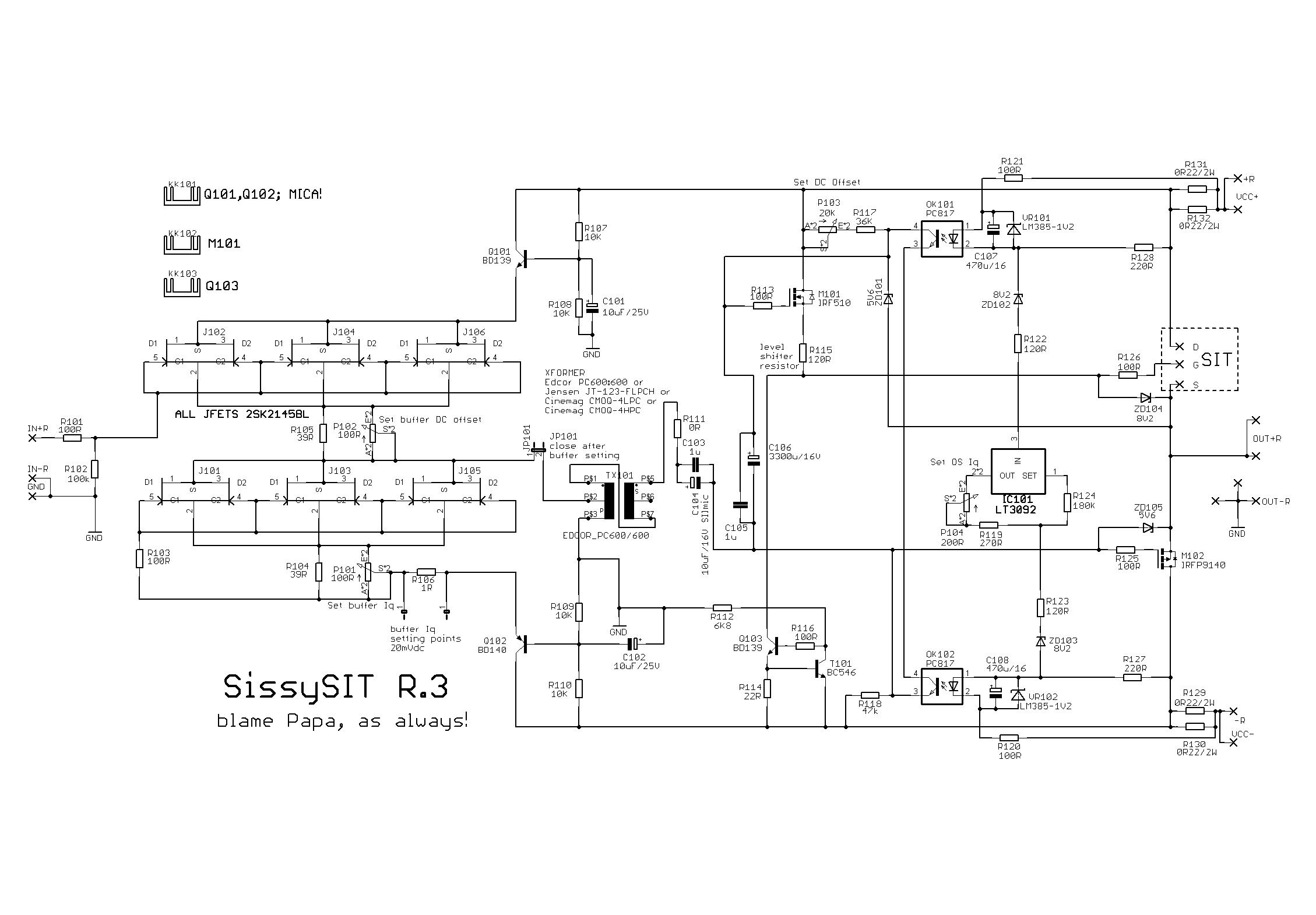

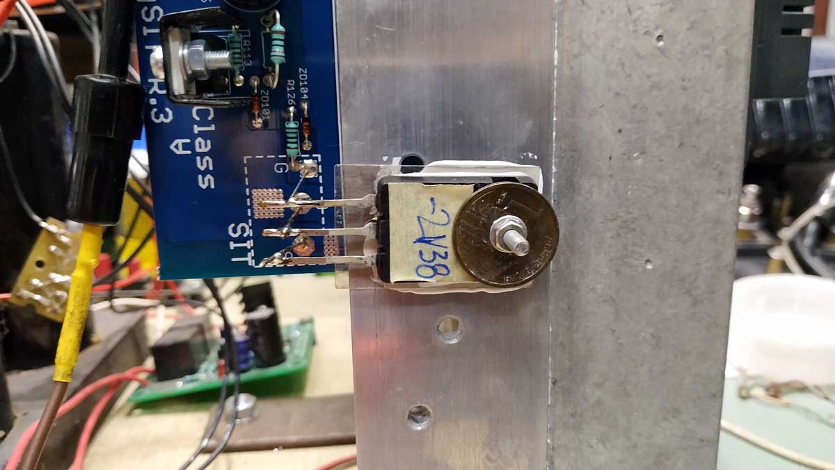

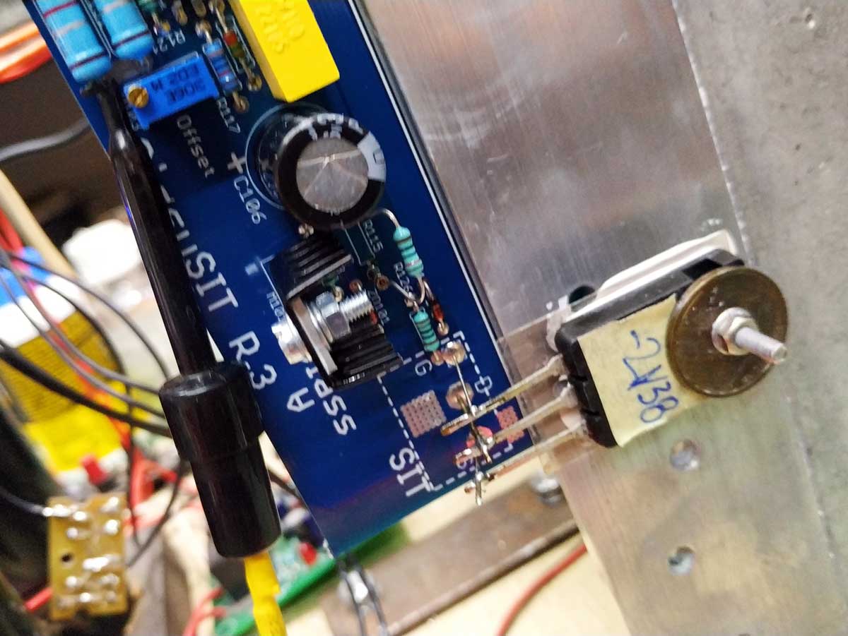

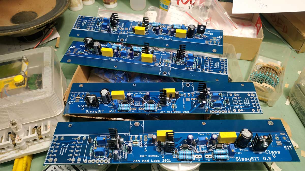

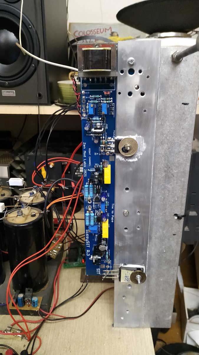

basic schematic shown in SissySIT R.3 thread, also enclosed here
everything the same as original ( THF51S) , meaning 24-ish rails, Iq 1A8
even level shifter resistor (R115) having same (120R) value, resulting in Ug for IRF510 (M101) and IRFP9140 (M102) being both around 4V7, ref to speaker output node
2SK2087C Ug (in amp) of course being in range of value on sticker , again ref. to speaker output

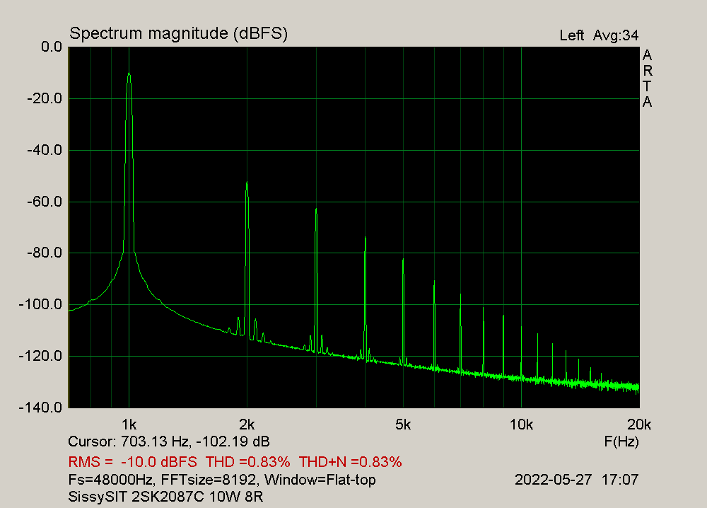

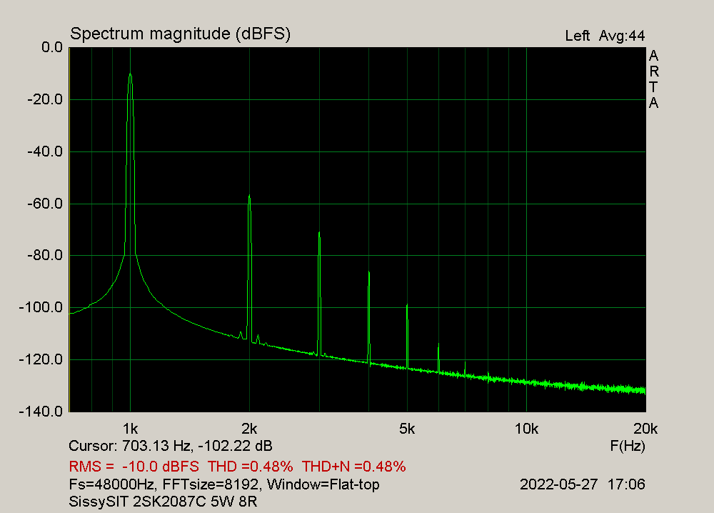

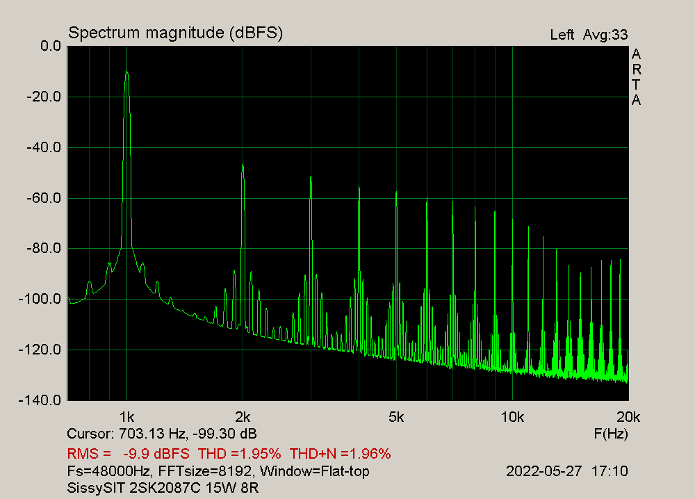

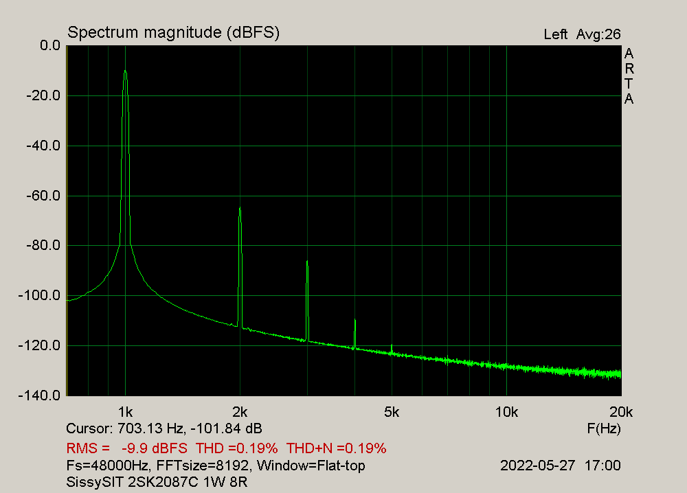

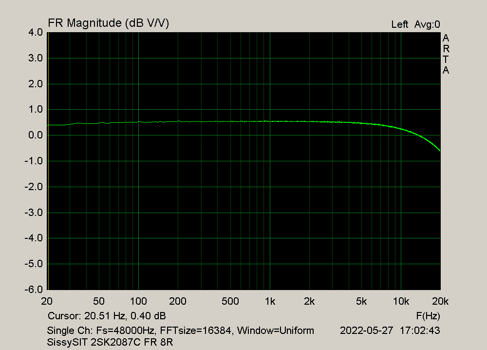

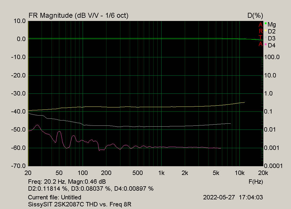

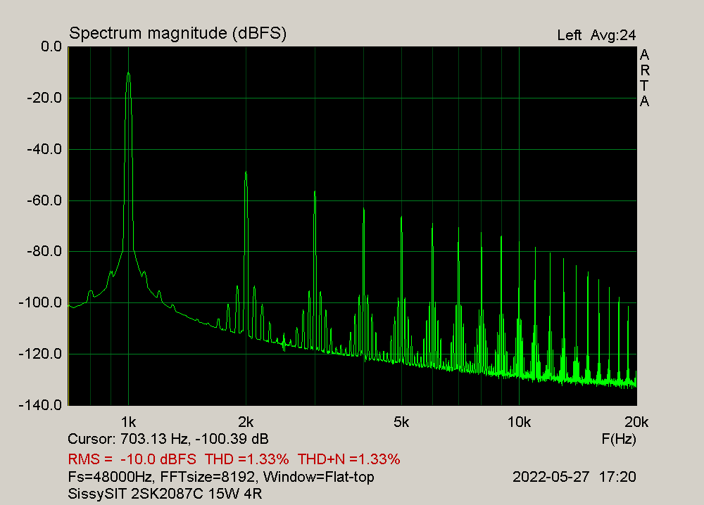

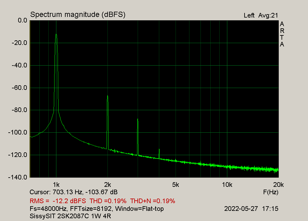

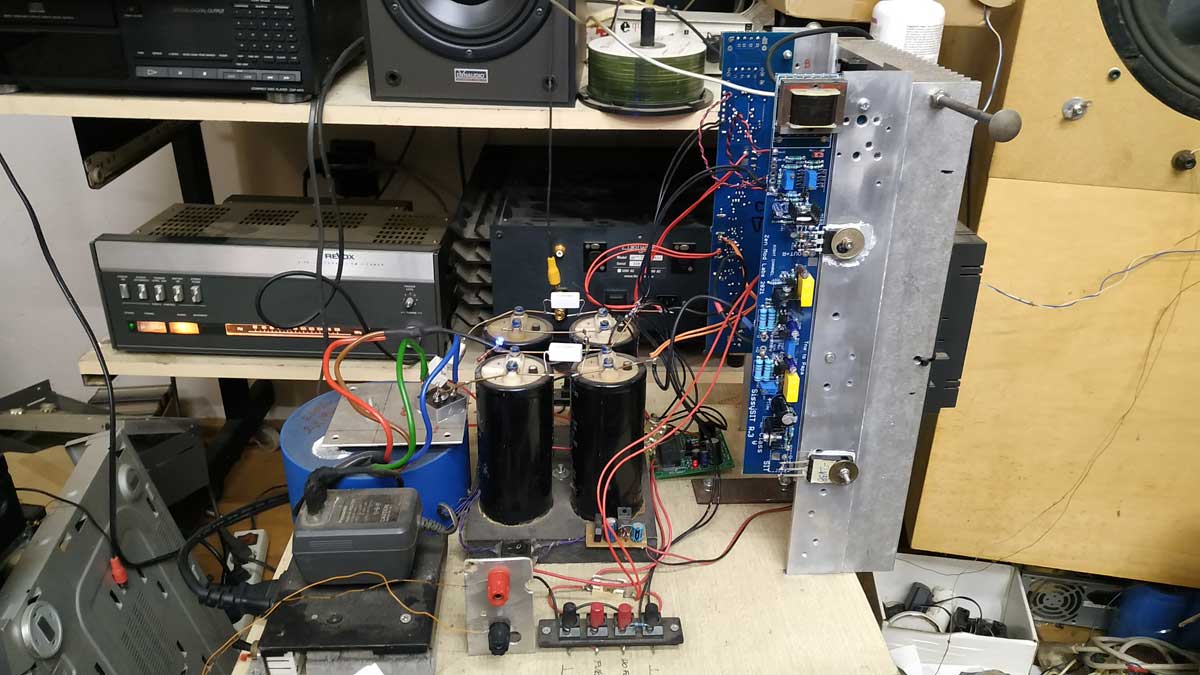

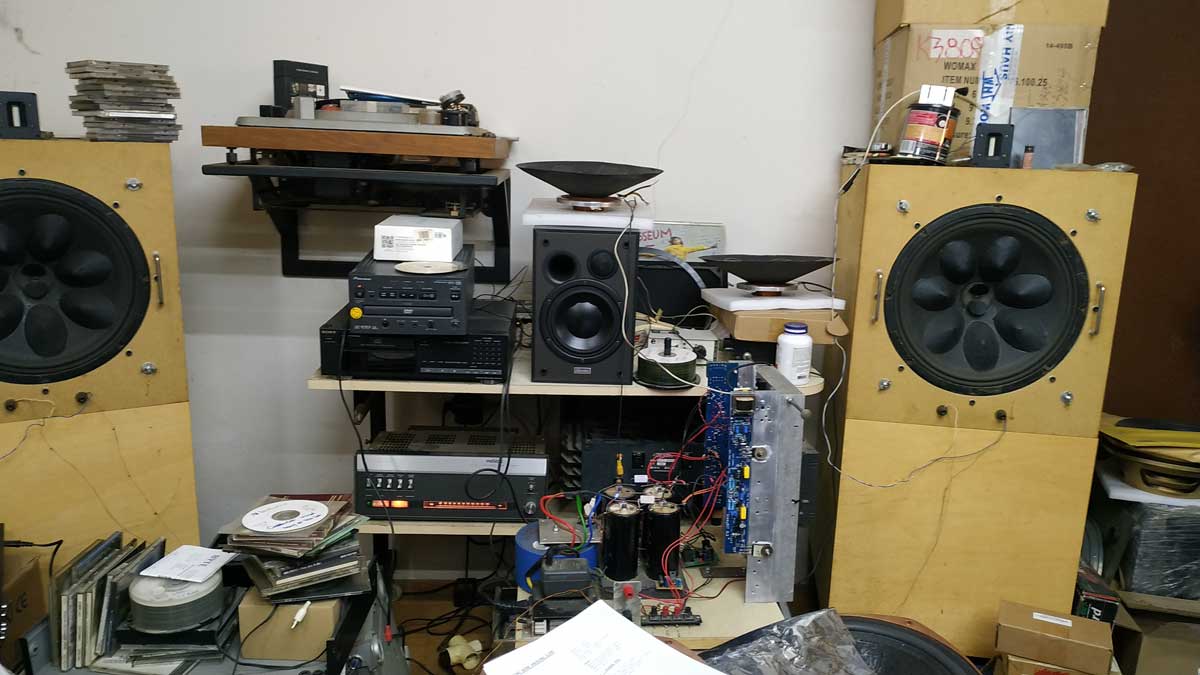

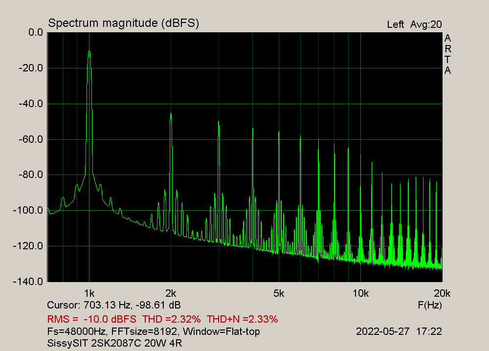

now, Proof is in da Pudding
8R load pics
compare them directly to THF51S , post #7 : https://www.diyaudio.com/community/threads/sissysit-r-3.371272/post-6626308
8R load pics

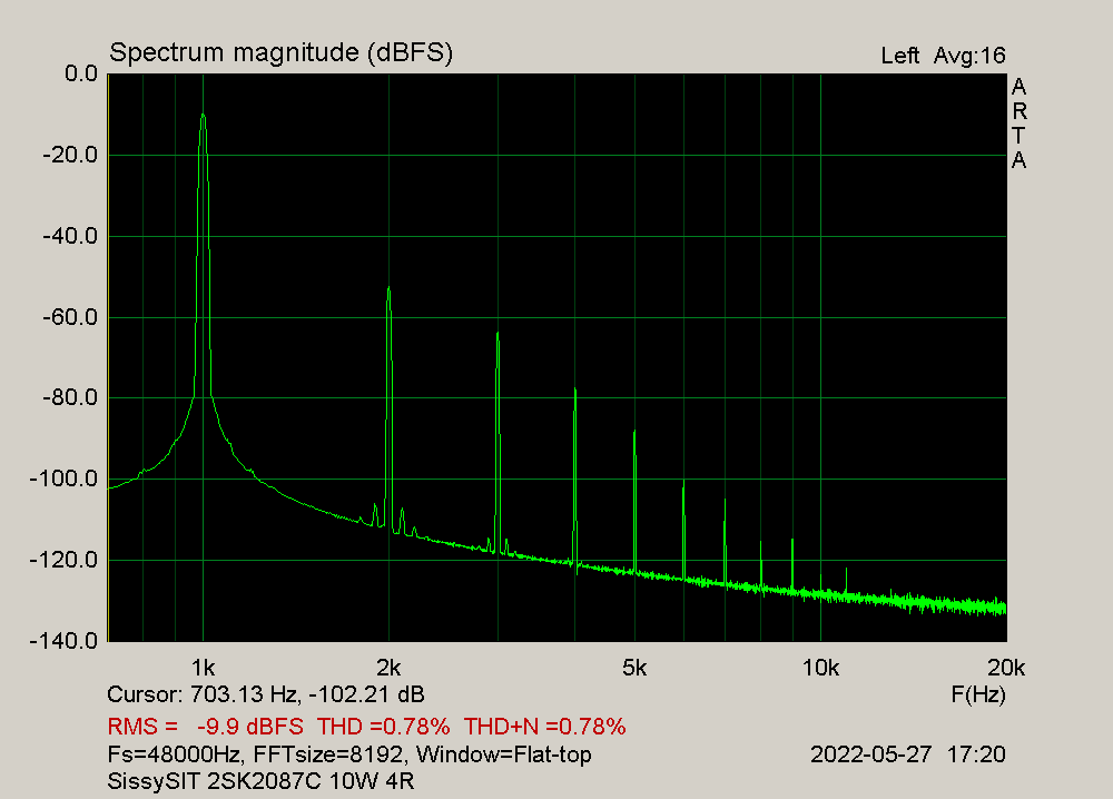

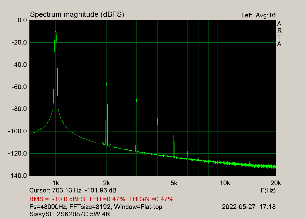

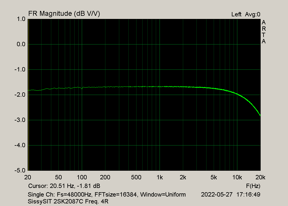

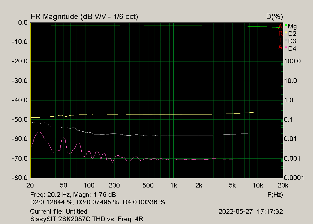

4R load pics
compare them directly to THF51S , post #8 : https://www.diyaudio.com/community/threads/sissysit-r-3.371272/post-6626310
Conclusion:
2SK2087C, very Iznogood part!
in SissySIT - comparing to ( origonal THF51S iteration) :
-same DEFiSIT-ish THD Spectra
as I said in origin 2SK2087C thread, I have intention to try them in already (so-so) ready-to-do circuits
- Singing Bush ( why not, combined with IRFP150, little SE)
-Choked Singing Bush ( hopefully that one not being speaker killer during power On cycle)
-Lazy Singing Bush
now just to find some time, soon
Life is Fun
- slightly smaller power
- evidently lower THD in entire power range, except on clipping

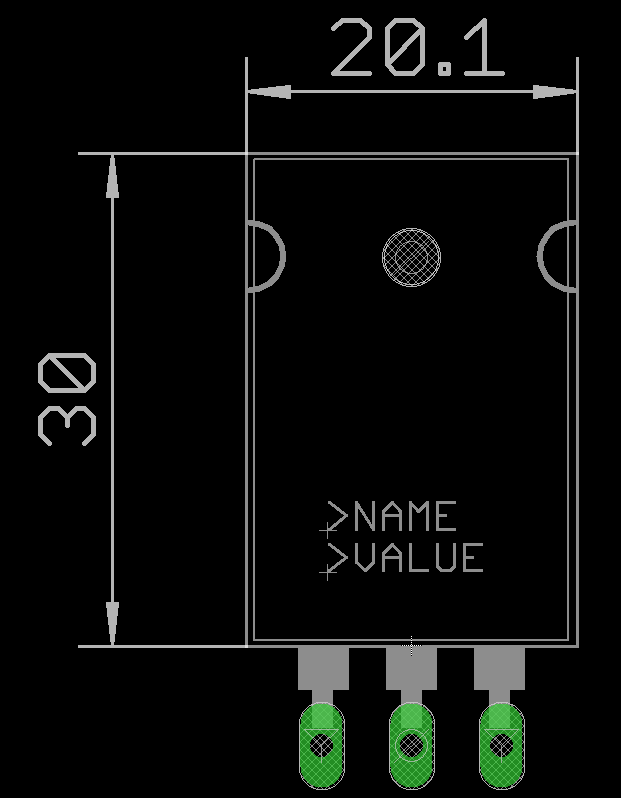

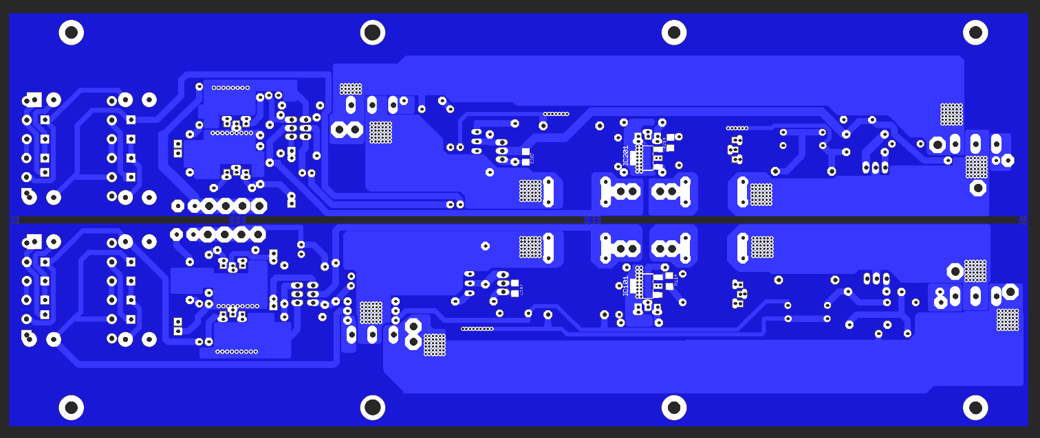

Looks like its time for SissySIT boards with a second to-247 (to-3pl) footprint??
(I know, I know – looks easy enough to bend a few leads... 🙂)
oh, yes, didn't said how it sounds ...... pretty much the same as SissySIT with elevator SIT
maybe because this one is made for small elevators ......

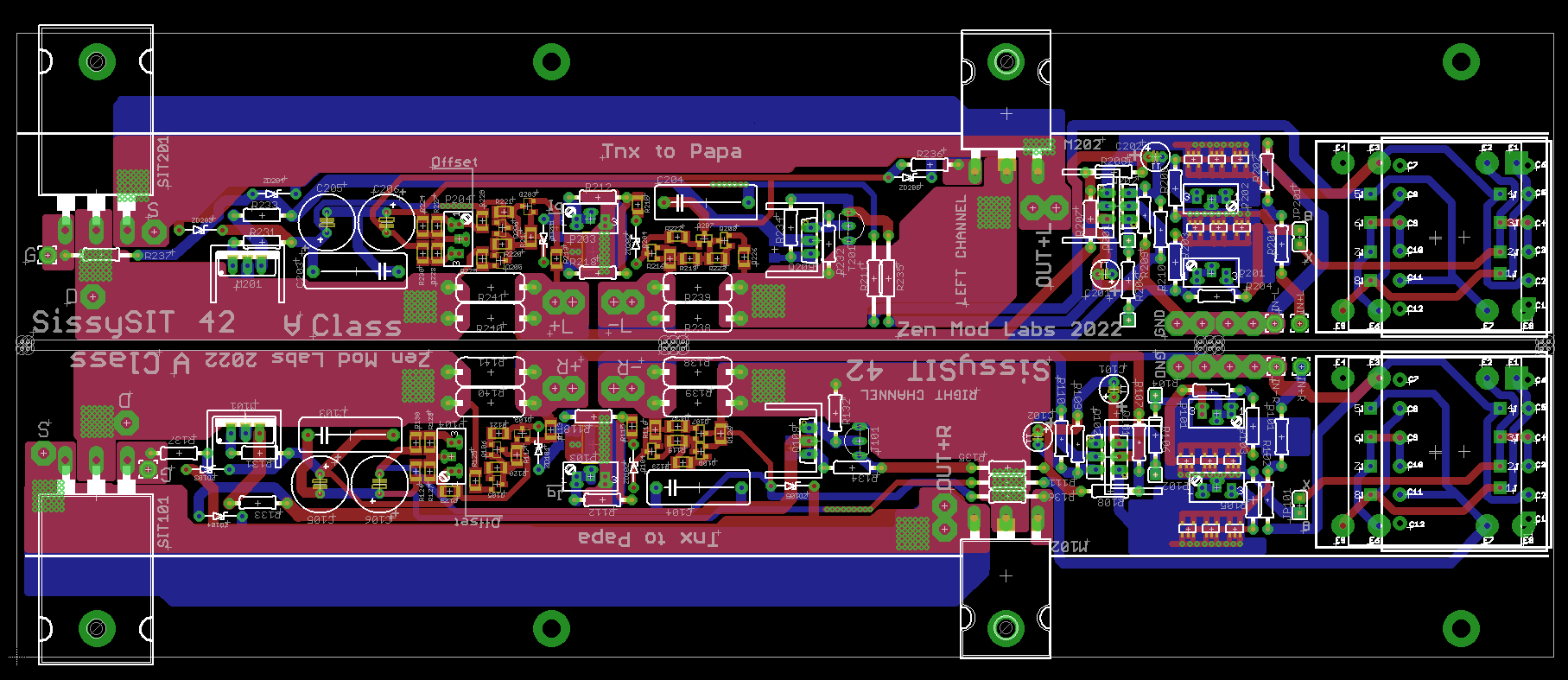

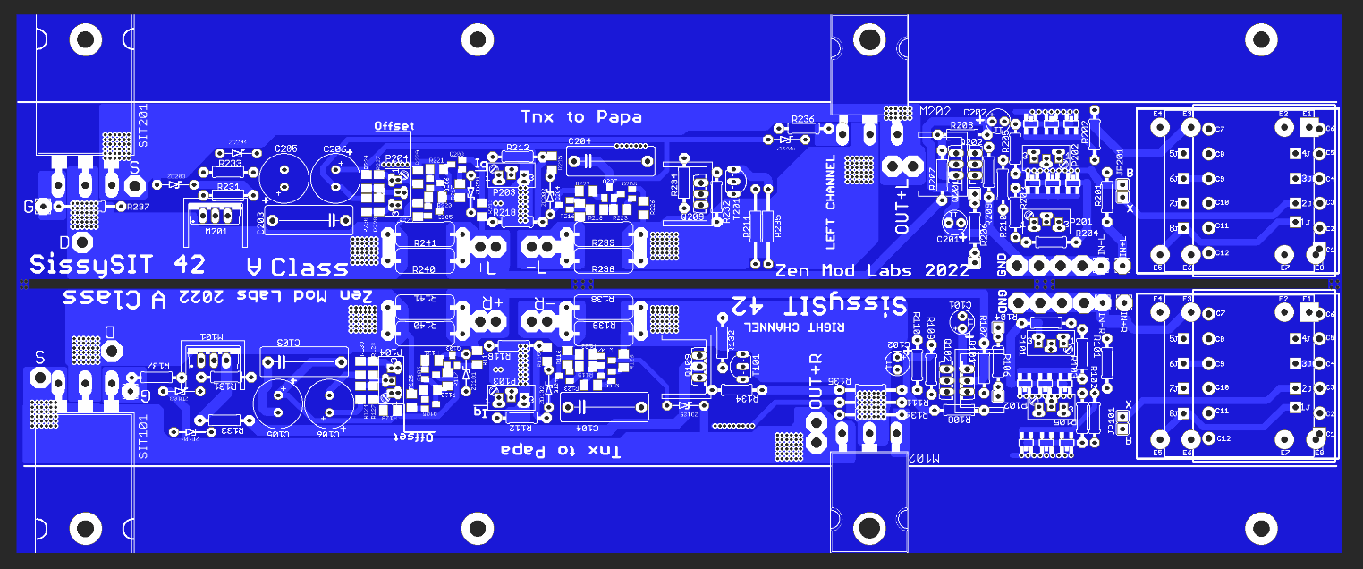

one who knows what curses of curious mind are
even if I said that there will not be special pcb, I couldn't resist to see what's exact name of case in question
and no - it isn't regular TO3P ..... and I can't even find it by designation nor I can even dream of finding one as Eagle package
luckily, I did learn previously how to make Eagle part packages ( did that for Singing Bush pucks etc.), so making one for 2SK2087 is going to be nice evening fun
where it'll be utilized, time will tell
though ....... there is slight glimpse of possibility that completely DC coupled SissySIT with 2SK2087C is one interesting thing to make ......... so yes, even puny 10uF Silmic (in between autoformer and OS) can be tossed out
huh...... as world is needing another 15W A Class amp, fully DC coupled, without loop NFB
I was cheating
DC coupled version being in my pile of files for several months already
didn't pursue it mostly because there is not any significant sound difference
besides, DC coupling done in Papastyle, just another on list called Zillion Ways of Mocking Audiophools
so, making 2SK2087C Eagle package was trivial, cradling it in already made pcb file same level of complication
just another one on the list .......
