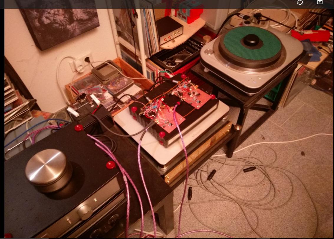

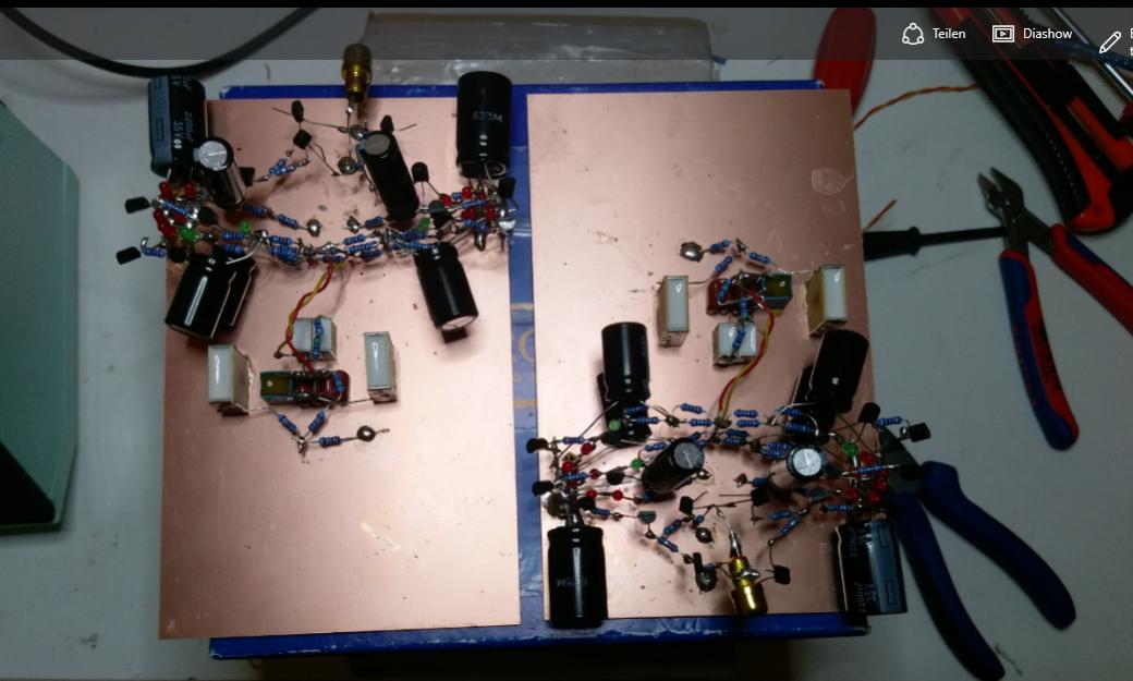

I have the prototype playing in my system !
I am surprised that it was such an easy build. It worked right away after eroding some little bugs.
Hum is more or less non existent when i earthed correctly.
This version has an INA at the output to do the Bal-Unbal conversion. The only " special " thing i did is the way i biased the input of the INA. It is like Bruno did in in the Linear Audio preamp.
Set up this way hiss is lower then in the version i published before.
Frans has an idea how to improve on the INA and keep the low noise.
The sounds seems fine too. The main thing that i noticed is that the bass is very potent.
That can be my implementation of the RIAA that has a little bass lift, maybe 0.5dB.
I did not have the excat values at hand that Frans calculated.
A little left turn on the Subs volume solved that issue.
A question came up if we can make the gain adjustable. What i whould really like to do is some kind of volume control that has Bal and Unbal out. Then we have a stand alone unit for all purposes that does not need a preamp. The volume control could also be used to EQ volume diffences in the cartridge if there are any.

HI,
if You use a ´3-OPAmp´ INA (unbalanced out) its easy to vary gain with a single resistor between the inverting inputs of the INA´s two input OPAmps.
To generate balanced outputs I´d use two INAs in parallel (the second just with its inputs crossed).
Then a Dual-pot or pairs of discrete resistors would allow to vary the gain.
Feeding the ref-inputs of the 3rd OPAmps of the INAs would allow to DC-servo the INAs.
