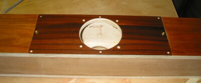

Pics

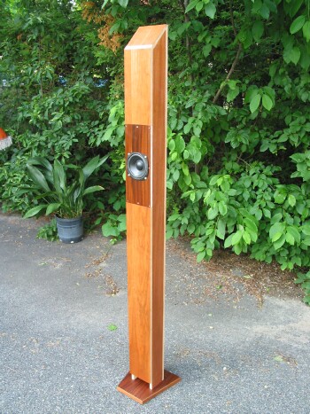

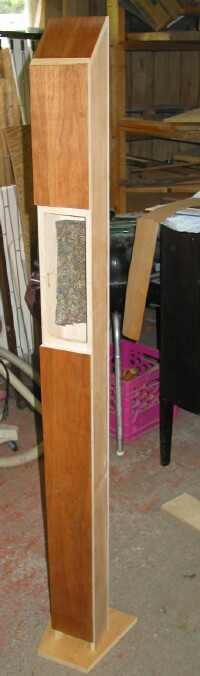

Previous pic showed the removeable front panel, so that I can use different drivers. There's a hole in the top section at the back as well, covered with a plate. Removing it, will allow me to transform it in bipole, while the different front panels allow me to equally try the Philips with whizzer.

Re: Pics
A big one 😀

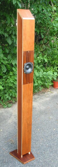

What driver is that in there now? Dust cap looks too big for an 1197.
dave

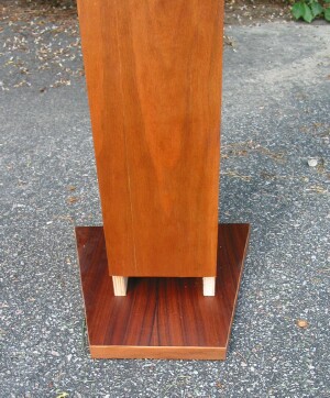

Sylver300B said:I didn't know what type of foot could bring some stability to this tall slim pipe.

FE103A or those Philips things?
BTW, I would suggest avoiding spikes. They create a resonant cavety under the cabinet: not what you want, especially with a TL, even one like the Zigma, which is not known for its ability to create high SPLs.
Try this instead: veneer a small-ish paving stone with some cheap iron-on veneer. Better yet, as the footprint of the Zigma is small, just use a nice cheap marble kitchen chopping-block. Apply some Blu-tak (or whatever equivelent you can find) in sheets to the bottom of the Zigma cabinet (so that the base is completly covered with the stuff), then press firmly down onto the new base. Instand solution to stability, and it'll improve the bass and mids too as it'll all but eliminate this source of cabinet vibration.
Works for me at any rate, and I've tried the same technique with quite a few different speakers now. All showed a marked improvement over both un-spiked, and spiked forms.
Just a thought.
Best
Scott

Re: Re: Pics
Hi Dave,
The driver is one that I took with me in the garage, so that I wouldn't risk damaging the Foster ones. They have the same dimensions.
A friend of mine gave me 4 of them. He used them as mids for a HUGE system he has in his basement.
No trademark, model: YDD-103-1, it says: 50W, 8 ohms, 0 - 10khz and they are priced at around $6.00 u.s. (big magnet, paper cone, covered with some glossy product..) Looks alot like the driver that was used in the Minimus-7

Zigma stand
Well, I didn't think to the resonant cavity underneath.. Makes sense. I thought about building a base with 2 layers, filled with lead shots.. but your idea of some marble or stone block.. humm.. quite inspiring. There are a couple of granite plants in the area, I'd bet it would be cheap and nice..
I'd be concerned about the use of lead shot unless it was encased in something to prevent audible vibrations (i.e. resin, straight white glue, whatever).... Would be great if whatever the weight-providing-source was could be removed when you move the speakers. Kind of a slide-lock mass-in-resin.
I do like the marble idea.... and blutak has got to be the speaker builder's secret weapon. Easy to remove the weight, looks good, but rather pricey.
Funny that I've read on TL designs for years and have never seen a discussion of feet/spikes that was unique to TLs.

Makes sense.
With the other, there's a number of options other than Blu-Tak of course. Here in the UK, I spent about, oh, £10 on 4 packs to cover the base of my last set of straight ML TLs. Children's play-dough also works, though not quite as well; a more perminet type would be some sillicone sealent. The Blu-Tak or White-Tak etc has advantages though in being re-usable.
I dislike spikes in general for all forms of speakers, unless, like the new Bosendofors, they have been designed with specific resonant features from the outset. The same trick works well with BR (especially BB4 alignment), IB and other designs, but is especially useful for larger quarter-wave types which need as dead a cabinet as possible -not something readily achievable with them standing on spikes (and another point -these are usually made of some form of metal yes? Metal resonantes badly; at different frequencies for sure, but usually somewhere in the audio-band.) with a resonant acoustic cavity underneath, allowing vibrations back into the cabinet structure.
Another idea is to build a small-ish sand-box to stand the speakers on; works fine; but no real advantage over the marble / Blu-Tak method.
