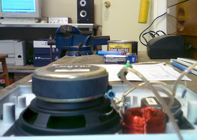

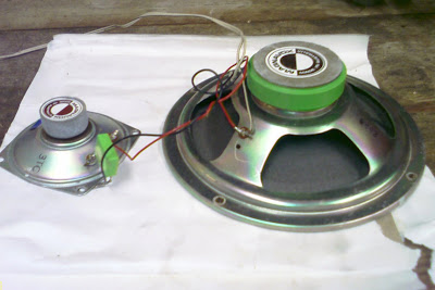

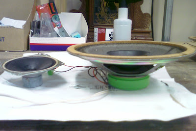

yea, they look pretty average on the outside, but they have this big **** magnet on the back, bout the same size as the cones, so I thought they might be pretty good in a larger enclosure of some sorts, as they do pump out quite amazing sound for the volume...
I also have a pair of drivers from a 70's turntable/radio unit that where in huge chipboard speaker box's (rotted), magnavox...
200mm main driver, but pissy lil magnet on it, but one of the frugal's designed for a 200mm driver would look too large in the 'wifes lounge'.
I want minimal impact (visually & wallet ) with maximum impact (sonically) 🙂
tops of magnavox drivers:
Sides of magnavox drivers:
underside of magnavox drivers:
and yea, sure I can purchase some new drivers, but the object for me is diy with minimal outlay, as I have now got 2 offspring 1 @ 3.8yrs & 1 @ 0.5yrs, so all my money is pumped into living atm...
pine/mdf/hdf is not the problem, as it will cost 1/2 the price of a single fe126.
but all else fails, I will buy some drivers, IF I do it will probably be some fe126e's for upstairs in a zigmahornet and some FE208EZ in a frugal spawn for downstairs, but atm I have a few sheets of 16mm mdf floating round (left overs from building my bass traps & 3 meter curved projection screen frame), so trying to get some ideas, as I really know naff all about speakers specifics, but always willing to learn.

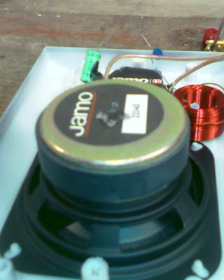

found a bit more info on the jamo's from here: same as the black ones:http://www.happymedium.com/specials.htm
Type Sat 300 II
System 2 Way bass reflex
Woofer 4" - 102 mm
Tweeter ¾" - 19 mm
Power Rated 50 W
Sensitivity (2.8V/1 m) 90 dB
Frequency range 80-20000 Hz
Cutover Frequency 3500 Hz
Impedance 8 Ohm
Total Volumes litres 3.3
Weight kg/lb 1.4 / 3.1
Dimensions (HxWxD) mm/in 210 x 153 x 102 / 8.3 x 6 x 4

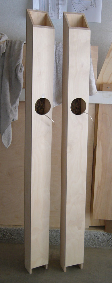

a weekend passed, the Zigmahornets are (almost) ready...raw mdf, because I'm still thinking about the finish.
The "couchtable" got some colour and sounds great 😀
lg
MM
I see u cheated and did not slant the top, was this just a gimmick?
gychang
Hello gychang...
I did slant the top...inside!
Two reasons for that...the finish is easier and it looks better (to me)

larkinrulez said:Hello gychang...
that's clever, thanks,
gychang

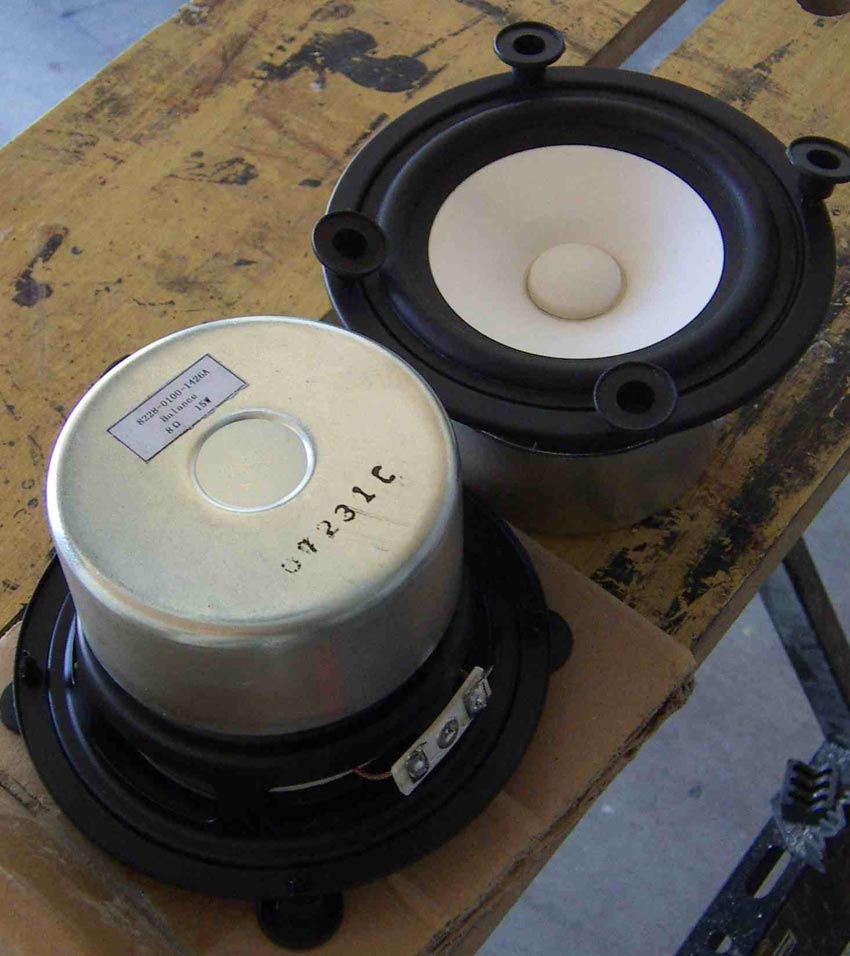

I had to adjust the picture quality... Handsome speaker. Made in China, 8Ohms, 15W on the back of speakers.
gychang
You buy them directly from Dave Merrill (d'Charles Audio).
He imports them 50-100 at a time from a Chinese manufacturer -- he is a one man operation and i don't think anyone has actually done an enclosure optimized for these yet. Looks like a decent alternative if you can't afford CSS FR125SR or modded Fostex FE127e. (i've not yet talked Dave out of a set)

I had inquired a while back about Merrill's drivers. Last weekend while I was away I received an email back. Here is a portion of his email:
If you want a pair of those drivers, you should email him soon & hope he has enough in his current shipment.
And I certainly wish all the best with his medical issues.
Cheers, Jim
