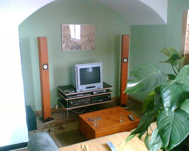

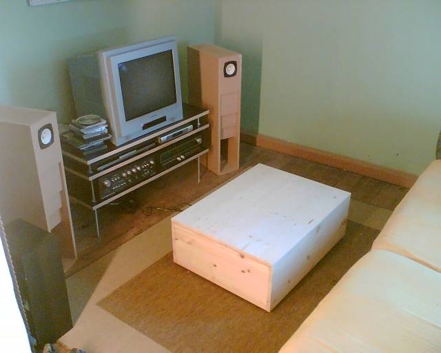

shure...next week...ok, here my "before-pics" ;-)
at least you can see, why I have this "baseproblem"...over the TV is a...can I say bow-ceiling?

Your acoustic situation as far from ideal - no wonder that you have bass problems. In situations like this I only was lucky with sealed (infinite baffle) loudspeakers, mostly even very small (like the Linn Kan or the LS3/5). In an cave (sorry..) like this, you - IMHO - will never get decent bass, it will always be too boomy and therefore out of tune and rhythm. I have diificulties to imagine that the Zigmahornets perform well in this situation, because they use this bass reflex cum tuned tube method to get more bass, which may interfere heavily with your room resonances. But maybe also both "effects" cancel themselves out...
(I can easy imagine that you do not like a subwoofer in that situation...)

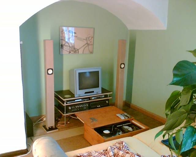

edit:
finally 🙂
