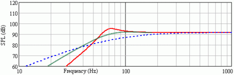

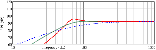

Are the angles still the same for the deflector on the Venom (41 and 49) or are they diff since the box is a little bigger?
Red Line is the sim, green line is my rough guessimate based on the sim of where it ends up once the high aspect ratio port comes into play... the horn loading might lift it a bit more than shown. Scott?
It also illustrates one of the reasons why the FR were removed from the plans page... (we are working on a side-bar so that people can make their own guesstimates)
