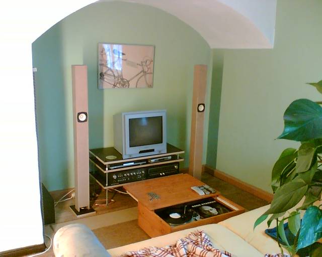

SO i bought all the wood today. Had a cabinet shop cut it for me. I told them i would to the angles, but for the life of me i cant get em fig out. So i was searching around and saw this pic from larkinrulez. He just flat top his zigmahornets. Y cant you just do that instead of doing all the angles. Does it have any effect on sound?
Hi tigh4life, speaking strictly as a fellow newb, I don't see any disadvantage to a flat top.
I simulated the enclosure in Martin J. King's software, and the enclosure does not seem to provide any low frequency support (in other words, it's just there as an infinite baffle, to prevent the cone's rear radiation from canceling out the front radiation, thus the dimensions and angles aren't all that critical). In this cab, and in infinite baffle, the bass output is apparently the same -- a rolloff at 100Hz.
But people rave about the sound because the narrow baffles provide fantastic imaging. Personally, I'd make it flat myself while people better at woodworking might make it angled because it looks cool. I don't think there's any sonic benefit. But keep in mind I haven't built it, this is just one person's opinion, and let's see what others have to say.

Thanks for the input. I dont see y it would be an issues but this is my first DIY speaker build of this sort. Ive built tons of car audio boxs but those were for subs, not fullrange
It's cool that you build subs because I think you're going to want one. 🙂 Unless you're listening to certain types of acoustic music. Anyway, let's see if we can get a second opinion.
And ive got plenty of them. I just read a few postings about flat topping them and no1 really seems to have a definitive answer about y its a bad idea to flat instead of slope them. But i dont wanna waste my time is a slope is gonna sound better
I've got a pair of Zigmas. I don't think the angle at the top is going to have a large impact. I not even sure this design is anything more than aesthetic, really. Personally, I found these speakers to have some serious short comings - first being the bass, second being the (lack of) a crossover mating the driver to the enclosure. They are pretty speakers (esp. with the angle on top), but could use a lot of work. I bet the roll off closer to 200Hz, which makes them seriously limited, and the frequency response has a large tilt upwards (due to baffle step and the drivers raw response). I think someone described it as 'melt your ears' (thats a little extreme though).
