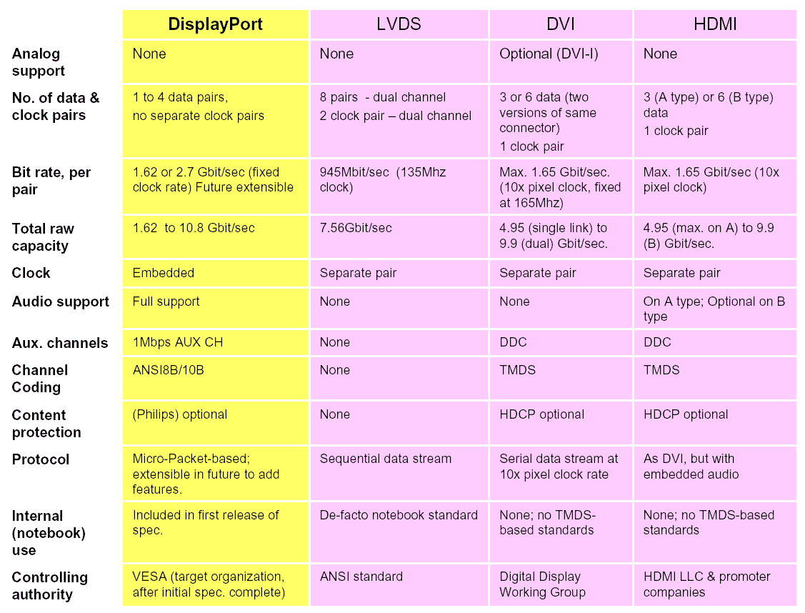

New DisplayPort
BTW, VESA just endorsed the new A/V connectivity, DisplayPort 1.1, which is royalty-free.
http://news.digitaltrends.com/article12599.html
Comparison chart : DisplayPort v.s. HDMI
http://www.audioholics.com/educatio...portdvihdmicompared.gif/image_view_fullscreen
Hopefully, we will see the DisplayPort on the coming audio devices. Zhaolu D5 ? 😀
