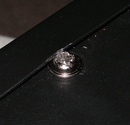

I took some images of the chassis problems. This is a screw that is under the backplate. I found it odd because there are two screws under the backplate, but the other has a neat notch cut out to accommodate the screw. This image also shows a mangled screw. There are many in this condition on the bottom side of the Zhaolu.

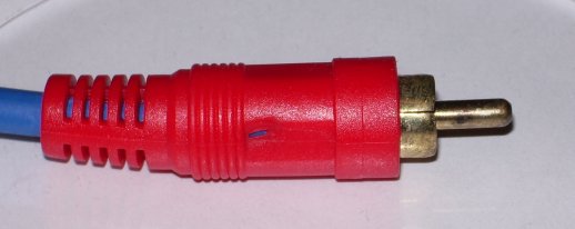

Finally, this image shows the puncture wound in my included coax cable, as well as the corrosion on it. All these are not things I would expect to see in a new commercially made product. Then again, I think this may be the first thing I have imported from China. I must stress that none of these things affect the acoustic performance which is excellent. I have also found a good use for the included OPA2604 IC's. I replaced the very cheap JRC4580s in the headphone amp with them!

None of the screws on the outside on mine is mangled like
that one in your pic. I haven't opened mine up to see
what it's like inside.
Can you point to where you put the chassis to ground
connection?
My cheapie coax has corroded connectors like yours
though I didn't spot any punctures. I too was suprised
to see opamps floating in the optical cable packaging.

Adding ground connection was actually very easy to do. I tucked the wire under a standoff that holds up the AC input board (RF filter?). Just loosen the screws, wrap the wire around the screw, and tighten them back up.Dennis Hui said:Can you point to where you put the chassis to ground
connection?
The dragging volume knob is no problem, I just pulled the knob off and sanded the bottom a bit.kevinkr said:No mangled screws or dragging volume control knob on mine either..

I wasn't expecting the cables that came with the dac, mine are just fine - no corrosion of the spdif coax. I was surprised that the 2604 op amps were tossed in with the optical cable. OTOH I think they sound mediocre at best and won't be using them. AFAIK they aren't particularly static sensitive.
