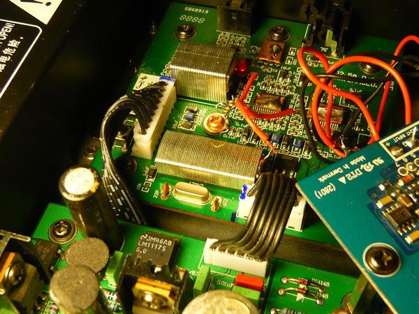

don't give up modding yet...
One well documented mod to digital section in cdps and dacs is to add small sheets of copper on top of ICs with in the digital section, and particularly over the controller ( the large dip chip). Strangely no one mentions this one in all the mods for the zhaolu. I had done it a while ago, but it is only yesterday i connected these "hats" together in star earth arrangement to the ground. you will be in for another surprise 😎
My zap is a bit raised from the dac board due to space constraints, and it probably gets less sprayed with EMI like this...
if you want to isolate the controller even further, you will find that staples from an ordinary desk stapler seems to be almost made to measure for this, convering the legs of the ic too...just cut to lenght, ( could not be easier) the plastic ic support will prevent any short on the ic itself , just make sure it does'nt touch anything else on the board itself. 🙂
Re: don't give up modding yet...
Not really sure I understand your meaning here. Do you have a picture or can you describe this a little better for me? Sorry, but I can't picture what you're actually doing with the staple.
As for RFI/EMI, perhaps some of that ERS paper would work just as effectively. Usually it's put on the case top, but I don't know if you can put that right on top of the chips like your copper foil idea. I'll have to look into that. Do you know if Home Dopey sells copper foil?

Hi Bob,
I cut pieces from a small sheet of copper (maybe 16x10 cms) bought from an art shop that is used for engravings: a bit thick to work ( 0.6 mm or maybe even more - use some sturdy scisors) but it's very very cheap. Shops who do model ships, airplanes etc are also a gold mine to find sheets of copper in different thicknesses... it's certainly cheaper than ERS paper.
I can make you pics but it's going to be late this evening...
If you have a stapler next to you, get a refill bar of staples. I am sure you will get the idea as soon as you have it in hand, just imagine it cut to the lenght of the controller ic ( the only dip one in the dac) - it forms a U shape, slide it over the IC ( think of a faraday cage) you'll see it fits really well. solder the earthing wire on the top side of copper first , glue the copper with clear double sided adhesive on the ic, slide the staple bar on top with just two tiny blobs of glue to secure it. don't try to solder the staples to the earthing wire, they're a pain. Maybe it's overkill using the staples on top of the copper so it it's up to you.
on the small smd chips i have just glued the copper with clear double sided adhesive, then solderred a wire to star earth on top.
Btw, do you have any pics of your trasfomer you put in the spdif rca? I would be interested in doing that mod, but not sure how to connect the pulse transformer...
Thomas
Thomas

I got a little exited when I got home with my parts order, so I went to town replacing parts last night. I should be able to give these changes a listed tonight, but in the meantime here's a bit on information on what I've done.
Power supply:
-lots of changes to the grounding arrangement. If I remember correctly the digital ground could only complete the circuit by passing through the chassis. I separated the chassis ground completely, and separated the ground plane at the two big caps. From each power supply circuit (two 5V supplies and analog +/- 15V supply) the ground has a single path back to the transformer through a wire.
-Chassis is connected to earth ground
-replaced all electrolytic caps. Smaller caps were replaced with Nichicon PW series 50V caps. The two big caps are Nichicon PW 35V. The two big 2200uF ELNA caps were replaced with Panasonic FM series 25V. Noticed that the G-Luxon cap installed on the board was a 25V cap with 25.5V on it. Yikes! I purchased a 25V Panasonic FM to replace it, but I put one of the ELNA 3300uF 35V caps here instead.
-replaced rectifier diodes with fast recovery schottkey type.
Digital board:
-removed all connections from ground to chassis.
-replaced 100uF tantalum caps on the analog 5V supply with 47uF Nichicon PW 50V caps.
Analog board:
-replaced 4 electrolytic caps in the supply with 2 Nichicon PW 50V caps.
-removed beads
-replaced op-amps with LM4562
-bypassed input coupling caps
-replaced the rest of the circuit with something similar to what Kevinkr designed. I added a bit to it to keep the transfer function close to the manufacturer's recommended filter. Resistors used for this are expensive Vishay CMF50 series, and caps are Panasonic ECQ-PZ (polypropelene).
-bypassed unneeded output buffer.
The only testing I've done so far is that I made sure the power supply still worked after all the track cutting I did to it.
