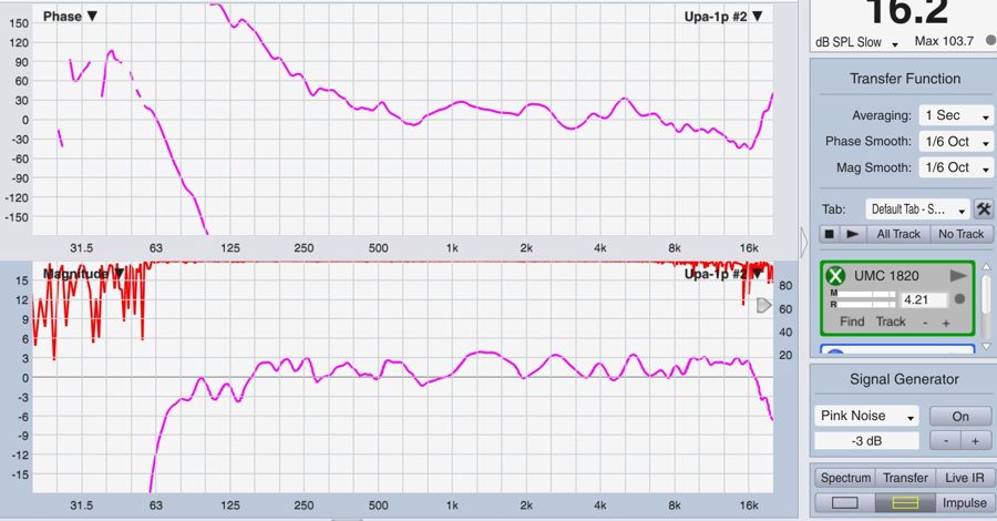

Aah yes, good ole 'older Meyer' ! It was some Meyer speakers and Bob McCarthy's writings that started me down the whole "phase matters" trail. In school for Smaart, instructors talked about the Meyer 'signature phase trace', its gentle slope and being the same on all their boxes. And like you say, all done analog. And like you also say, complicated and not easy.....especially the lower that phase stays flat in freq.
Below is a transfer of one of my UPA-1p's....as you can see phase lets go at around 500Hz. I do think taking phase flat all the way down to the bottom like Meyer's Bluehorn touts, is a very new development in commercial speakers. Could it even be done analog, pragmatically ?
Depends on what you are talking of. If you include the phase response caused by the low-end rolloff then it isn't possible in any analog fashion. But I doubt whether it would make sense at all because it would come with some unevitable latency. The K+H O500 Studio Monitor had such a (user selectable) feature for instance but it added latency. The new Meyer monitoring system isn't phase linear down to its lower cutoff frequency (which wouldn't make sense either as mentioned). But the Ssub/low-mid crossover is phase linear, which would already be quite a challenge to do in analog, especially when steep slopes are called for.
