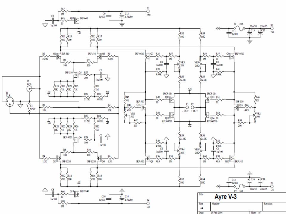

Are there also basic schematics of amplifiers, where are Charles Hansen's design's inside? QUOTE]
This schematic of the much earlier Ayre V3 all MOS amp has been posted in a few circuits forums.
The topology appears closer to Charles' core religious faith: "FETs are better than bipolars, zero feedback is better than feedback, balanced is better than single-ended, and the simpler a circuit, the better. "
Thank you for this informations.
At first look I don't find the resistors which determine the present voltage gain factor.

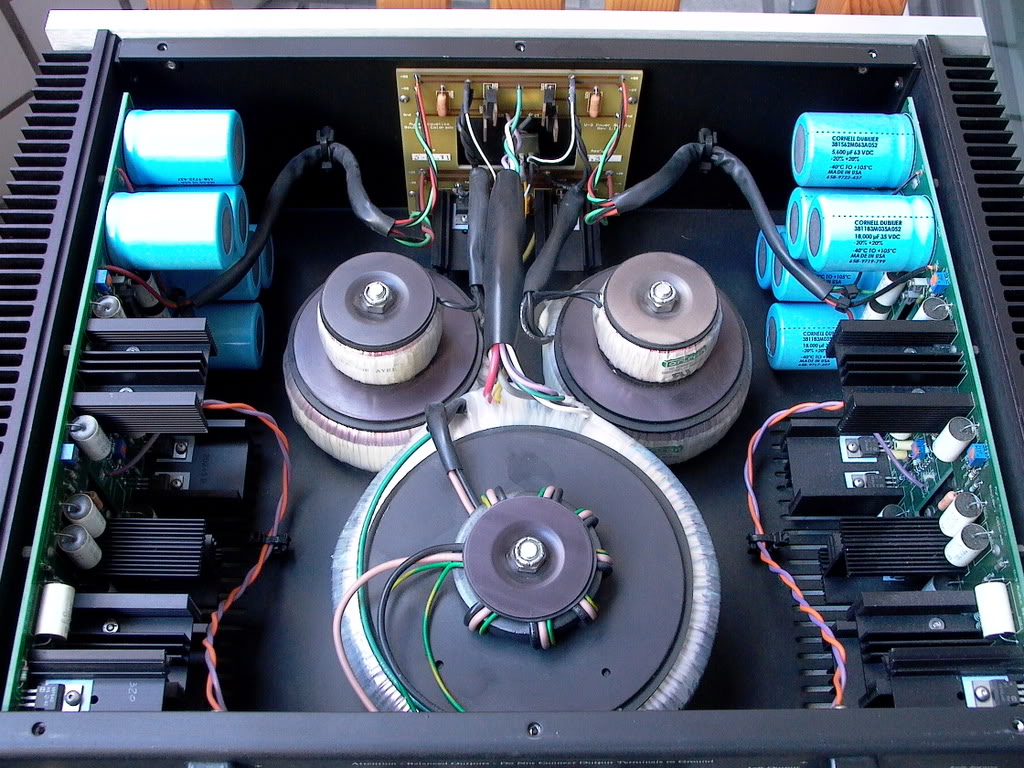

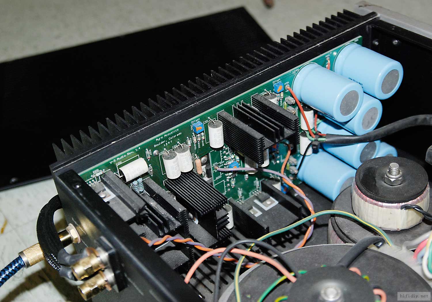

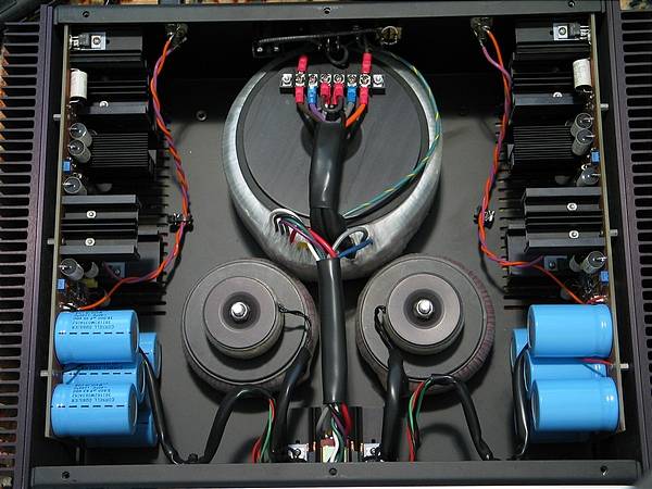

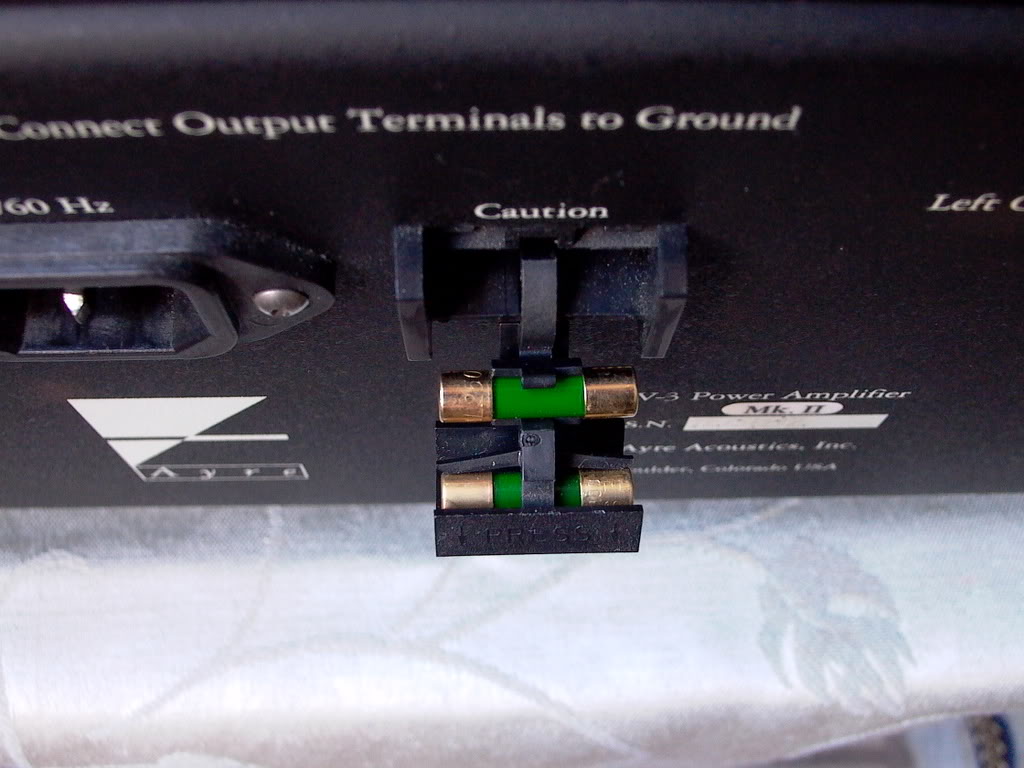

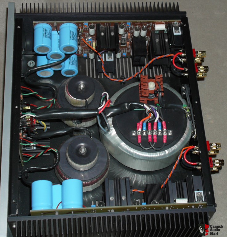

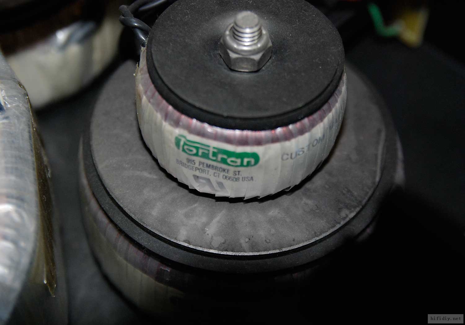

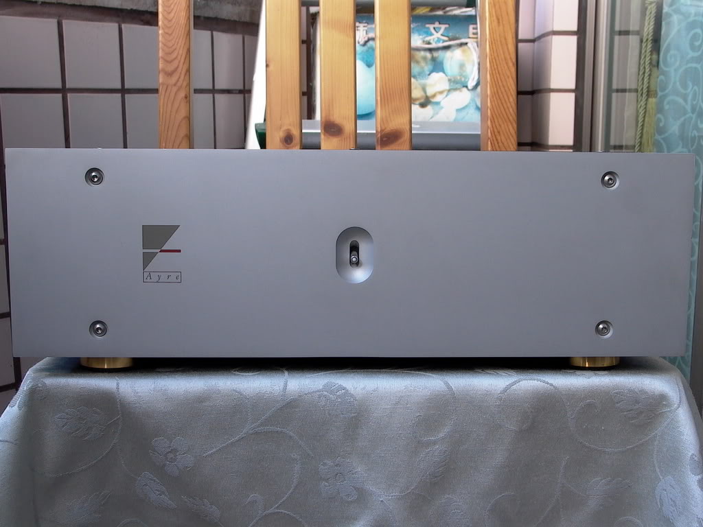

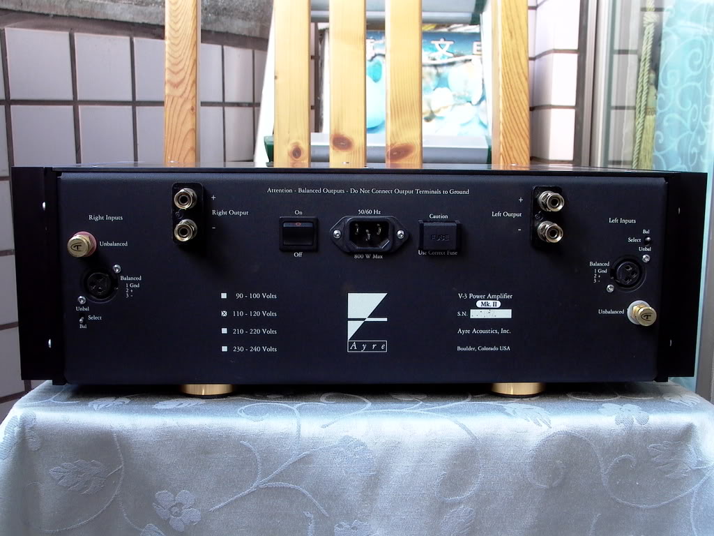

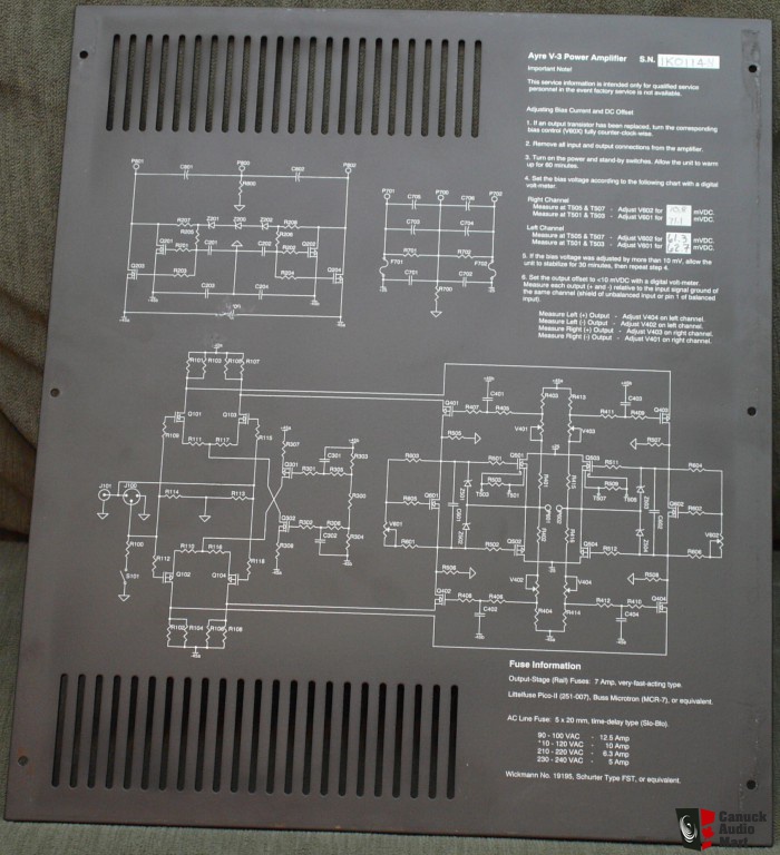

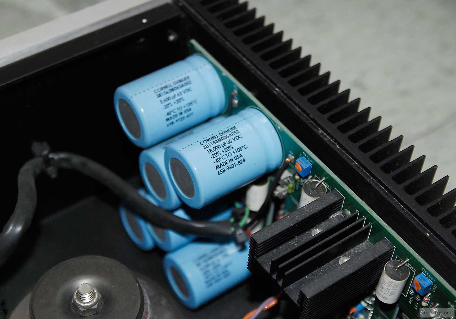

various pics from Charles Hansen's AYRE V3 from
°ÑAYRE V3ÍѹâÉíÌå¼ñ²é - ÒôÏìDIYÂÛ̳ - HIFIDIYÂÛ̳ - Powered by Discuz!
in the attachement

...At first look I don't find the resistors which determine the present voltage gain factor.
from the cover plate silkscreen pic a guess is:
diff pair degeneration R, together with input fet gm determine a input stage gm
folded cascode loaded with R to gnd determines amp V gain: gm*R
