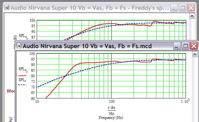

VictoriaGuy said:GM:
Thanks for the sims for the AN 10 and 12.
You're welcome! If Freddy's specs are accurate though, then the super 10 cabs will be way too small and not worth the time/wood to make them. 🙁
GM
freddi said:what Q's did you use for those AN MLTL sims?
For drivers with a <0.403 Qts, I normalize them to it to get to a Vb = Vas, Fb = Fs alignment.
If your specs are accurate, then probably all my designs are worthless and will add AN products to my 'buyer beware' list. I prefer/recommend large size cabs to allow plenty of specs latitude, but to be so far off that a generously oversize cab is way too small is gross intentional misrepresentation.

That's pathetic. Do me a favor and verify the cab's net Vb and tightly seal up the vent and measure its Fb, then let's see what Novak's vented box formula for a Fb = Fs tuning calcs. This is a fairly fool-proof way to get a good alignment even with specs that are considered to be unsuited for a vented one.
GM

can incorrect specs ba a reson for the csa enclosures resulting a the end better than other modeled designs?
Absolutely! I assumed as much and why my suggested alignments are way too large by accepted T/S vented design theory, but they are still too small if Freddy's specs are representative as to how far out of spec they are unless tuned high like theirs, so why bother building mine if they can't be tuned lower with enough box efficiency? Indeed, according to a sim, my tall cabs tuned this high will require more stuffing to smooth it out rather than keeping it to a minimum as it's meant to do.

freddi said:I'll have to put it back in the box, find some duct tape and scrap wood - might take a day or so - if mains power doesn't go out when an ice storm comes through - - theres quite a big of rise and HF on-axis energy.......
Whenever....... I wish I could get back to building/measuring, but I'm starting to believe it's not 'in the cards' for me. 🙁
Well, it figures, the part you want to be grossly overstated is the accurate one.
Anyway, take care and hope you have some form of fossil fuel to keep you warm and to cook with if the power goes out.
GM

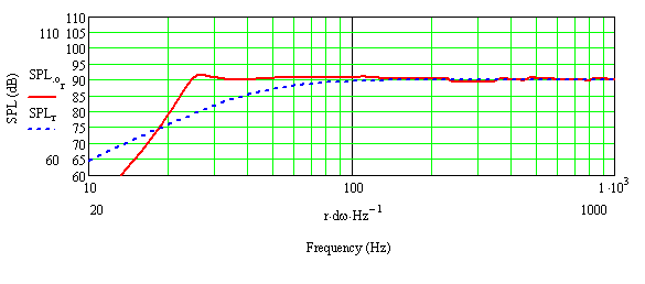

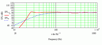

Looking at those German specs. in the link Freddi provides, about the best I can figure WRT the Super10 in a box is a pretty vast (and mediocre) MLTL tuned to 25Hz, but needing 5ohms in series to do it & a fairly severe toe-in.
CSA = 363.75in^3 (call it 24.25in x 15in WxD),
L = 56.5in, Zd = 23.875in, Zp = 53in, vent = 5in diameter x 1.0in long, 0.25lbs ft^3 in the top 35in, then each adjusted to individual requirements.
