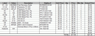

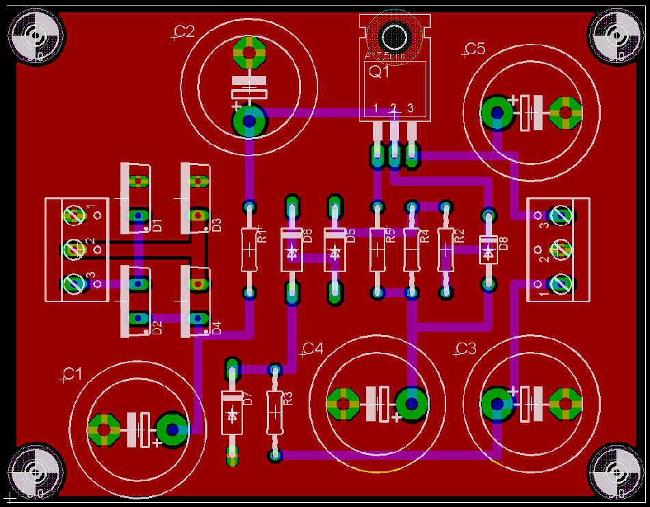

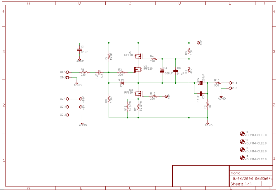

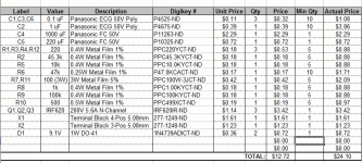

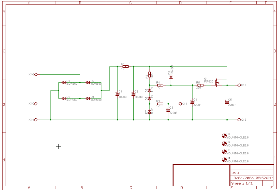

As an exercise for myself, I decided to try designing a PCB of your Zeny variation. If I can, I'd like to ask for your help reviewing the design, as well as the help of the community. I'll attach the pcb art work, schematics, and my digikey shopping list.
Oh, and for that 221ohm resistor on the output, I think I remember reading that for a head phone amp (and general impedence matching) the output impedence should be lower than the impedence of the headphones. I'll be using mine with a pair of Grado's (32 ohm), so I'll likely jumper that spot, but for the purpose of a general pcb, I left it in.
-Scott
-Scott

O, I use two thermistors (CL60 is okay I think): one at the primary
side of the transformer and another between the star ground
and the chassis. The chassis is directly connected to the
protective earth (of the wall power socket).
The ground plate in your supply PCB would work well, no doubt.
By the way, I am approching in a different way without having
the ground plate. Refer to the attached example (from another
project). You will see the star ground and branches from it.
This also works well.

Ah okay. Yeah, proper grounding methods is something that I'm still learning about, and unfortunately it's like the most important part of a circuit!
If I go with my ground plane on my pcb, should I add a pad for the chassis ground on the amplifier pcb?

adolphe said:If I go with my ground plane on my pcb, should I add a pad for the chassis ground on the amplifier pcb?
Scott,
Indeed, I always spend more time in grounding methods than others.
I think I need time for me to understand what is "the pad for the chassis."
With your PCBs, I would try the grounding this way.
(Sure, this is not an only way . . . 🙂 )
Regards
Those boards are great looking, adolphe. Any chance to have a PDF in B/W of those tracks when you are done, finetuning? Sure would be nice to compare the Zeny to an original downscaled Zen HP amp😉 Furthermore, I need a few projects for this winter. If the summer ever stops that is.
Steen😎

sorry JH, all I meant by the "the pad for the chassis" is to provide a spot to connect the chassis (through a thermistor) to the pcb.
Steenoe, I'm glad you like the layout. When I get home from work tonight, I'll try to get you a high quality B/W PDF.
