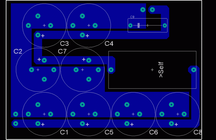

Yes you're right a Pi filter is the better solution to have a good PS.
Is there no disadvantage using coils in the ps?
As far as i have seen, Nelson Pass doesn't need them in his amps.
In his x-models he has NTCs in a CRC-combination.

Roberto,
don't forget that the more cap you add, the more the ripple spectrum shifts to higher frequencies, where the rejection of the amp get worse. Indeed, it will for sure change the sound, but not necessarily for the better.
If you are interested, his has been discussed in other threads
ad nauseam
Jan Didden
Exactly right. That's why I stress the importance of inductors in a power supply.😉janneman said:

Well... cost for sure. Bulkiness. They put a resistance in series with the supply, so you have to calculate the voltage drop and act accordingly... but so do NTCs. I've never used them but if Nelson does I'm sure they work very very good. If I recall well, Nelson does a CRCRCRC... filtering, don't remember how many CRC cells. Seems to me they have many advantages in terms of cost and space they free... but until I try them out I don't have a personal opinion about performance differences.aaronpiet said:Is there no disadvantage using coils in the ps?

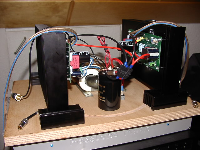

CRCRC
I am sure that we have all seen the pictures in the Aleph-X thread, but for those that haven't, here is a link to the pictures of the XA-200 and brief descriptions of each by Mr. Pass.
XA-200 pictures from Aleph-X thread.
He has implemented RC filtering before, just look at the BOZ. Of course it is much easier to realize an RC filter when the current demands of a system are in the milliamp range. Speculating what the demands from the XA-200 power supply are, I can understand the use of the thermistors as part of the filter network for the power supply.
Also, as Jan has said, filtration capacity, its impact on diode conduction angle, and its effects on noise spectra have been throughly explored, albeit don't let that stop a thoughtful and lucid discussion from continuing.
