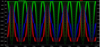

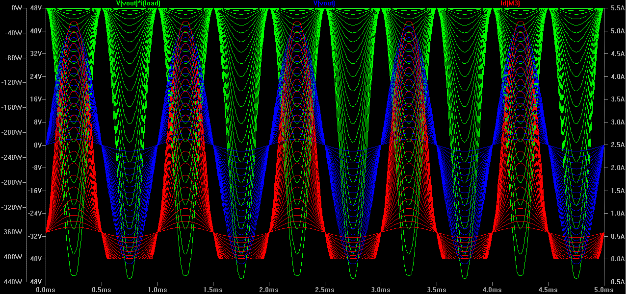

4 Ohm Load
.step v=0.1
Fourier components of I(load)
DC component:0.00209143
Harmonic Frequency Fourier Normalized Phase Normalized
Number [Hz] Component Component [degree] Phase [deg]
1 1.000e+03 5.255e-01 1.000e+00 179.95° 0.00°
2 2.000e+03 1.699e-06 3.234e-06 -59.38° -239.33°
3 3.000e+03 1.653e-06 3.146e-06 -164.20° -344.15°
4 4.000e+03 2.950e-08 5.614e-08 127.67° -52.28°
5 5.000e+03 5.070e-09 9.648e-09 32.13° -147.82°
6 6.000e+03 1.617e-09 3.076e-09 -46.44° -226.39°
7 7.000e+03 5.125e-09 9.752e-09 -167.10° -347.05°
8 8.000e+03 1.405e-09 2.674e-09 165.79° -14.16°
9 9.000e+03 1.529e-09 2.910e-09 127.66° -52.29°
Total Harmonic Distortion: 0.000451%

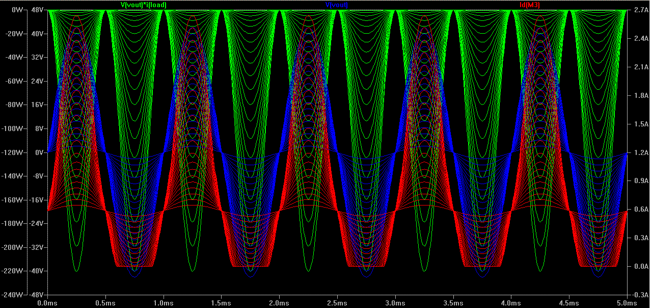

Thanks for that I appreciate it. Sorry if I'm missing something but what is the power all those distortion results from and into what impedance?
From post#24 they are for 4 Ohm. Before post#24 they are for 8 Ohm.

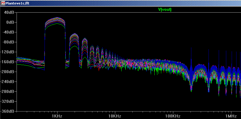

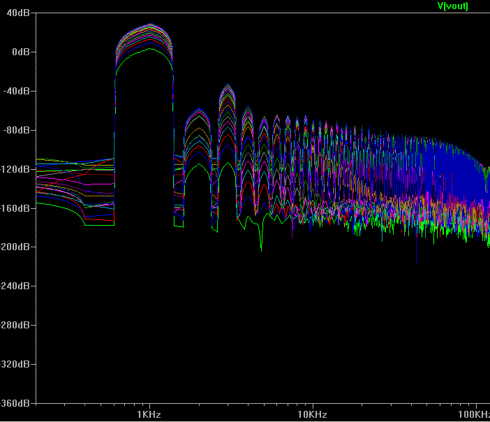

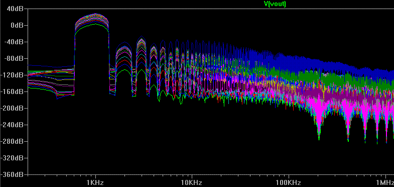

If you see each FFT chart, there are about 20 superimposed charts. They represent input from 0.1 volt, 0.2 volt, 0.3 volt, until 2.0 volt.
If you look at the power chart (i.e. the 8 Ohm load in the first power chart of post#21, green chart) you can see that 0.1 volt input corresponds to 1W output, 0.6 volt input corresponds to 20W output, 2.0 volt input corresponds to 220W output etc.

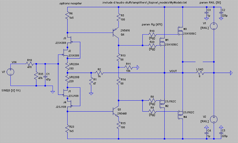

F5 styled feedback
With F5 style feedback arrangement, e.g 1K5 from output to each source (and grounded source resistors) this amp gives max 33W into 8 Ohm, but the distortion spectrum is much better. Such FFT (attached for input from 0.1 volt to 2 volt) should be better sounding than the original.
EDIT: Max output is probably more than 33W. The 33W was what is given by 2 volt input, a standard CD player output.
