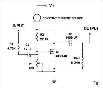

I have been thinking about Schade feedback and although not spelled out I would think the resistor from drain to gate might need to take the input capacitance of the mosfet in mind so R2 probably wouldn't be effective in providing Schade feedback. But what if we replaced R2 with a 2.2k resistor and remove P1 and use another source of bias voltage ?
