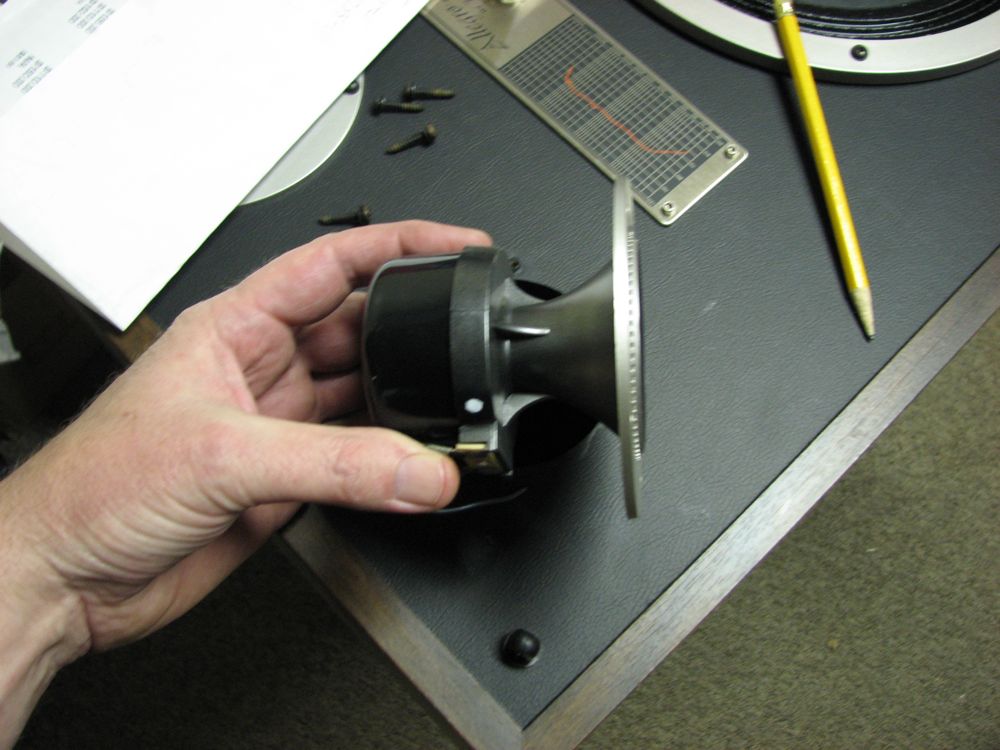

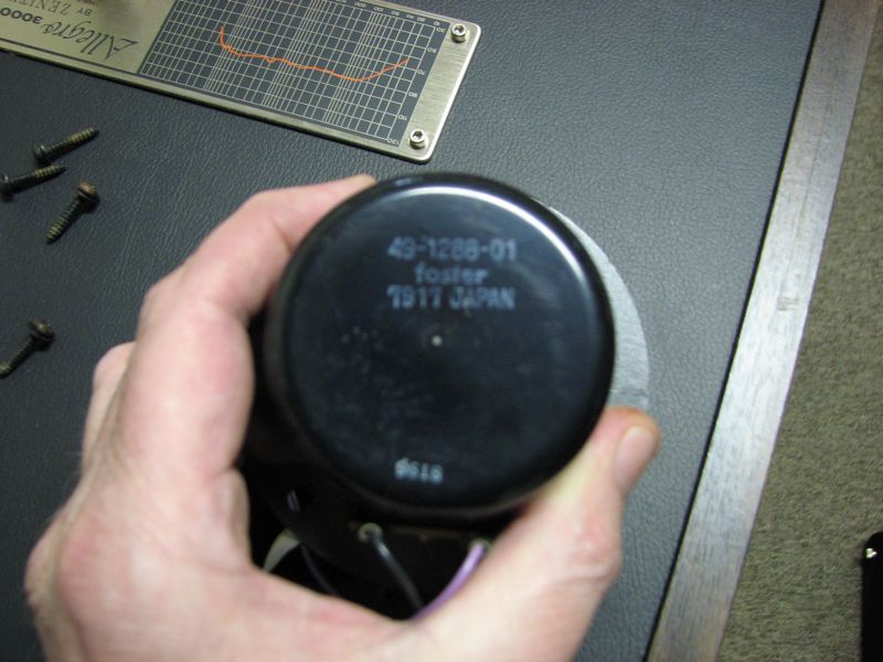

Cal, just a new molding for the horn. Had a couple pair of those thru here.
Again, back to what Zenith could source (cheaply) from Foster.

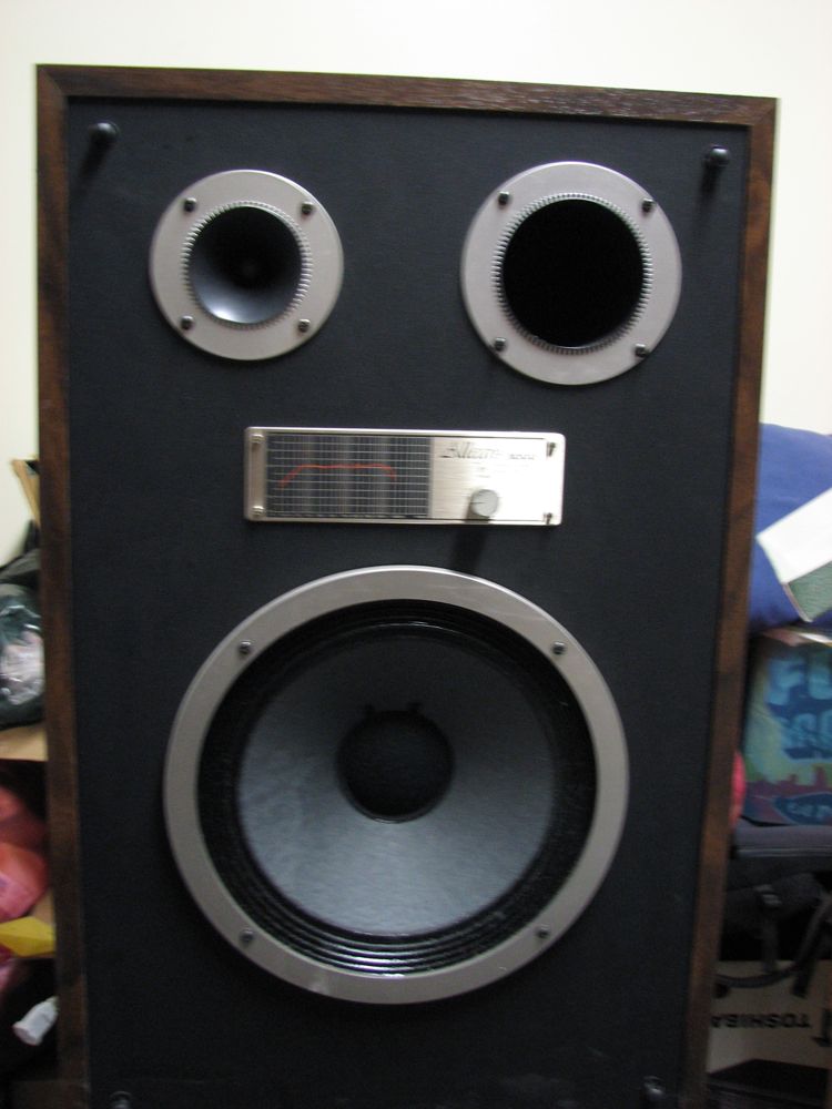

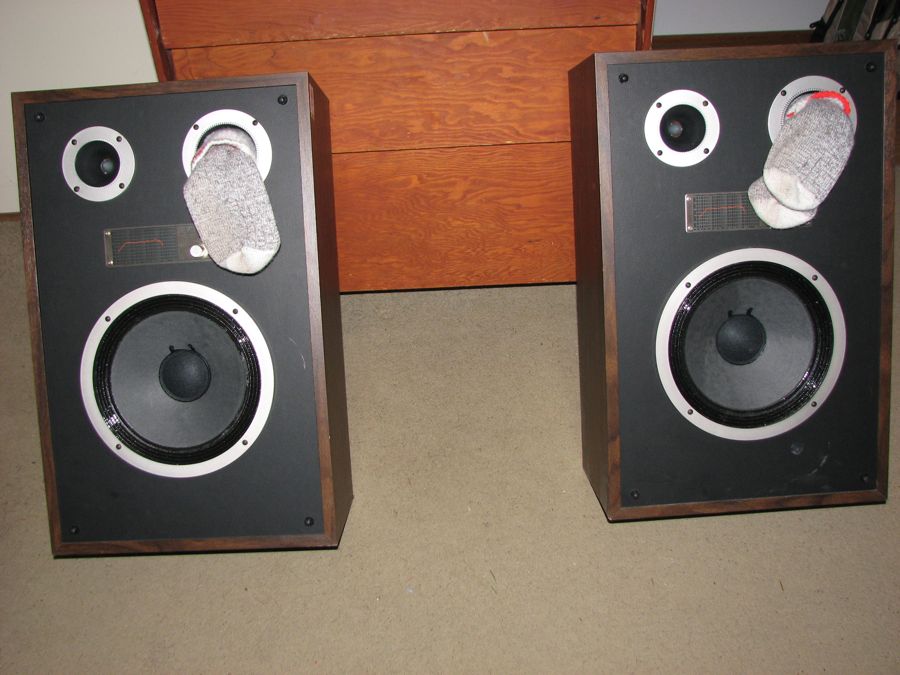

Here's a picture of the front of the speaker.
I'll take some of the inside when I get the parts ordered and open the cabinets to install them.
The only problem is the drivers are not mirror imaged.
