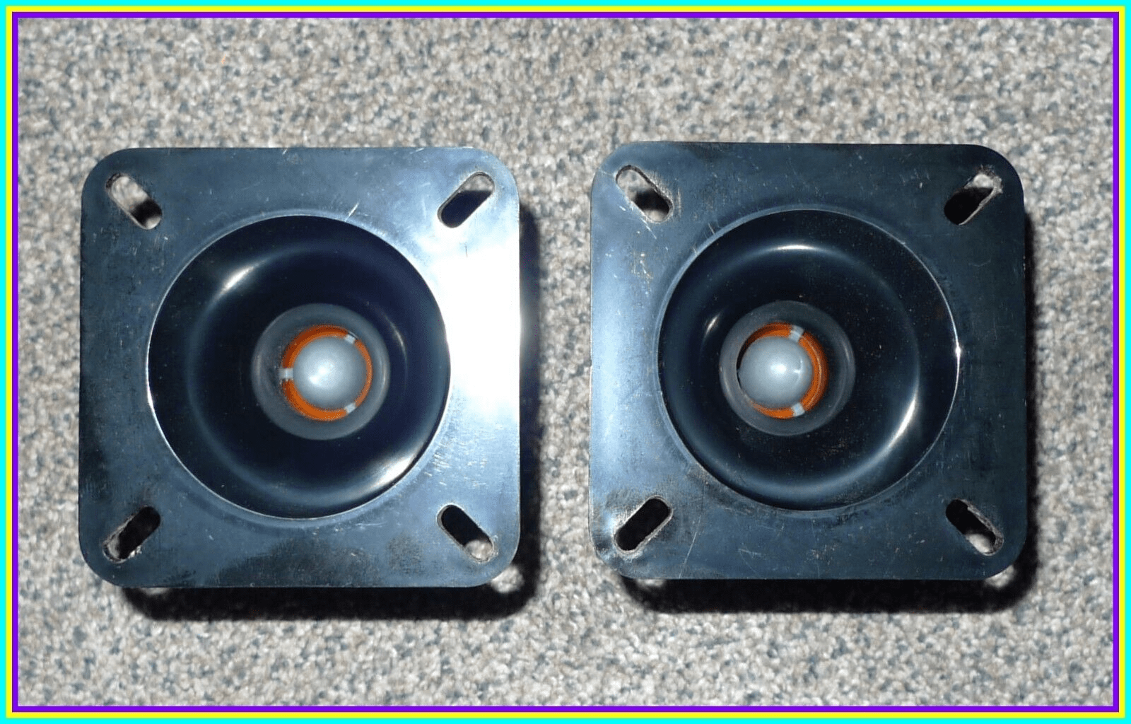

I have a pair of Foster tweeters from a pair of Zenith Allegro speakers. Mine are the black plastic housing with the silvery domes and square mounting flange.
Does anyone know the SPL of them?
I used them in one of my early speaker builds and used variable l-pads. I'm wanting to go with fixed l-pads instead so there's less I have to worry about adjusting in my stereo.

Those look very like the Foster horn tweeters used in the Wharfedale E (for high efficiency) range of speakers, and which were 98 dB.

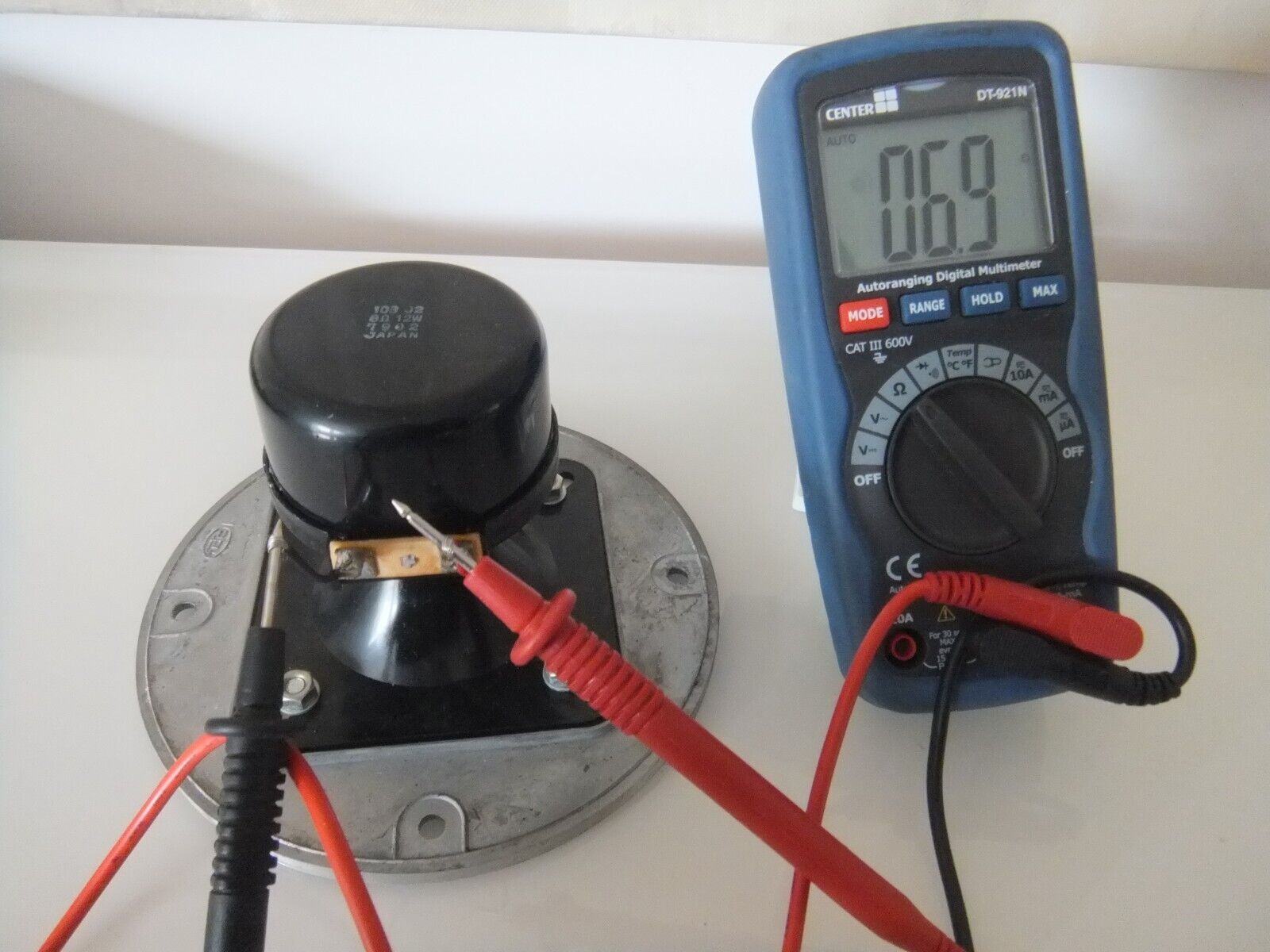

Can you measure the DC resistance for comparison purposes.?

The Wharfedale E50 Foster horn tweeter had the following specs: 8 ohm nominal (6.9 ohm DCR), 98db/2.83V/m, 2.7kHz resonance.
This type of tweeter is characterised by low power handling, made up for by a high crossover frequency and high sensitivity.
I think it is sensible in your case to accept 98 dB as a working hypothesis.

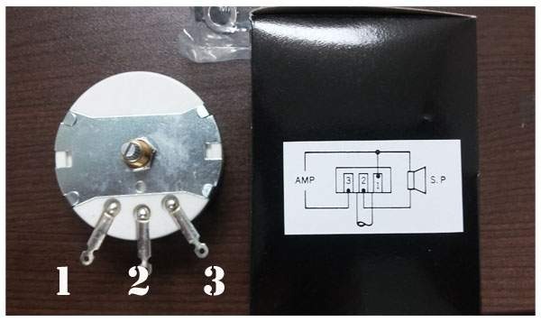

If you still have a variable L-pad you could use it to set the required degree of attenuation then measure the values of the parallel and series resistances.
Measuring across terminals 1 & 2 will yield the parallel resistor value.
Measuring across terminals 3 & 2 will yield the series resistor value.

The needed attenuation is 11dB and the calculated resistor values are series 5.74 ohms (4.7 ohm and 1 ohm in series is close enough) and parallel 3.13 ohms. How far can I deviate from the .13 ohms before the effect to the crossover and output is noticeable?
I did think about setting the variable l-pad by ear then measuring the resistance before posting here, however I want the tweeter attenuation to be set right and not by ear.
...however I want the tweeter attenuation to be set right and not by ear.
I don't think that is possible for it "to be set right" unless you know the exact sensitivity figure for the particular tweeter in question.
It really does come down to setting by ear or, better still, by measurement (if you have the facility to undertake it).

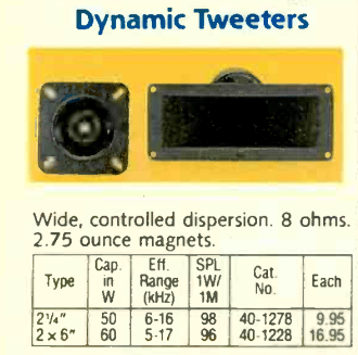

Radio Shack sold a version of this tweeter...
Radial Horn Tweeter - Stock number 40-1278 in their 1977 catalogue, but no sensitivity figure given.
I doubt they are as efficient as earlier suggested.
I agree, sensitivity figures can be optimistic.
I suppose it depends on the frequency range over which measurements are made on the tweeter in order to establish an average figure.
I have the Fosters and the actual Zenith speakers with them and IIRC, they were 96 dB. They also only extend to a little over 16k.
Edit: I am wrong, the speakers are the 3000 which have a round tweeter.
1990 catalogRadial Horn Tweeter - Stock number 40-1278 in their 1977 catalogue, but no sensitivity figure given.
