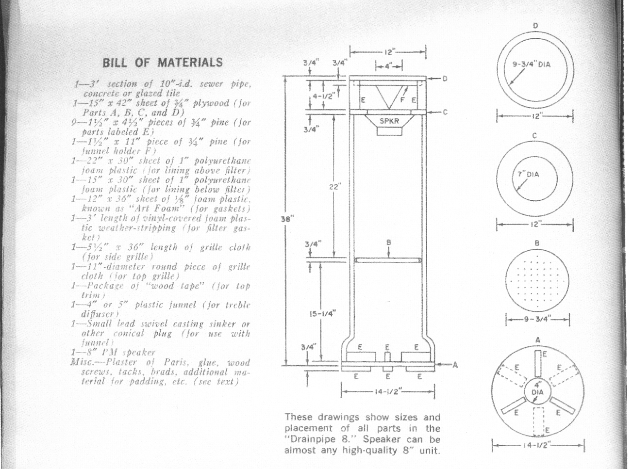

That type of omni speaker were common in the 60's with a number of DIY articles and a few commercial versions seen. The July 1961 and June 1962 Popular Electronics featured similar systems designed by David Weems. One loaded into a ten inch clay sewer pipe. Eico had a Hageman designed commercial system loaded into a transmission line. Collectors still pay top dollars for those systems. If you don't care about exact imaging,they offer an interesting design to experiment with. A good project for a full range fan.

If the diameter of the base of the conic-reflector is for example 13 inches (33 cm), then it is pointless to radiate sound of a frequency less than 1 kHz towards the cone. At 1 kHz ( wavelength = 33 cm) and lower frequencies, the cone is more of an obstacle than a reflector, so sound in that frequency range is only marginally reflected.
What is usually stated about the reflection of sound is that the dimensions of the reflector must be several times the wavelength of the sound. So far I haven't discovered a more precise statement about it, like the percentage of reflection that occurs for a given ratio of size of the reflector to wavelength.
That was what I was thinking earlier when I mentioned projecting the mid/tweeter only, but only guessed on the bass wavelengths.
