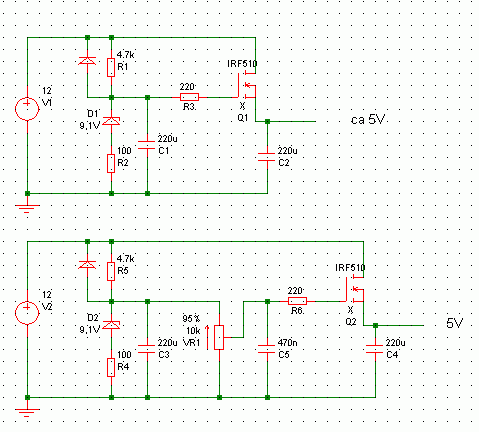

ok,
i want to have ~5V. And i don´t want to use 7805. All the circuits with LM317, TL431 etc. use more parts, and so its not really less to use them as to build it discret --> first circuit ?

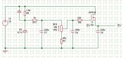

Whats the purpose of R2, i found it in a circuit on the net.
Now i want 2 times same voltage. As FETs and zehners have not really the same VGS and zehner voltage it would be a lot of matching and i need to order more parts to get 2 identical regulators. Could i do it like in the second ciruit? Disadvantages? and what value for the pot to choose?
Should i use other values for components?

The 100 ohm resistor provides a lower corner frequency for the 220uF filter cap since the impedance of the zener is usually in the range of 10 to 30 ohms. Unfortunately the power supply rejection of the voltage divided formed by 4.7K resistor and the zener has been made about 10 times worse by it's inclusion. Take the resistor out and connect the zener to ground. R2 is now connected between the positive side of the zener and the postive terminal of the 220uF cap. Same filter frequency without decreasing the regulation for the zener. You can make R2 larger and go up to a 1K ohms without any problem. The pot as in the second circuit will work fine. If you put a fixed resistor of 50k ohms between the pot and ground the circuit will be easier to adjust due to the smaller voltage change for a given rotation amount.

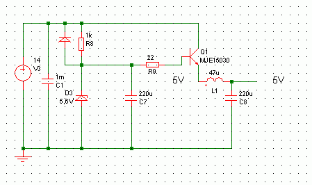

I built the circuit in #3, and now please don´t lough at me - discovered Vds seems to depend much on current. Between no load and 30mA, the voltage decreases 0,9V.
So should i better build instead of the FET a NPN, MJE15030 i have, and low ohm connected a 5,6V zehner, no pot?

but the transistors i have on hand, the ICs not.
Now i´m at 5.05V unloaded, 4,99V at 30mA. My cheap multimeter says 13mV AC independdnd of load. Will this be sufficient for analog DAC supply? (additional filtering direct at the DAC)

13mV AC
This 13mV will go straight into your audio. I would not consider it anywhere near acceptable in the DACs I build. You will end up with maybe a 50db S/N ratio if you're lucky. The regulation sucks too and if there is nay load variation, that too will go straight into your sound. The 5V supply for the analog portion of a DAC id very critical.

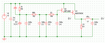

You should go up to a 6.2V zener and use a darlington connected transistor. Also use a 2 stage RC filter to drive the zener. Either that or a 3-4 transistor feedback type regulator like we made in the 60s. The design of a linear regulator is really quite a complex affair that you are going through to save less than a dollar on a 7805.
The power supply is the foundation of every electronic circuit and if you cut corners there, the rest will never work as well as intended.

For the 2 stage RC filter, what values do you propose?

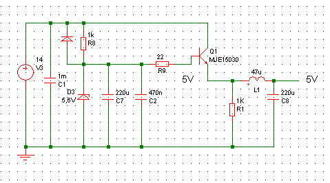

The +5V i build bipolar as picture attached. 50 Hz is also not measurable any more with my scope. But i still have a difference between unloaded and loaded. The AD1865 is speced 22 - 26 mA, i will drive 2 of them for balanced. So i loaded the 5V with a 100R resistor for test. The voltage difference i get between unloaded and 100R load is about 16mV: without load ~ 5.20V witth load about 5.04V. Is this critical, should i change something?

The basic problem with this circuit is that it is not a regulator, it is open loop. The performance will vary with the components you chose, but there will *always* be level variations with load, and there will be spikes with digital load. AC ripple performance will also be mediocre, compared with regulators. I understand that you want to use the components at hand, but that will have consequences for the performance.
I'm sorry, but these are life's realities. Circuits like this, basically a DC emitter follower, have their limitations. You may try a heavy standing load like .5A, so that the DAC load variation is relatively small. That will give you better performance for the price of increased dissipation.

someone mentioned this earlier but this is essentially an open-loop emitter / source follower. so the output depends on Vgs of the mosfet (output voltage is the zener voltage minus Vgs). Unfortunately, Vgs does change quite a bit with Ids.
One way to get around it is to put a dummy load. Make sure the dummy load is sufficiently large so any variance in the actual load wouldn't be significant (for example, if you anticipate a 10ma output current, put a load that drains about 100ma).
