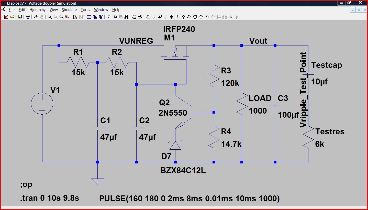

I'm making a regulated 150v power supply for an OTL headphone amplifier. Supply current at idle is around 100mA and can go up to 200mA (class A).
I'm making a zener follower circuit and it works but not for long. Somewhere along, the TIP122 Darlington died causing unregulated 180V supply to show up at the emittor (collector-emittor shorted).
Schematic is based on this but i made some changes i described below:
Voltage drop resistor value is 2K2. TIP122 darlington. Zener is series of 36v and 120V zener. Input cap is 220uF/200v and the only difference with the schematic above is i put 100uF capacitor across the zener (so if you remove the zener, it's a capacitance multiplier circuit).
1. Why did my TIP122 die? It could be that i fiddled and somehow shorted the transistor by mistake (so nothing wrong with the schematic).. i just want to make sure before i put a new darlington. Here's the datasheet.
2. Does zener really have bad regulation? 36 + 120 = 156 v but i'm really getting around 168-170V at the resistor-zener junction. This is why i fiddled with the circuit and may have killed the transistor.

a true regulator with error correction. The addition of three components, the extra transistor and two feedback resistors create a proper regulator. The zener becomes a 12 volt one. The two resistors and caps to the left reduce the ripple component. The bits to the right are just for testing.

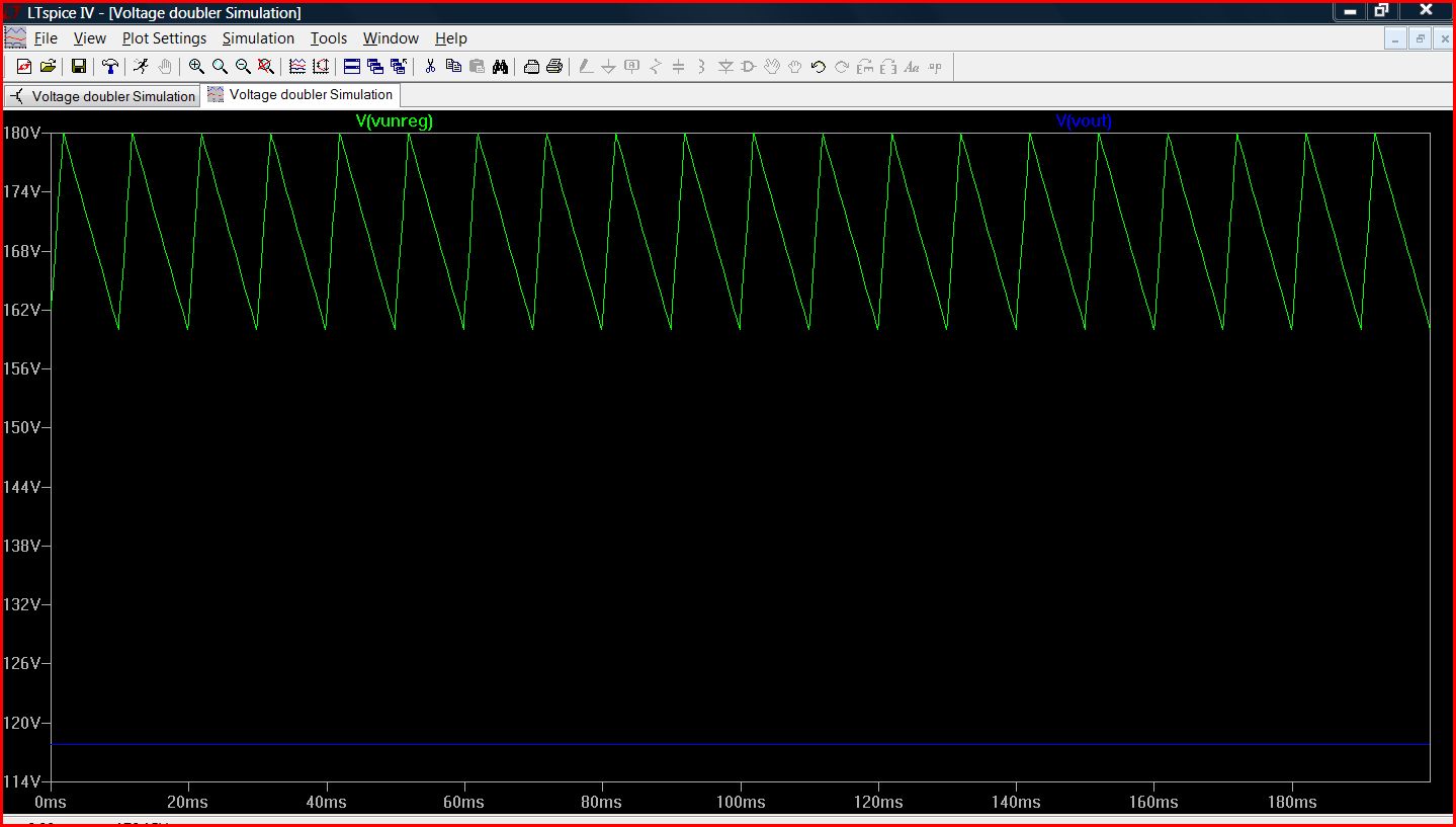

You can see how much ripple I've added to the unregulated input and how well the circuit reduces this under load.

Thanks for the circuit suggestion. I'm not sure i follow how it works, especially the values of the base voltage divider. The 2N5550 will start to conduct at 12v + Vbe = 12.7v and this combined with voltage divider of 14.7K and 120K mean it takes about 116v at the mosfet source for 2N5550 to conduct and limit Vgate? Quite far from 150V.. Or am i doing it wrong?a true regulator with error correction.
Also, i guess i can get away with skipping R2 and C2? The PCB is already crammed as it is. Adding another bulky high voltage capacitor is not what i want.
You need a much higher rated device than a 55v part.
The regulator is a classic "text book" implementation. Your description is spot on 🙂 its me that somehow had it in mind it was 120 volts output you wanted. You just alter the divider ratio to get the output voltage you want or replace R4 with a 22k preset and set it exactly.

If I where you, this is the schematic I'd go for 😉a true regulator with error correction. The addition of three components, the extra transistor and two feedback resistors create a proper regulator. The zener becomes a 12 volt one. The two resistors and caps to the left reduce the ripple component. The bits to the right are just for testing.

Listen 🙂
That circuit is a basic workable example. The FET type is fine, the transistor just happens to be in the LTspice library. You can use any general purpose type as long as the ratings are OK, particularly Vce. A 2n5551 is a common device, and an MJE340 should be fine too.
The zener isn't actually critical at all because you can just alter the divider ratio to suit. So 8.2volt zener, 12 volt, 30 volt even. All can be made to work. Four or five milliamps is usually plenty for a typical small zener.
