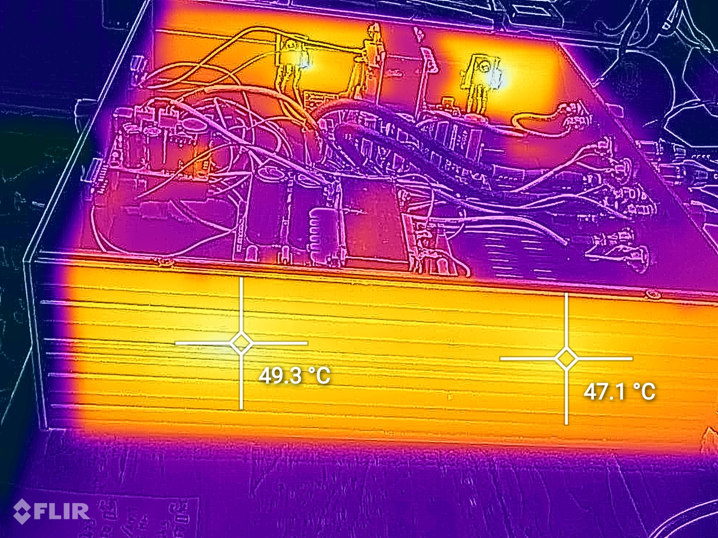

The 3-digit display shows the bias current. All four transistors survived, and get warm, but not hot. Definitely an improvement over the original heatsinks.

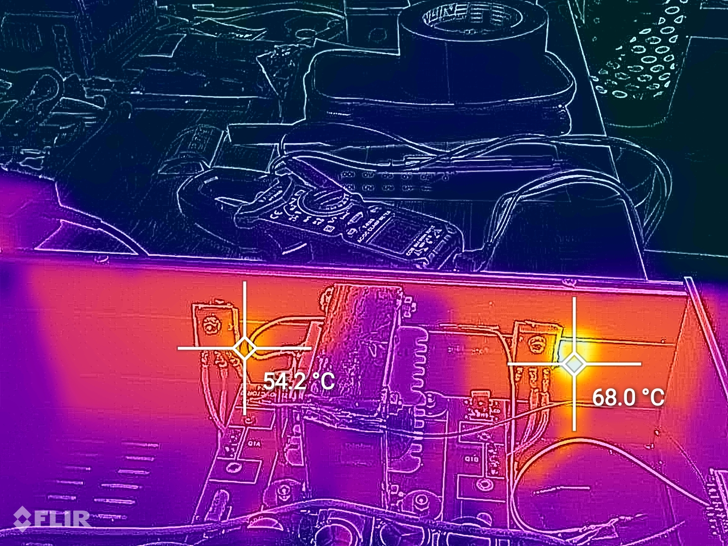

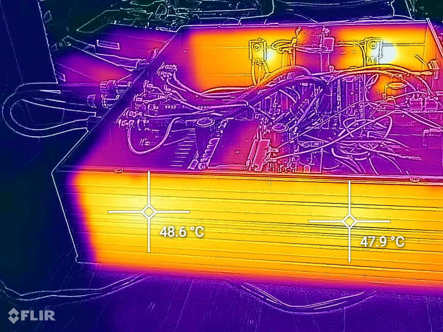

A thermal image:

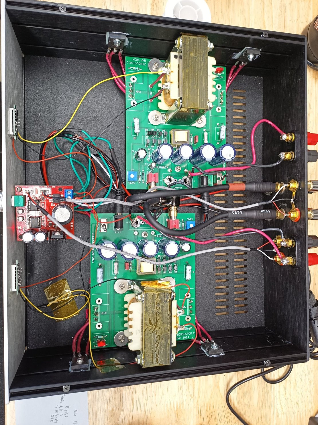

Almost finished (except for the preamp connections):
With top cover:

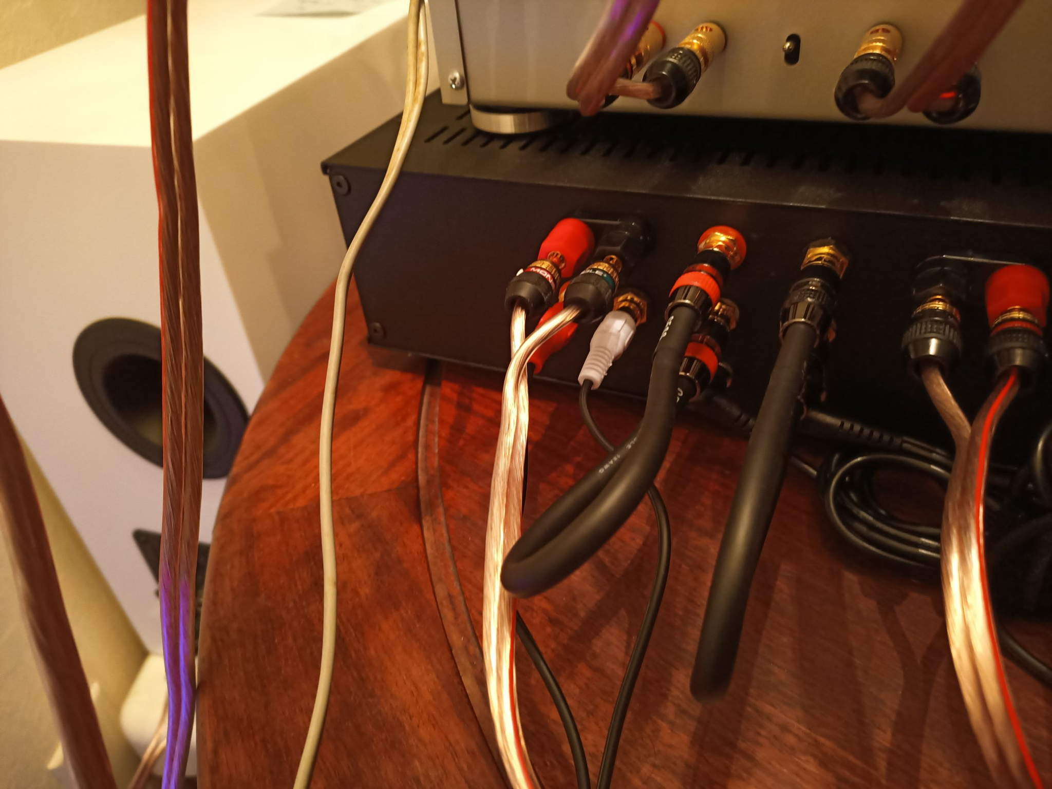

Rear panel, still with empty holes for preamp connections:

The preamplifier (from ebay, using two NE5532 op-amp chips) is all wired up and works. As hoped, it puts out a little bit more than my Bluetooth receiver. For some reason the volume when streaming from a Macbook was insufficient. Must be an Apple thing?
The preamp gets looped in via two external 8 inch RCA jumper cables, which makes it easy to remove it from the signal chain.

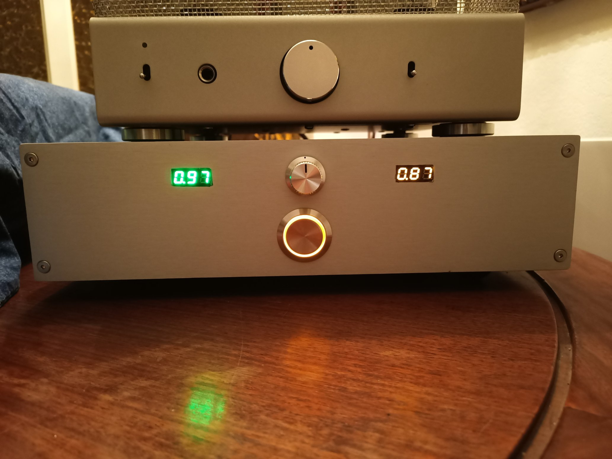

Unfortunately one of the green 3-digit displays already fried itself and had to be replaced. At some point I'll probably switch the other display to yellow as well.

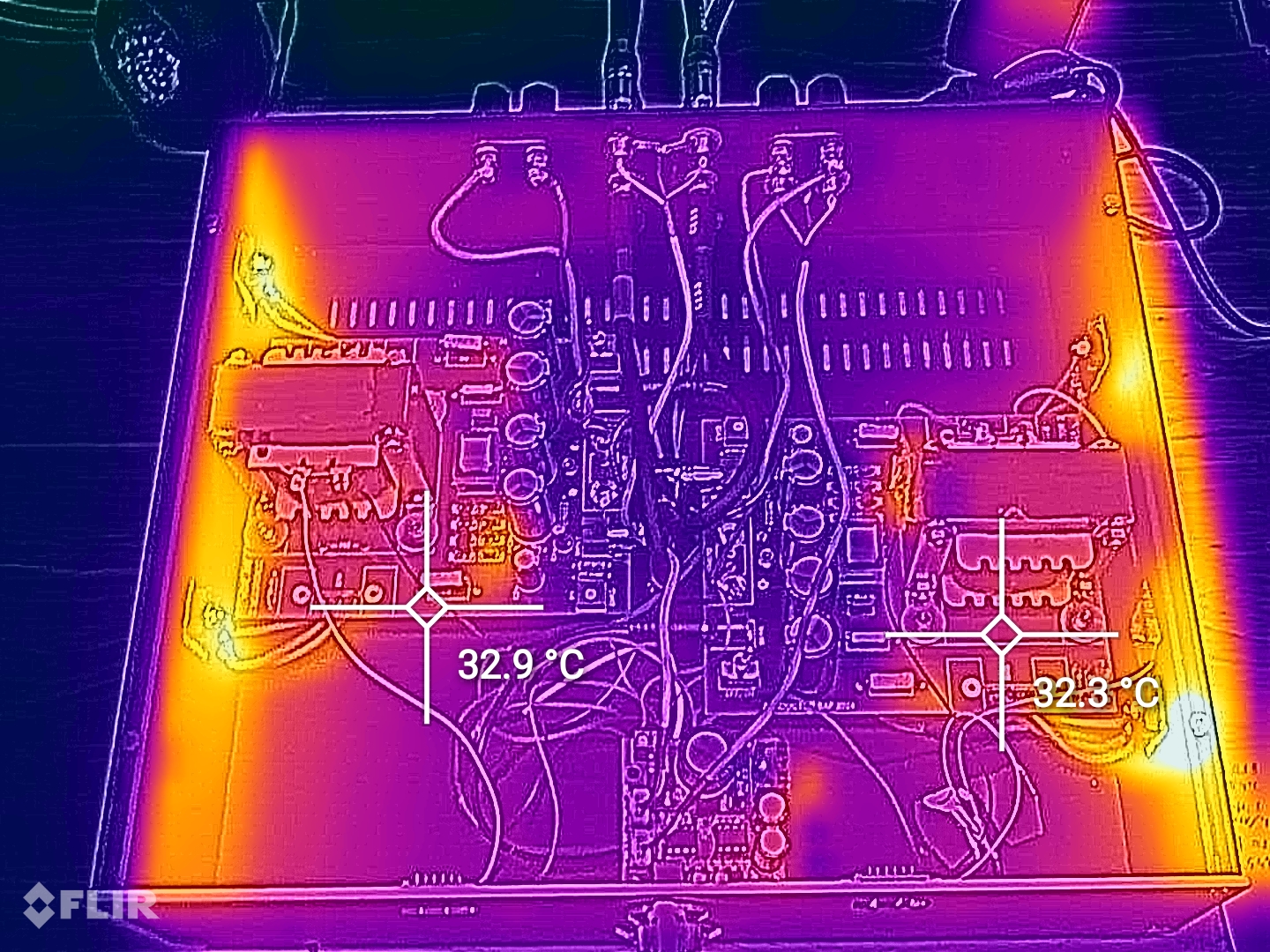

IR images after bias adjustment to 1.13V over the inductors. The current sharing on the left side is perfect, on the right side the front transistor runs hotter.

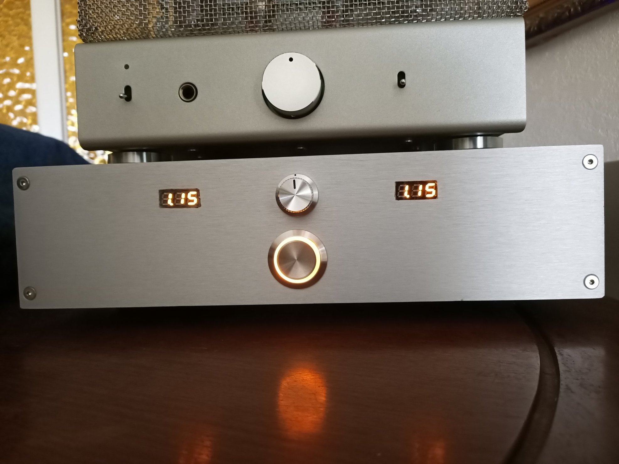

Front view, with both bias displays now in yellow:

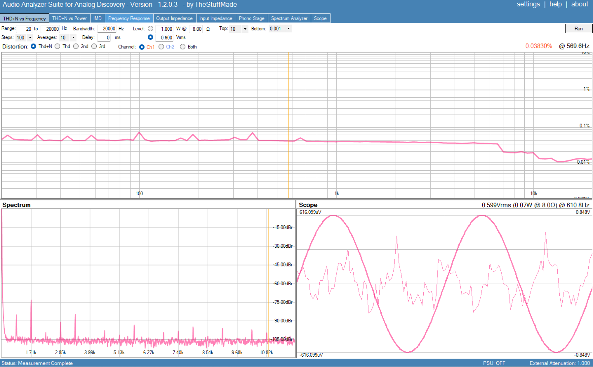

Some measurements with the Digilent Analog Discovery 2 USB scope (with BNC adapter) and the Audio Analyzer Suite (and also a test of pasting from OneNote) - ooops, unfortunately that doesn't work. Can't even post a single image. The formatted text works ok, though, but of course is not very useful on its own.
Direct pasting from a screen shot seems to work though.
This is the Zenductor 2 right channel THD+Noise as function of frequency, at 600 mV RMS input amplitude, and ~1.5V (0.19 W) output into an 8 Ohm resistor, with the bias voltage over the inductor at 1.22 V.

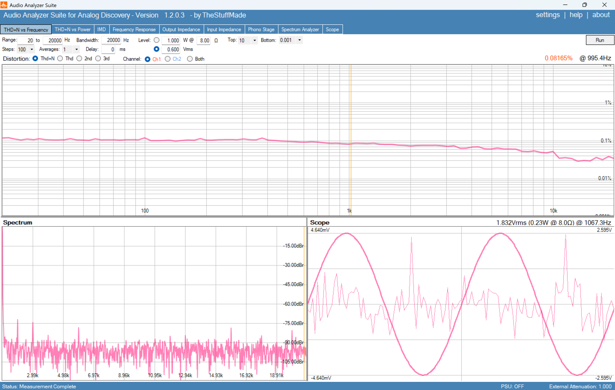

NE5532 preamp (left channel)
  • THD+N vs frequency 0.0816% = -62 dB at 1 kHz

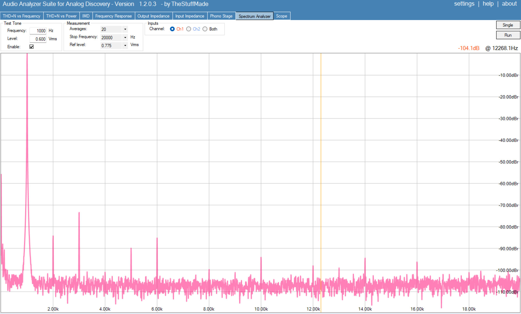

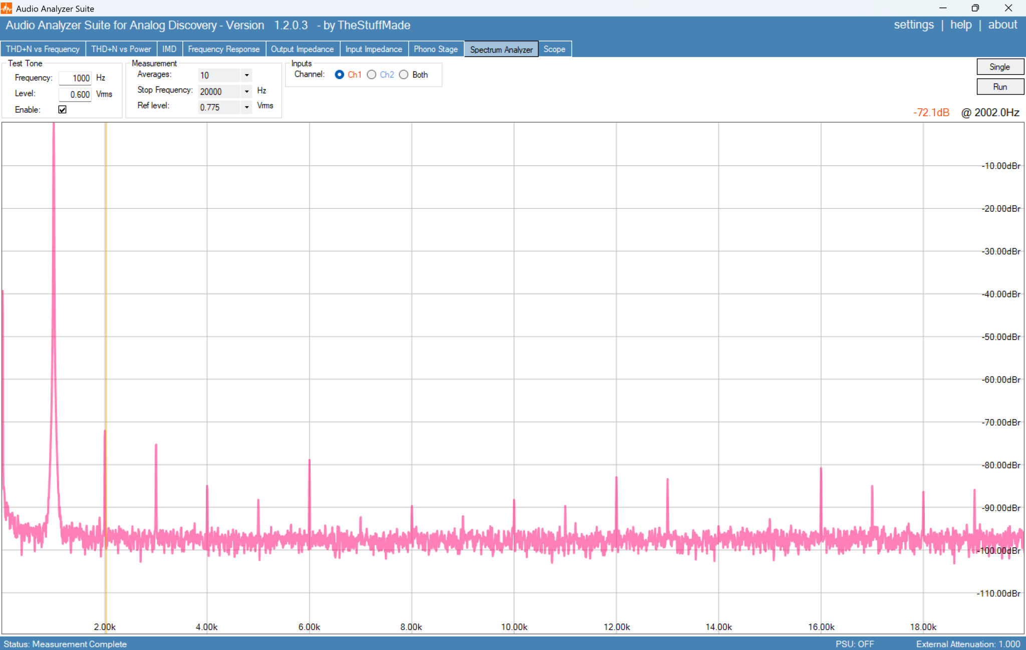

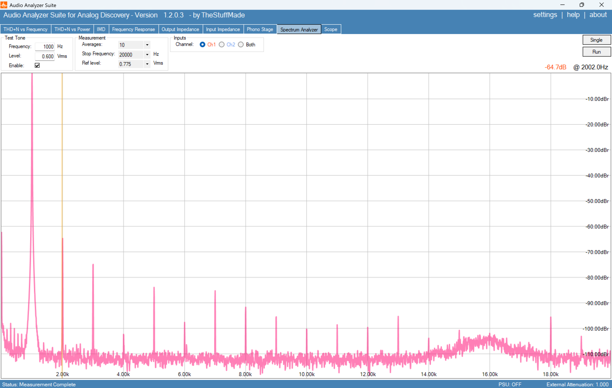

  • 1 kHz spectrum:
  • Spectrum and THD+N vs frequency agree on -72 dB for H2 (=2kHz) at 1kHz

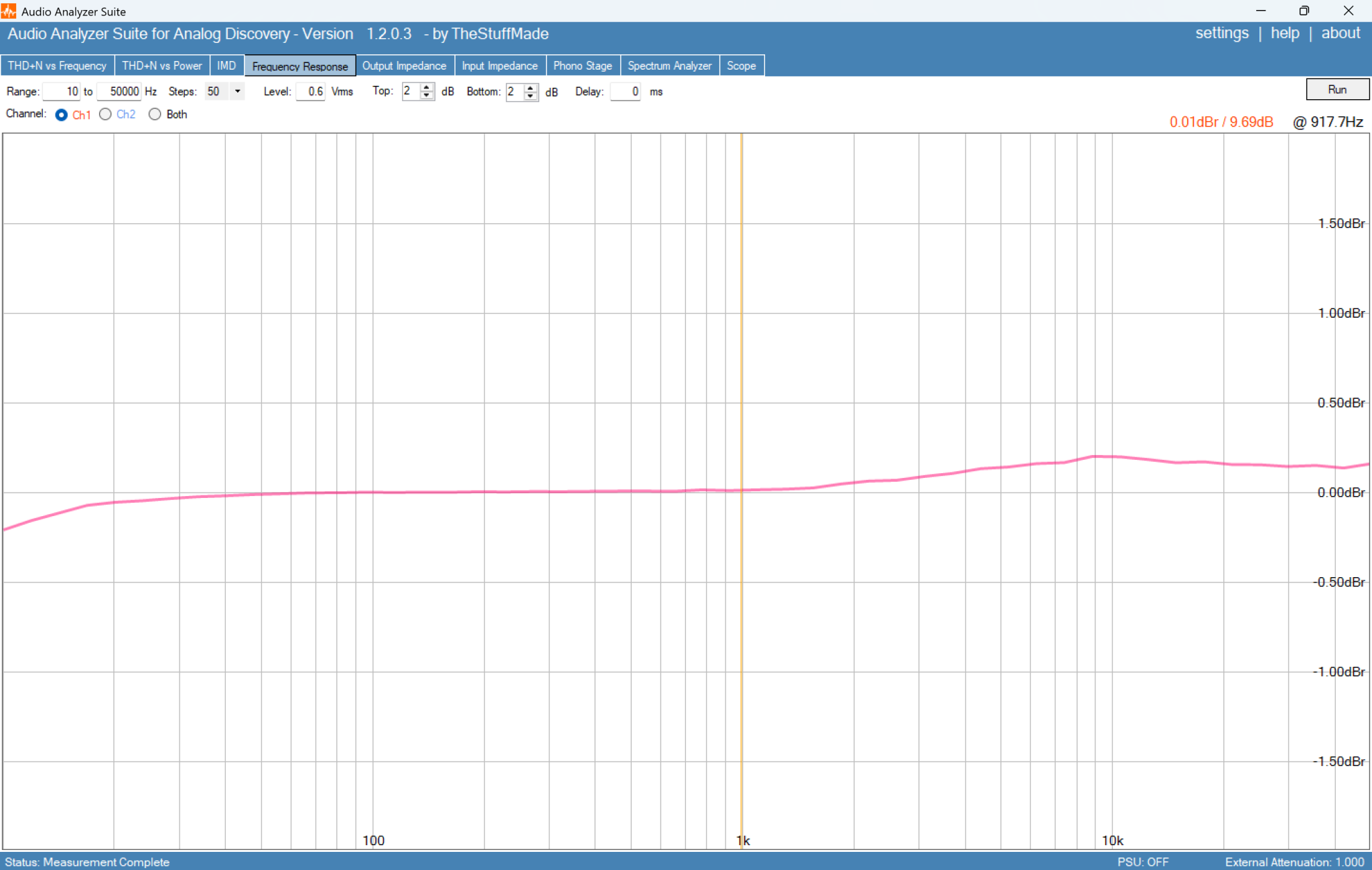

  • NE5532 preamp frequency response:

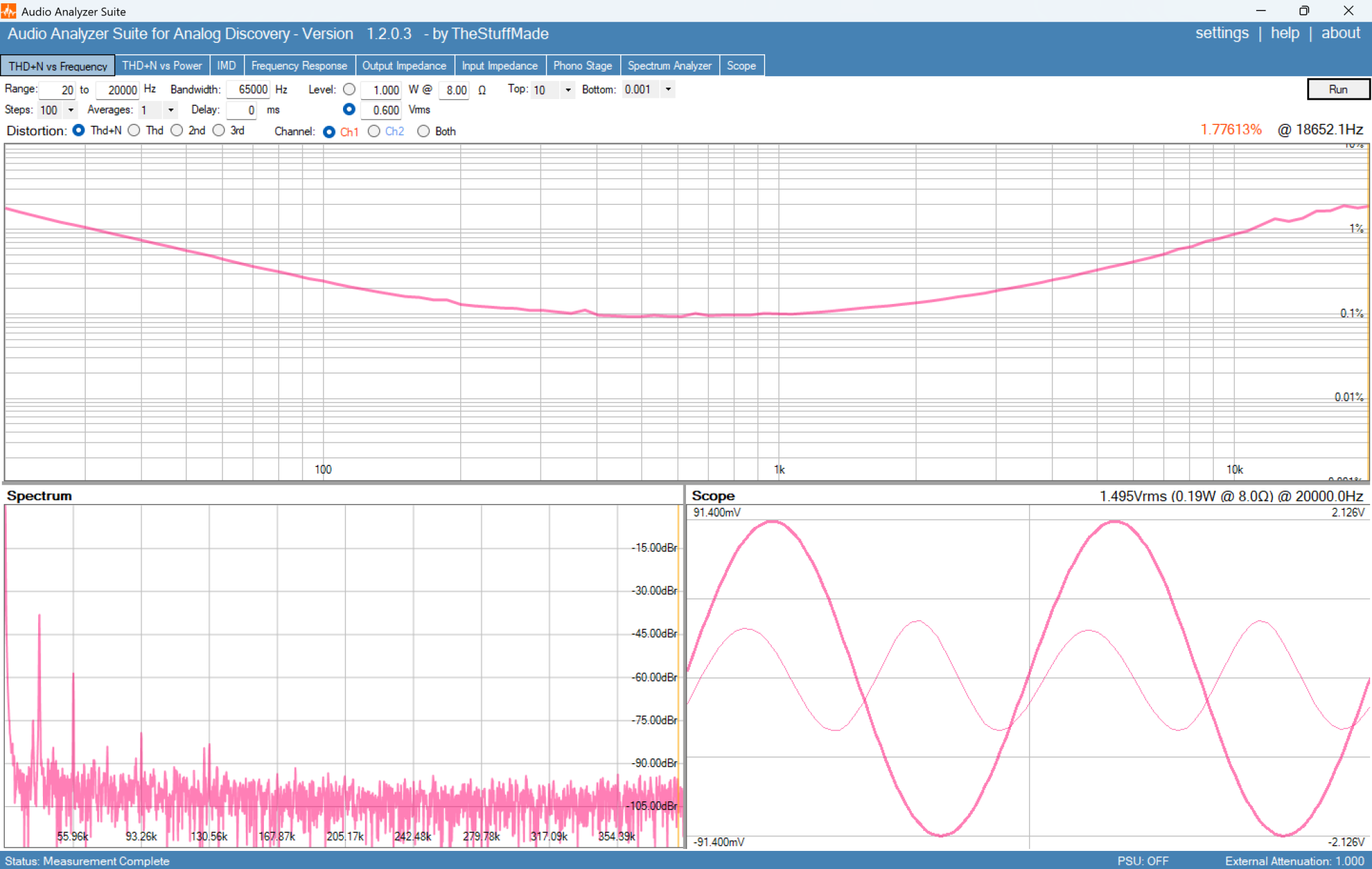

  • THD+N vs frequency at 600 mV input, output into 8 Ohm resistor:
    • Bias voltage reading up to 1.6V during sweep at low frequencies, 1.22V above few hundred Hz: 1%, mostly H3, at 30 Hz!
    • Gain: 0.6V RMS input, 1.5V RMS output = 0.19 W into 8 Ohm output: gain factor 2.5 = 8 dB
      • 20 Hz: 1.35 V RMS = 0.17 W
      • 100 Hz: 1.479 V RMS = 0.18 W
      • 1 kHz: 1.514 V RMS = 0.19 W
      • 10 kHz: 1.520 V RMS = 0.19 W

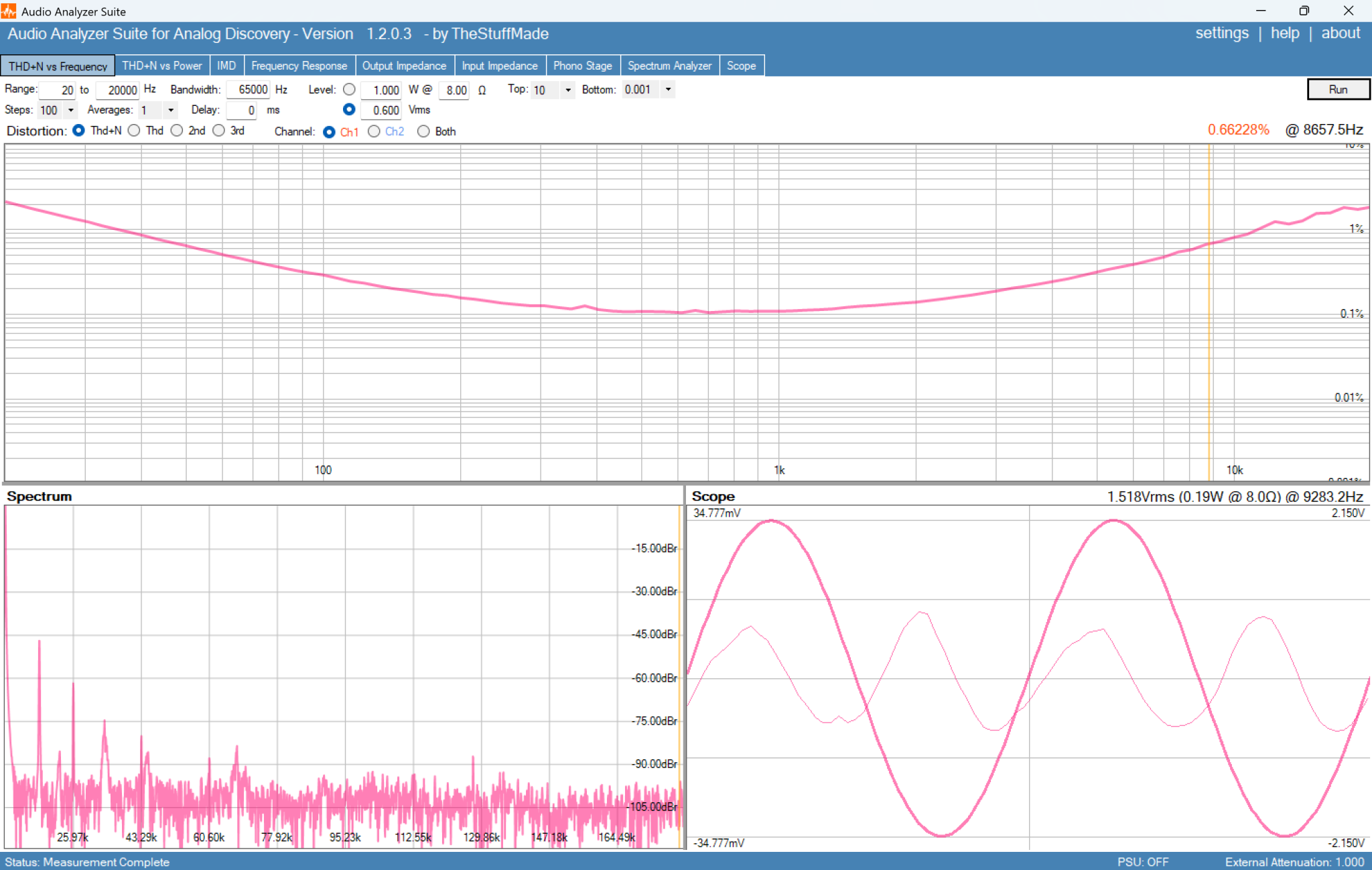

    • Left channel THD+N vs frequency 65kHz bandwidth 600 mV input:

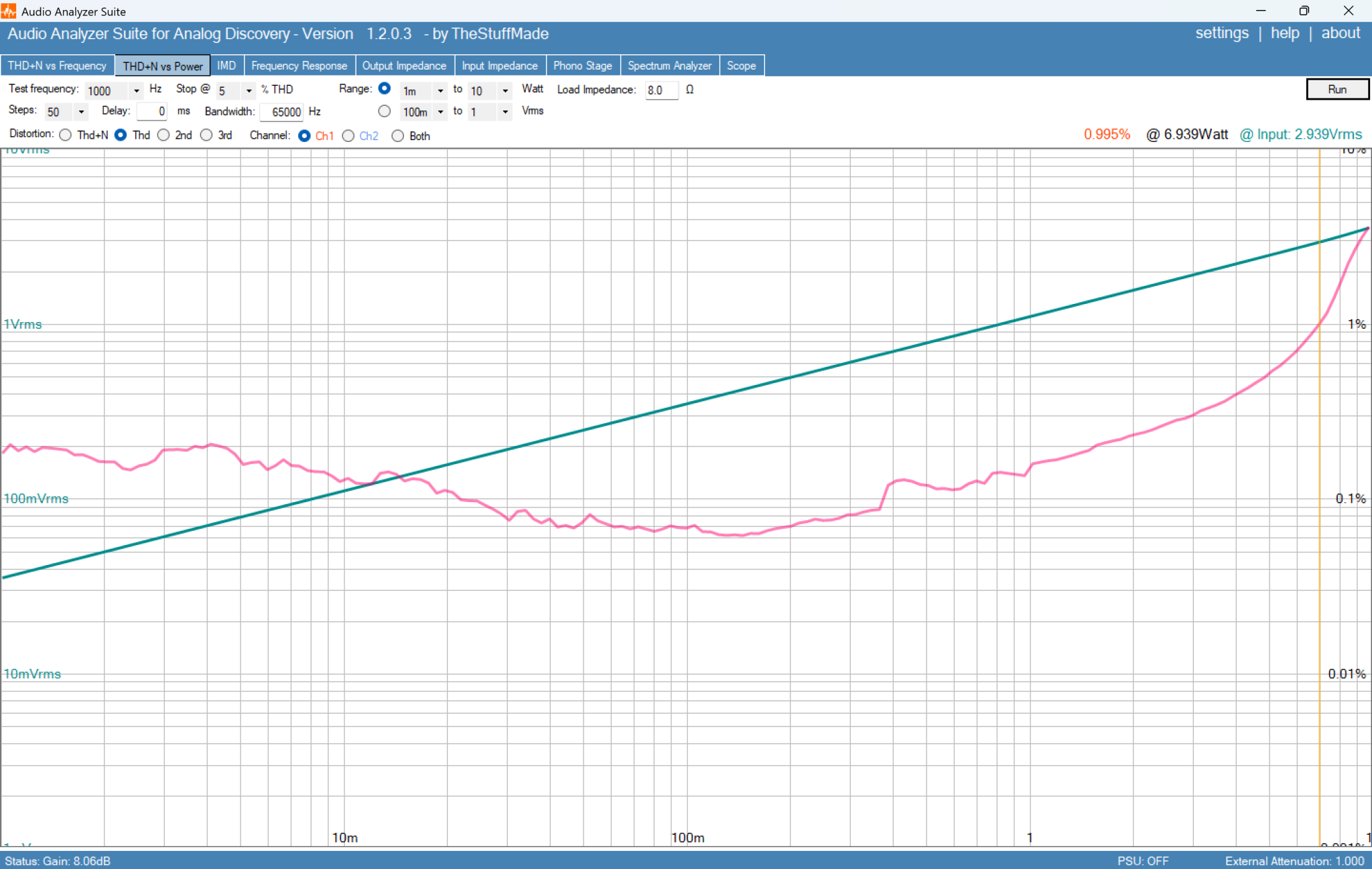

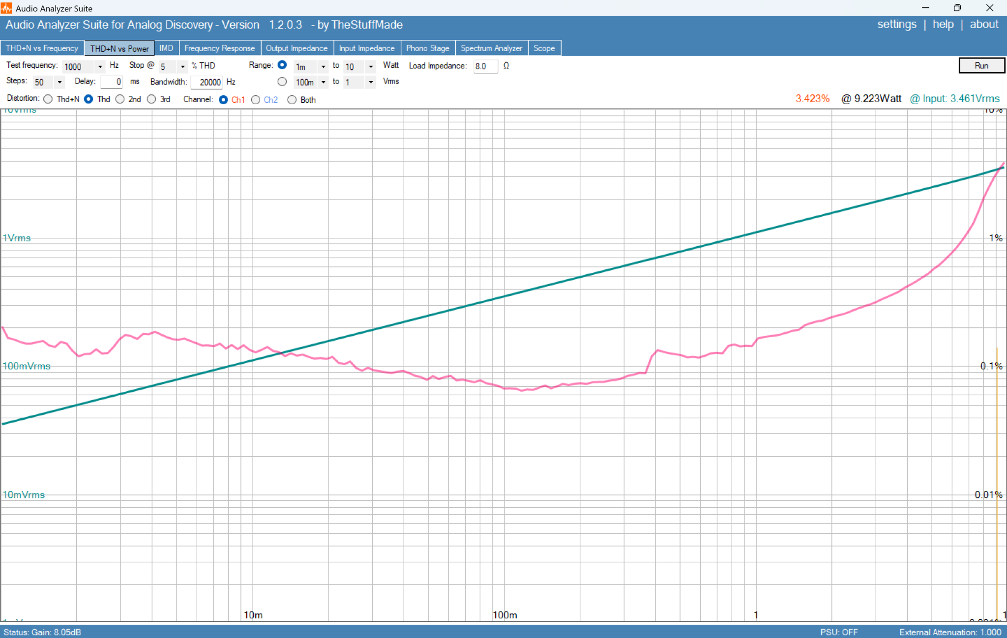

  • Left channel THD vs power into 8 Ohm, sweep from 1mW to 10 W: 3.4% at 10W, 1% at 7 W
65 kHz bandwidth makes no difference to 20kHz bandwidth ???

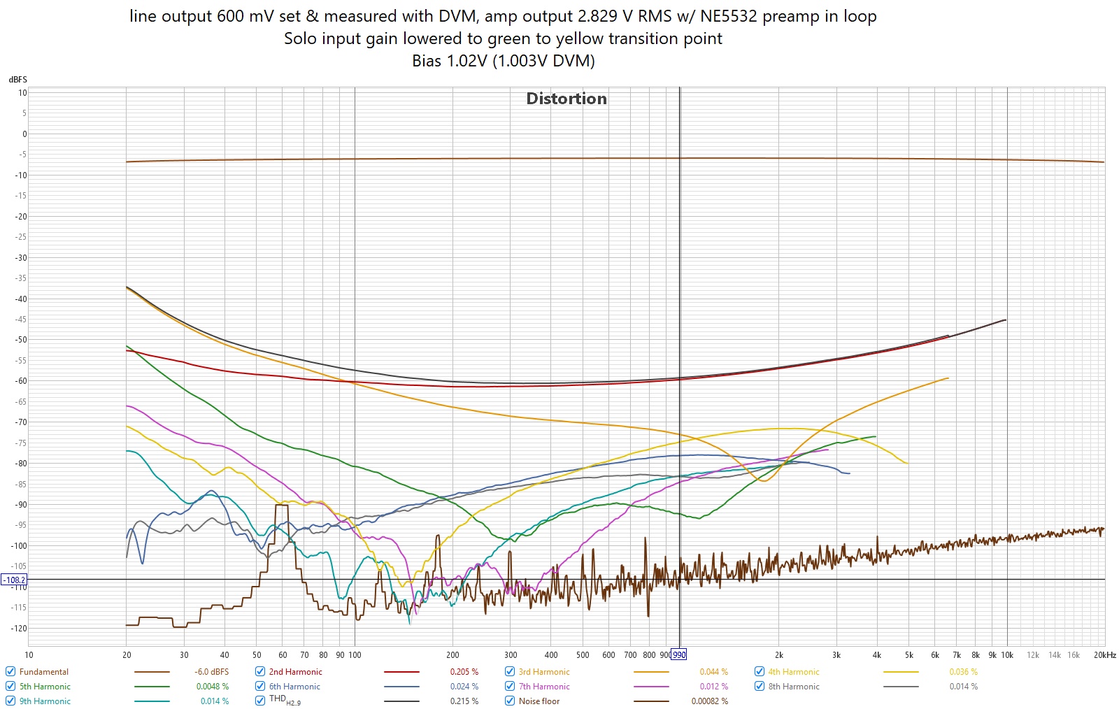

Interesting: I remeasured with the Focusrite Scarlett Solo and REW, and the noise and distortion numbers from the AD2 seem to be right. In particular, the minimum noise floor of the Zenductor 2 left channel at 1W output into 8 Ohm is -110 dB at 80 - 90 Hz. This is with the NE5532 in the loop. The right channel is worse, at -89 dB. Noise shows 60 Hz harmonics, more on right channel than on left.
This is the left channel:
As Nelson had described, at 8 Ohm varying the bias does not change the harmonics all that much; here is what I measure using REW, at bias values of 1.0 and 1.5V:

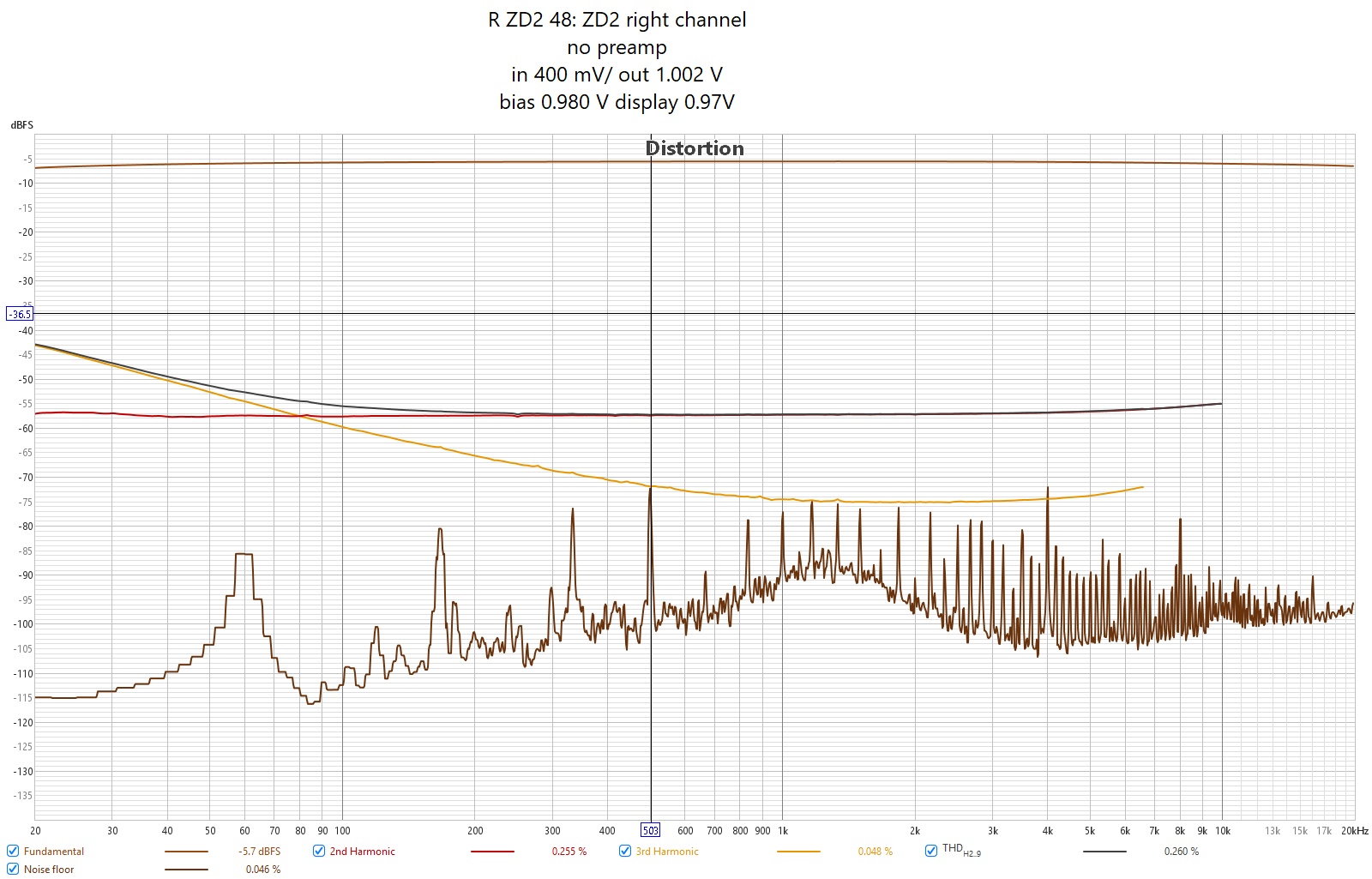

'Typical' measurement, here for the right channel at 1V bias and 0.25W into 4 Ohm:

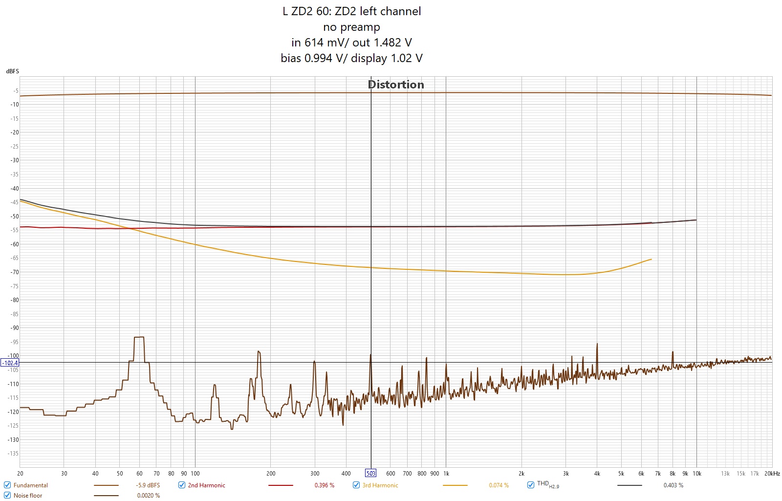

Last measurement, left channel at 1V bias with 0.5W into 4 Ohm:
