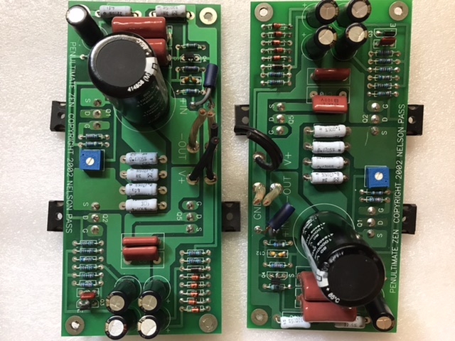

I have had a pair of Penultimate Zen boards for quite some time and and have never really tried them. They’ve been stuffed with premium parts and ready to be installed onto a heatsink to see if they still work.
I’m wondering if a DIYAudio standard issue ‘universal power supply’ including a 300va transformer with dual 18 volt secondaries would be sufficient to safely run these amps.
Do you have any experience with this version of Zen amp? If so, do you have any comments or advice?

Assuming you build it for 2A bias, I would go with dual 300VA transformers. If you wanted to go with a single transformer, a 500VA would be ok.

To be clear, I can’t take credit for populating the boards, I bought them second hand which were inside of a very scary build. I only salvaged the boards and scraped what was left.
I’m still wondering if the DIYAudio universal power supply is appropriate to use here...
2 picoDumbs, I read your post from 2016(although I don’t understand electronics very well) and now I’m more excited than ever.
On close examination I noticed one large cap has a slight bubble on the top of its case. I think I’ll start by replacing that 10,000uf cap and change out the other while I’m at it. I should ask before placing an order, are there any other components you would recommend I change?

Nice to see some real Zen v4 boards. The Zen amplifier is designed to use a capacitance multiplier on the positive power rail, and connect to ground as the negative rail. The output voltage of the cap mx is set by a string of Zener diodes, and is also adjusted dynamically when music is playing. The Zen v4 is somewhat unique in this aspect.
A transformer with dual 18V secondaries (connected in series) can be used to provide a raw, unregulated supply from about 47V to 50V, depending on the size of the transformer and the quiescent current that the output stage is configured for. Standard Iq will range from about 1.8A to 2.0A depending on the resistors selected for the current source.
The PSU boards from the store are normally configured for positive and negative supply rails. It is possible to split them apart to get a pair of positive supplies, but that would need to be done carefully by reversing the polarity of the bulk capacitors on the negative side. The chassis and heatsinks will need to be able to dissipate about 100W per channel.
The cap multiplier is on the amp pcb, so you won't need to add that, just in case that is worrying you.

Either 2 of these AS-3218 - 300VA 18V Transformer - AnTek Products Corp
Or one of these AN-5218 - 500VA 18V Transformer - AnTek Products Corp
Going with dual 300VA transformers would be better, they have a magnetic shield and an electrostatic screen. The 500VA transformer doesn't have these features.
