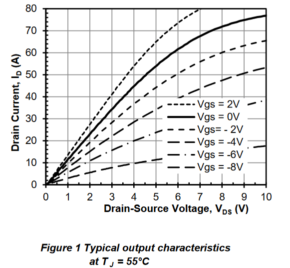

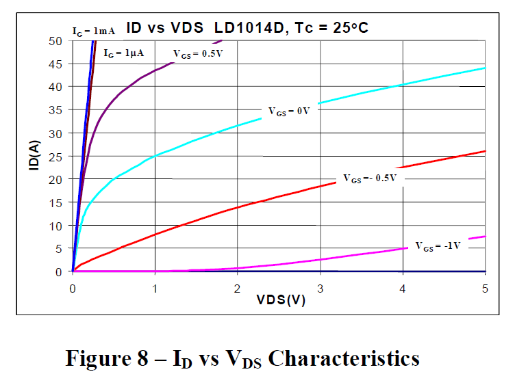

The shape of the characteristic curves are different. In the Zen v9 & F3 the LU1014D is operated at the point where the transfer characteristic shows concavity, is triode like, at a Vds of ~2.5V. I don't see any such operating point for the UJ3N065080K3S, it's pentode-like.
well, that's the fact
LU in F3 ........ one must observe entire arrangement
it is having triodish transfer characteristic helped with significant degeneration , and cascoded to keep low Uds
that graph above - it is for solo LU(LD) - for my venerable eyes, far from triodish
when not degenerated, LU is crazy part, having multiple xconductance of IRFP parts, shown and verified in LuDEF - minuscule THD of amp without NFB, exactly because of that fact
