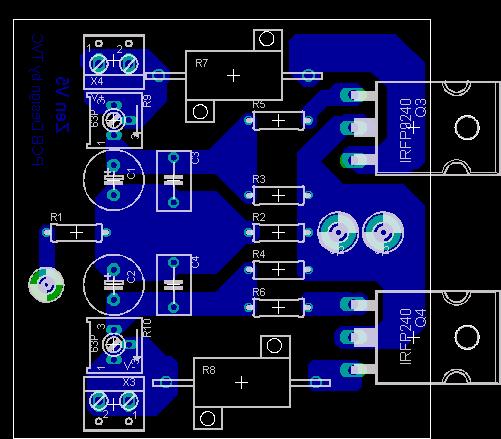

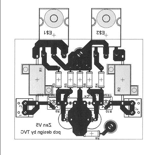

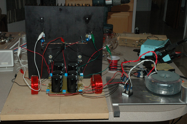

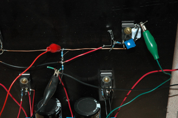

Wow, Ironic! I was just sitting around after work today, and within the last 2 hours I just threw one channel together, couldn't get it working right. My P3, P4 are 10k, I don't think its enough to bias it up properly. I believe you can raise the rails as you wish, but I would definitely add parallel devices as this design runs the fets pretty hard. As to how many you should add, I'm not quite sure. What voltages for the rails are you aiming for?
