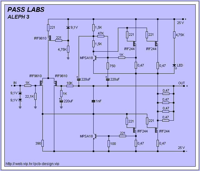

I am planning on building the Zen v4, but with a twist - want to parallel active devices (FETs), especially Q5. What I am not sure at is how to implement the gate resistors ( one for each FET) and the modulating circuit (R25 / C11).
If I include stoppers (R23a and R23b respectively) and then connect R25/C11 between the gate resistors and the gates of the FETs, I'll be literally halving the value of the gate resistors and turning them into one common stopper, therefore the FETs won't have their own gate resistors any more.
Do you think that this is a problem and have you got any suggestions.

You might be right, but I thought that C11 must be between the gate of the FET and the gate resistor (R18) for the modulation to work.
And I'd rather keep the modulating part of the reg because of the extra output power available.
Stan
You can either make R18 smaller (say 100-200 ohm), or you can make R19 smaller (by the amount of R18, say 5,3Kohm if R18=1500 ohm). Then you will have the same amount of feedback to modulate it. This is what I think, it would be nice if someone else could comment on this.

OK,
My plan then is as follows:
I'll build an Aleph30 with a small modification.
Will use IRFZ40 - 4 for the CS and 4 for the output stage, keeping the same bias - 0.53 A per leg (as per Aleph30 service manual). This will bring the total bias at 2.12 A, same as the original Aleph3, and maybe adjust the 750 ohm resistor accordingly.
What do you think?
Kind Regards
Stan
