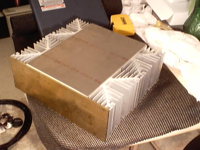

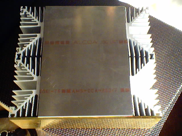

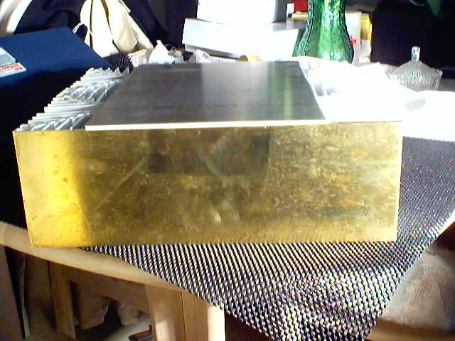

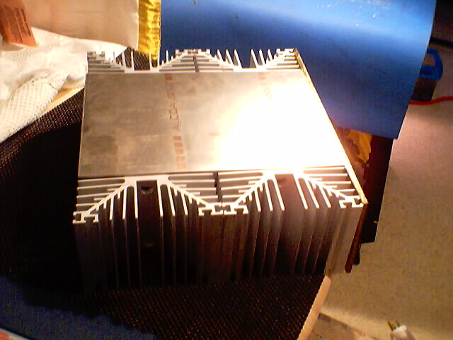

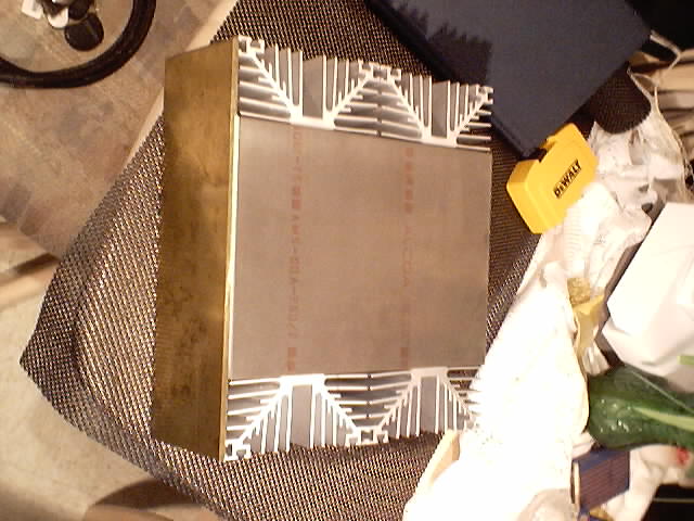

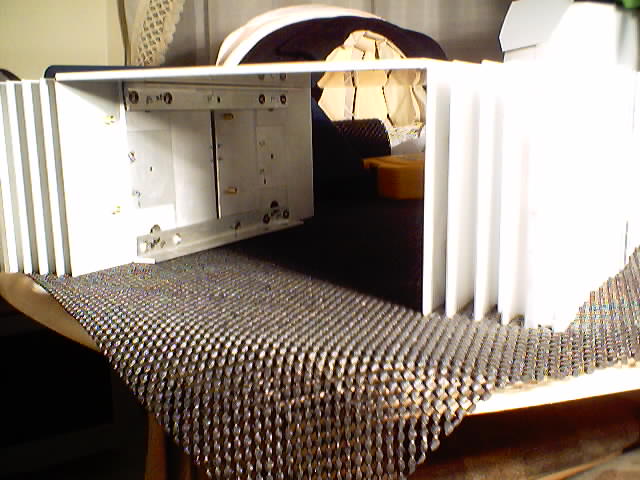

Updating my Zen
Hi guys, here is an update how is going to look my chassis. This the bottom side.
