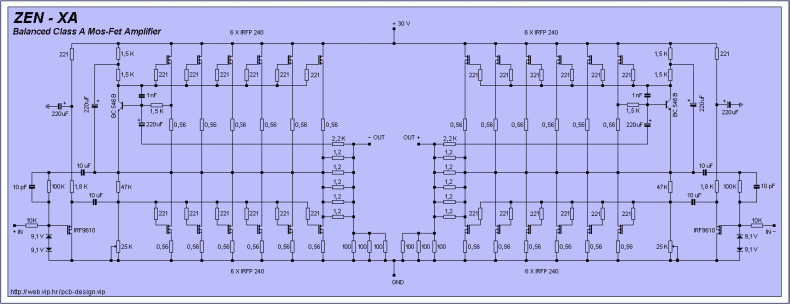

Zen V4 audio quality
My first reaction was the same as Panelhead's.
You do need a preamp with low output impedance in place of your pot.
Try a very simple project like Bride of Zen and your problem will be gone.
If you still have problems check the PSU caps for leakage. That also is detrimental to sound.
So your problem is not enough / loud enough? bass? what about testing the Zens sound with larger speakers?
Do you have a soundcard and micophone? could you measure both of your amps through your speakers and post drawings of SPL over frequency?
I feel it is not possible with any amp in the world to get serios bass through small speakers.
Let’s face it. Size does matter.

Normal bias? Is that 1.3 or 2 amps? How hot are your heatsinks? I think if both resistors are 0.47 ohms the amp will draw 2.8 amps. The pre-amp will also make a difference. This is the fun part of DIY. Good luck, Mike.😎
I don't know if the power supply capacitor or good !!! Do you think it is good to change my two Mallory 37 000uf by two Elna 10 000uf ????
This will make a good modification in the audio quality of the power amplifier ???
The bias is 2 A and after 3 hour of music, the heatsink are very hot... you thick it is better to use more bias??? like 2.8A ???
Like somebody may have said before ZEN is not for everyone. I’m familiar with several Vifa mid-woofers (and have tried many crossovers) and they are hopeless to ZEN damping capability. Whatever it is, damping factor doesn’t only affect the bass. With Vifa mid-woofers, you can’t expect a hi-fi system with the Zen unless you have a very good line stage. My recommendation is to workout the CDP. Bottlenecks are usually found in the speaker and CDP, not in amplifiers component.
<i>Peter: "Zen sounds much better with a matching preamp. When I connected it directly to the DAC's output (even without a pot) it didn't sound as good as through the preamp. It is a nice sounding amp, definitely."</i>
Peter, I have a different approach. I think a CDP output gain is enough even for such amplifier (Well, of course, the original Zen requires more output swing from the line stage). If it doesn't sound right, then I will make it right. My BOZ is a lot better than anyone's BOZs I have ever compared, still it doesn't qualify to sit between my CDP and Aleph. Yes, I need an extra gain stage, but the added distortion and the problem with some high frequencies in several song with the BOZ (or simply the MOSFET) do not worth the extra detail/gain. I'm in search of a better pre-amp and experimenting with Mullards CV4024s and 12AX7.
