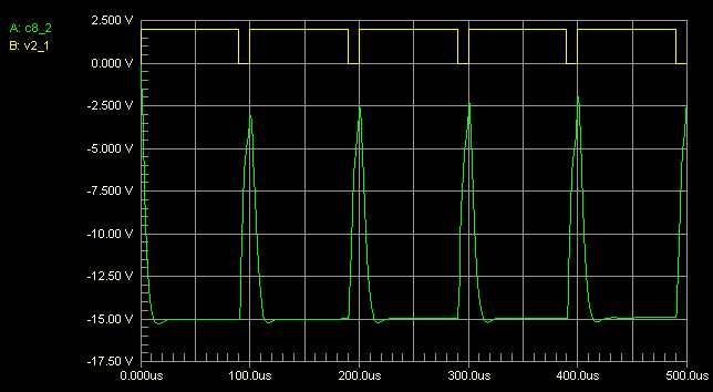

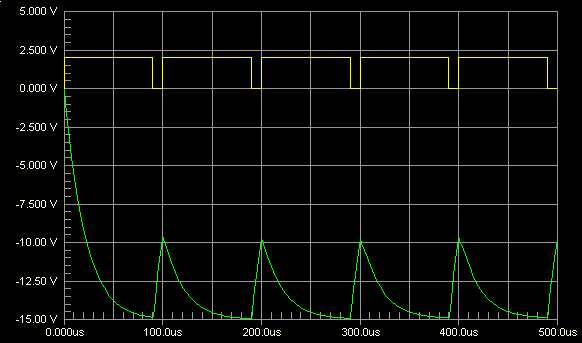

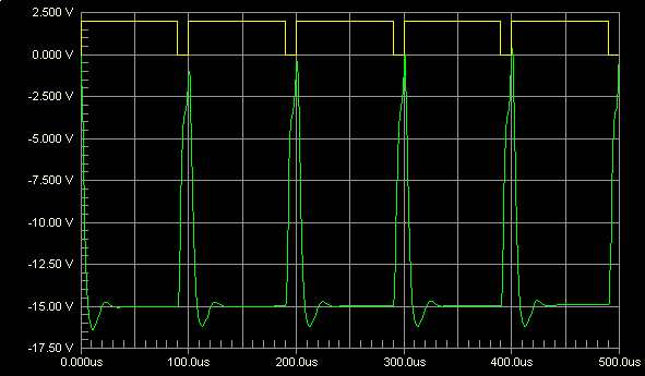

I made some simulations with 10kHz square waves and C values of 1pF 10pF and 100pF, it becoms very clear that you need this C. The right value will be somewhere between 4 and 10 pF. I think your C ist to big.
Here the waves for 1pF
Daniel
Daniel
