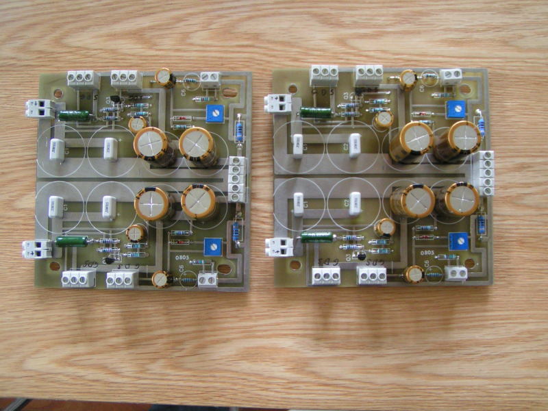

ok so i just finished my first zen amp. i biased it at 3 amps using the .22ohm resistor for r1 i also used a 30v secondary power supply with the goal of using a choke and cap. i was lead to believe after reading online that the choke would add resistance to the voltage and would reduce the input voltage back down to 34v but for some reason when i powered this puppy up i was getting 42-43v @1.4 times the rated ac secondary voltage. was there something i am missing here? so of course i assumed everything was good to go originally so i expected all to work when powered up but nothing happened. nothing got warm. nothing popped or smoked. i found power after r1 to be equal to the input power where mr. pass says i should see .66 volts. i have zero volts at the drains of the mosfets. i am so lost right now. any help would be greatly appreciated as i am tired of reading how awsome this amp will sound and want so bad to here mr. pass's creation.
note the picture is before i added the main power feed, i used a 6 amp fuse which does not blow obviously because there is no draw........?
Zero volts on the source resistors means no current is flowing. Zero volts on the drain means there's no power on the board.
Make sure you have all components wired correctly.
Go around with a voltmeter and make sure power is getting to the board. Do you have volts on both sides of the filter chokes?
This has got to be a very simple mistake. Just take some time and go through with a clear head - you will find your mistake.
The reason you power supply is so high is that there is no load so the caps are charging up to the peak voltage (=1.414 X rms (rated) voltage) when you start drawing your 2x3A the rail will drop.

after checking i have found that i do have power to the board. i checked power between r1 and negative at the rectifier and it shows 42-43v.
both channels are acting exactly the same way.
i also have power at the outs of the chokes.
the mosfets are wired correctly per manufacturer's diagram which is why i had to remotely wire them to correct the piouts.
thanks guys for the help! please if you have any other ideas let me know.

Clearly with 40+ volts on the Drains Q1 is not conducting any current. What
is the Gate to ground DC voltage on Q1?
ok the gate at Q1 on both channels shows zero volts when the negative probe is on the negative out of the choke and /or the negative out of the bridge rectifier. there are 0 ohms between ground and the gates of Q1 on both channels. if i put the negative probe on the gate/s and positive probe to positive out of the choke i read @43v--- rated power in

Yes, that's what I'm getting at. If you look at the schematic, you'll see that it's the source of Q2 that's connected to R1.
The pinout of IRFP140 and IRFP240 are the same.

holy crap i think i flipped all the fets the wrong way. mr pass if you could take a close look at the pic i posted i flipped the gates and sources of all fets. was that a mistake? i thought i would need to because of the direction i mounted the mosfets

wow thanks for the help guys. im going to flip these fets and see what happens.
