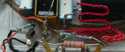

Hi. I'm building a BOZ/Zen4 amp. With the BOZ I had no problems finding parts, but for a Zen I can't find ZVP3310 (I can get IRF9610, but think BS250 is better for its Ciss=30pF). So I will try with a BS250, but I first want to hear from you guys what do you think about both of them, and do you have to change something in the circuit for BS250 to work well. If you must change things, could you specify what to change, with specific part names and values. Thank you in advance.
At the end the only change was BS250 in place of ZVP3310, VDS will be around 2.5V instead of 4V. I tried also BSS92, IRF9610 and IRF9520, but BS250 sounded better. I am listening to this amp now for 6 months and I am very happy with the sound.
