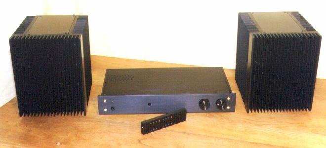

I'm afraid you are right, Jam.😉 Combining wood and aluminum creates always pleasing impression, and the engraving adds a final touch. I might be tempted to place the LED on top though, instead of in between the fins.😎

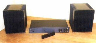

Really nice looking Zen !! Congratulations ! What kind of wood did you use ? Did you order the engraved plates or did you make them ?
Don't know why your LEDs don't work ... I have Zen monoblocks since 4 or 5 years now, with Power On leds between the fins of the front heatsinks, and they keep glowing strong despite the heat... Here are the beasts (along with my old BoZ). Notice the wood is underneath 😀
Hi François,
Its european cherry
I am not a great metal worker like harry Potter or you or all the others. So i had to found someone who will make it for me 😀
The lettering and all plates were made with a CNC machine you can find more information at:
http://www.schaeffer-apparatebau.de/index.htm
Your zen is very nice, but why did you use 3 Heatsinks? Ok, i see it looks very cool, but.. 😉
Reinhard

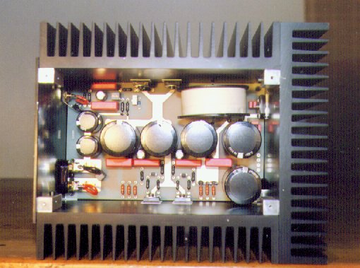

Reinhard,
In fact, each monoblock contains a double Zen... Two paralelled current sources and two gain mosfets, biased @ 2 Amps each... I also increased the supply voltage a little bit. Thus dissipation has also increased 🙂 And you must heatsink the rectifier bridge too... So, three heatsinks is the minimum in my case (pun time). It's not to look cool, but to look hot 😀
