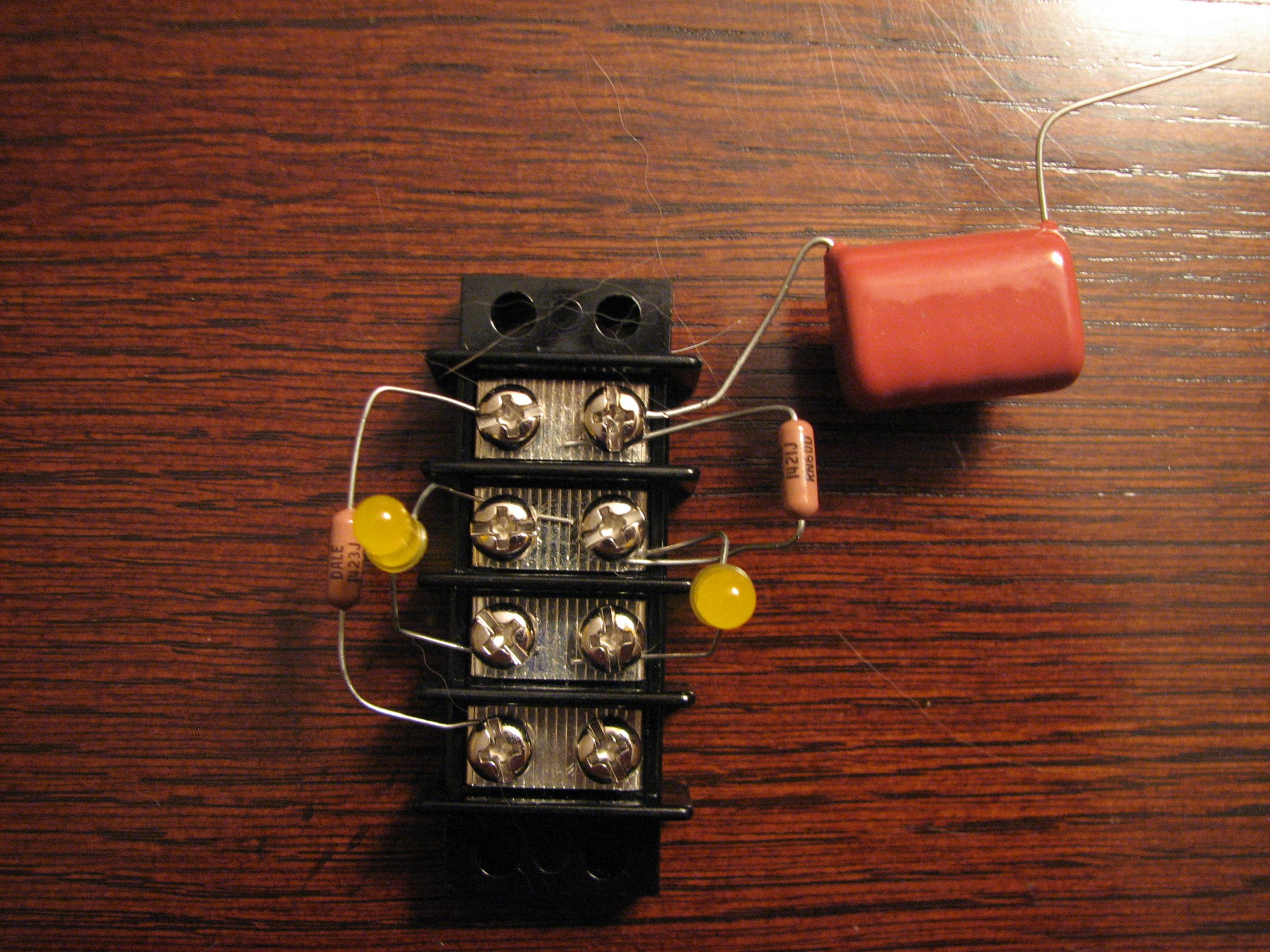

Zen Mod, I built the oscillation detector, question:
Joined 2003
Ok, how do I use this thingy?
thanks for the schematic, (Still need to add wire at bottom...

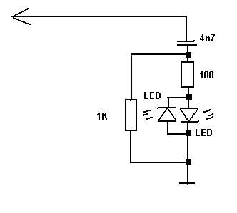

if you take calculation :
F=1/(2 x Pi x R x C) , where R=1K and C=4n7 , you'll figure that anything is going to happen starting from 34KHz and upwards
so ,put some signal in amp, just crank it and see is it lit
though , friend with a scope is much more useful and precise 😉

Alas, no scope. Have friend with one, hes a tube guy, sure he could measure for instabiliy I suppose. I only have test tones on cd, I will string this device between speaker outputs, put some tones through it and see what happens.
A couple of stupid questions :
If someone has a bad oscillation with full swing (say +/-15V), will the LEDs survive the 130mA peak current ?
If they do not, depends on whether they die with a bang or silently, no light => no oscillation, all is well ?

I sort of figured if they lit up, there was a problem, if not, who knows...for sure anyway. Interesting device, appears to measure temp as well. For the price, one can always use another multi-meter. Whoops, this particular model seems to NOT have temp, but that's not point of interest here anyway.
Looking at manual, set for the up to 40 kHz I presume, hook up to outputs for speakers and just measure? I suppose a signal needs injected? I think I have some old tube signal generators around here somewhere, guess its time for a good one...need seems to pop up again and again.

Russel , just feed amp with music or whatever you have on test CD ;
Patrick - this circ is collected from net , as handy tool
of course that it is just a crutch , comparing to scope and some mileage of operator
so -if it is lit up , you're in trouble
if it is not lit up , and you're having problems with amp , you're in trouble
in both cases - you need help from someone who's having more mileage
